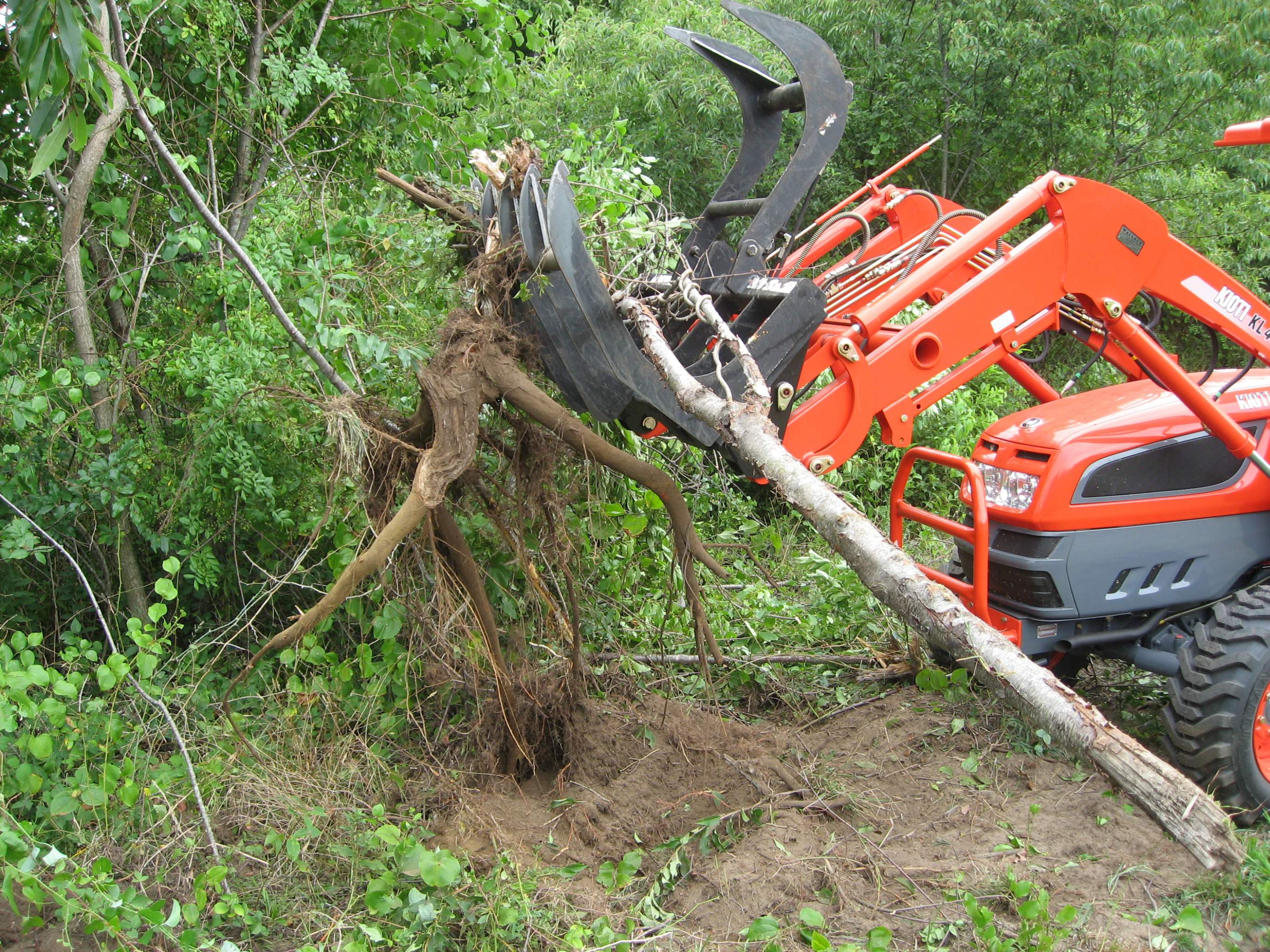

Question for Island Tractor, in an earlier post you said that your grapple tines curve up more than other brands, do you feel that is a benefit because the tines of your grapple and the Wildkat grapple I am looking at are almost identical. Does the curved shape allow you to curl objects out of the ground better? Does it keep you from getting under brush and logs? The grapple I am getting closer to getting is the light weight Wildkat with single grapple, going with the 66" wide version because most of what I will be doing is cleaning up brush. Tractor is a kubota 5740. Thanks.
   / Which type of grapple is best suited for... #120
I think the curved tines help. They keep roots from sliding off when lifting/curling to break them. Think about how you use your own hand when lifting or pulling on something, you curve your fingers rather than keep them straight. Same idea. I haven't got experience with straight tines but I use the curve in mine so often that I cannot figure out why all grapples aren't made that way. The only thing I can think of is that before CNC cutting it was easier to manufacture straight tines but today manufacturers presumably put a sheet of 3/8" steel in a CNC cutter and they could cut the tines to any shape they want. I noticed yesterday that that WRLong OBG2 gives you an option of either straight or curved tips to the tines. I'd like to know if there are tasks that are better done with straight tines but I've never wished mine were straight.
