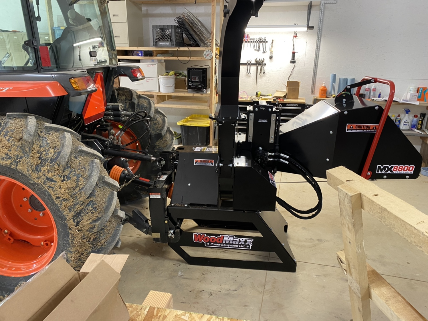

We take delivery on a 2021 Kioti DK5310HST this week. One of the first uses for this tractor is going to be cleaning up and thinning about 20 acres of mixed forest...ponderosa pine, white pine, white fir, doug fir, etc. We had it selectively logged last summer and there is a ton of broken limbs and branches left by the logging crew. Add to this about a dozen blow-downs this past winter and several acres of overgrown ponderosa that needs to be thinned. Our burning season is limited and we are on a hilltop so wind is also a factor. So we are looking at a chipper.
I like the Wallenstein models, but they are a bit more than we can afford right now. WoodMaxx looks to have some great models and I've seen where many on TBN like them. Question is, "Do we go with the WM-8H or the MX-8800 for about $500 more. The MX includes the upgraded PTO shaft and has the hydrostatic drive. Those and a few other features seem to be the main differences between these two models.
The tractor is a 50hp with 39hp at the PTO. Which chipper would you recommend and why?

I have the MX 8800. It has about 25 hours on it with zero issues. I'm very happy with it.

Thanks for sharing your experiences, everyone. Much appreciated. I'm on the "notify when in stock" list for an MX-8800. They haven't provided any indication of when they expect to be shipping these again. I have a Wicked 60 Grapple on order with Everything Attachments and I was just notified yesterday that I'm 75th in line (out of over 200 orders) and my grapple is expected to ship in about 4 weeks.
The good news is I'm expecting delivery of our new DK tomorrow!!!(y)
