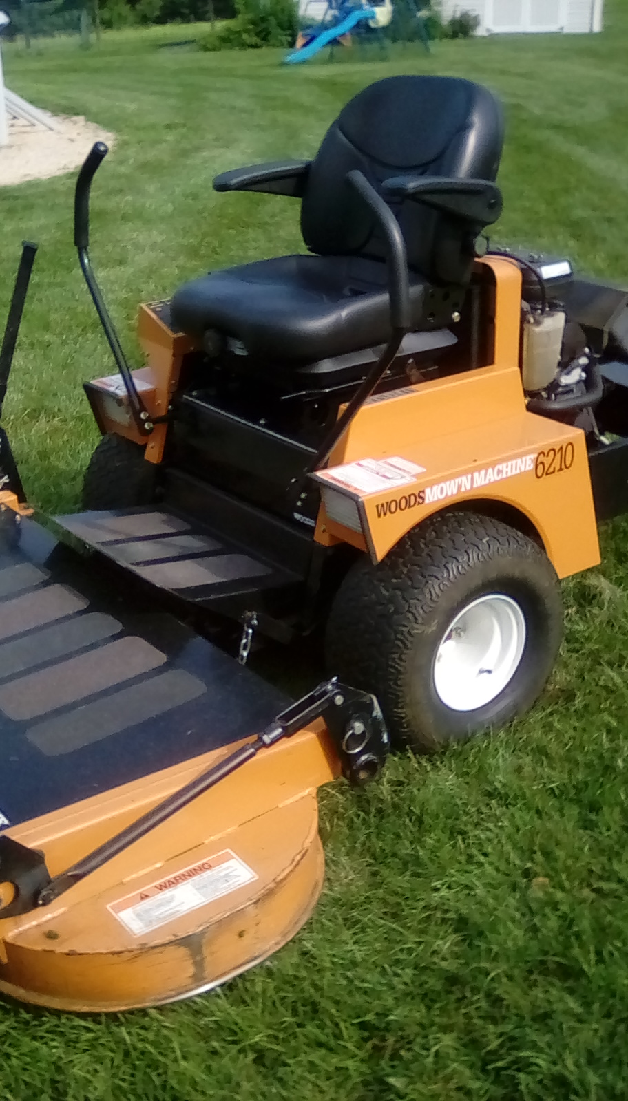

I have using this IMG_20170804_164619.jpg for 20 years. 900 hours. But I said for many years you can't beat a steering wheel. You will cut your mowing time alot. They do ride rougher than than a tractor. Good seat is a must. Can't comment on which to buy.

Sawyer, the picture I posted above is a grasshopper in disguise and my ***** and back would tell you differently. :laughing:
