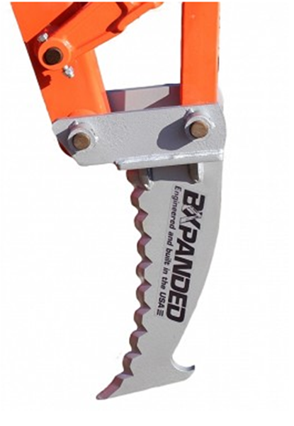

With that ripper claw from BXPANDED, wouldn't you end up needing to swap from claw to bucket? Your not actually removing any material with that thing, your turning the backhoe into a razor knife with it. I assume you jam the knife in, slice and dice real nice and then go to the bucket to remove the debris. Then go back to that knife and start over, but going another layer deeper?
You also need to get the quick attach, so that you can swap back-and-forth between the bucket and the ripper tooth in a few seconds.

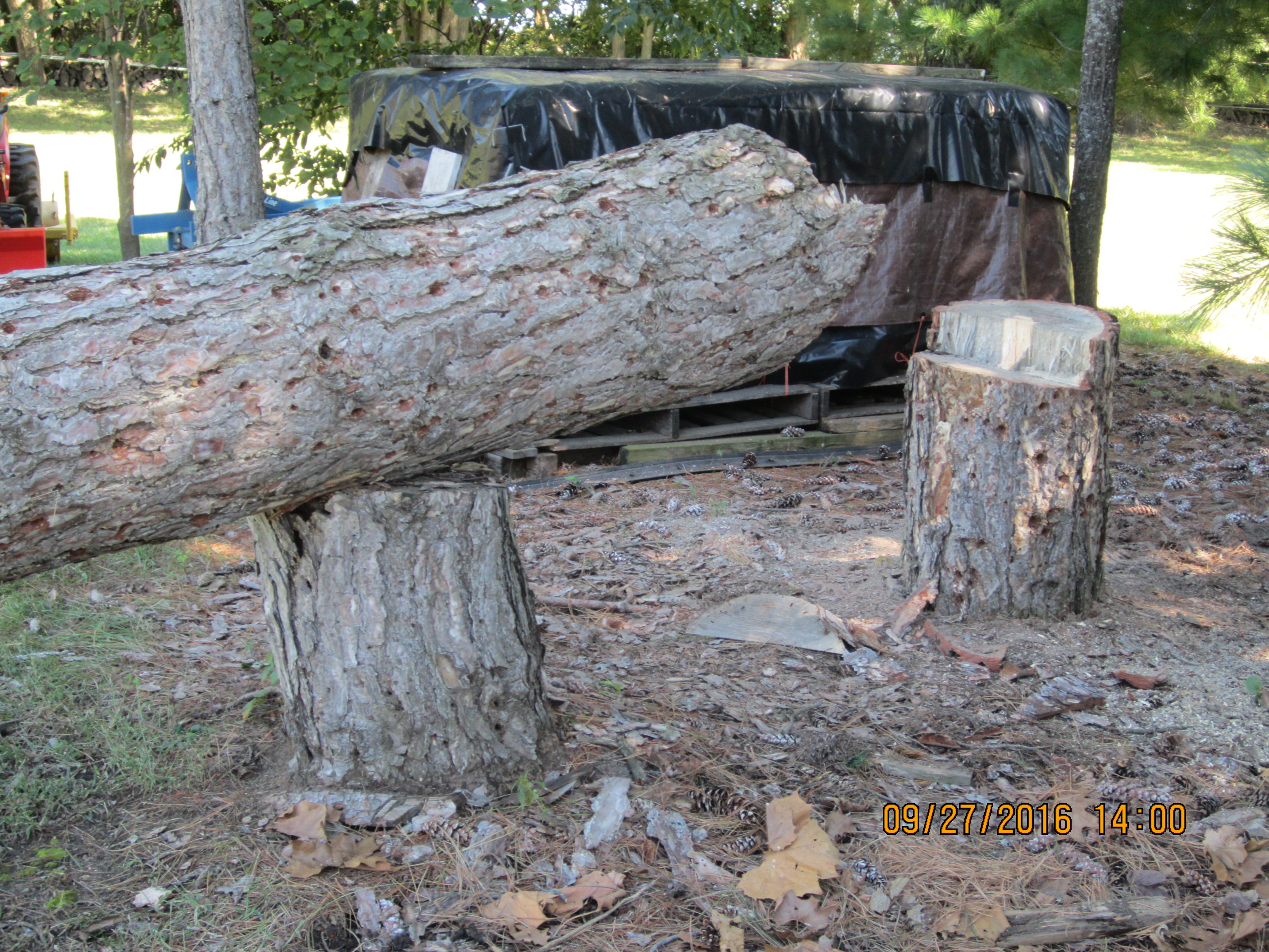

Don't just start digging at the base of the stump, you'll get nowhere. Start about 5 feet back and work around and into the stump. Remove dirt and cut the roots as you move in.
I do it all the time at my cabin with pine. It makes a giant hole, but it's easier and faster in the long run. This works even better if the neighbor fills the hole.
That's the way I do it !! Pine tree roots are a pain. I try to do it when the ground is wet...comes out easier....

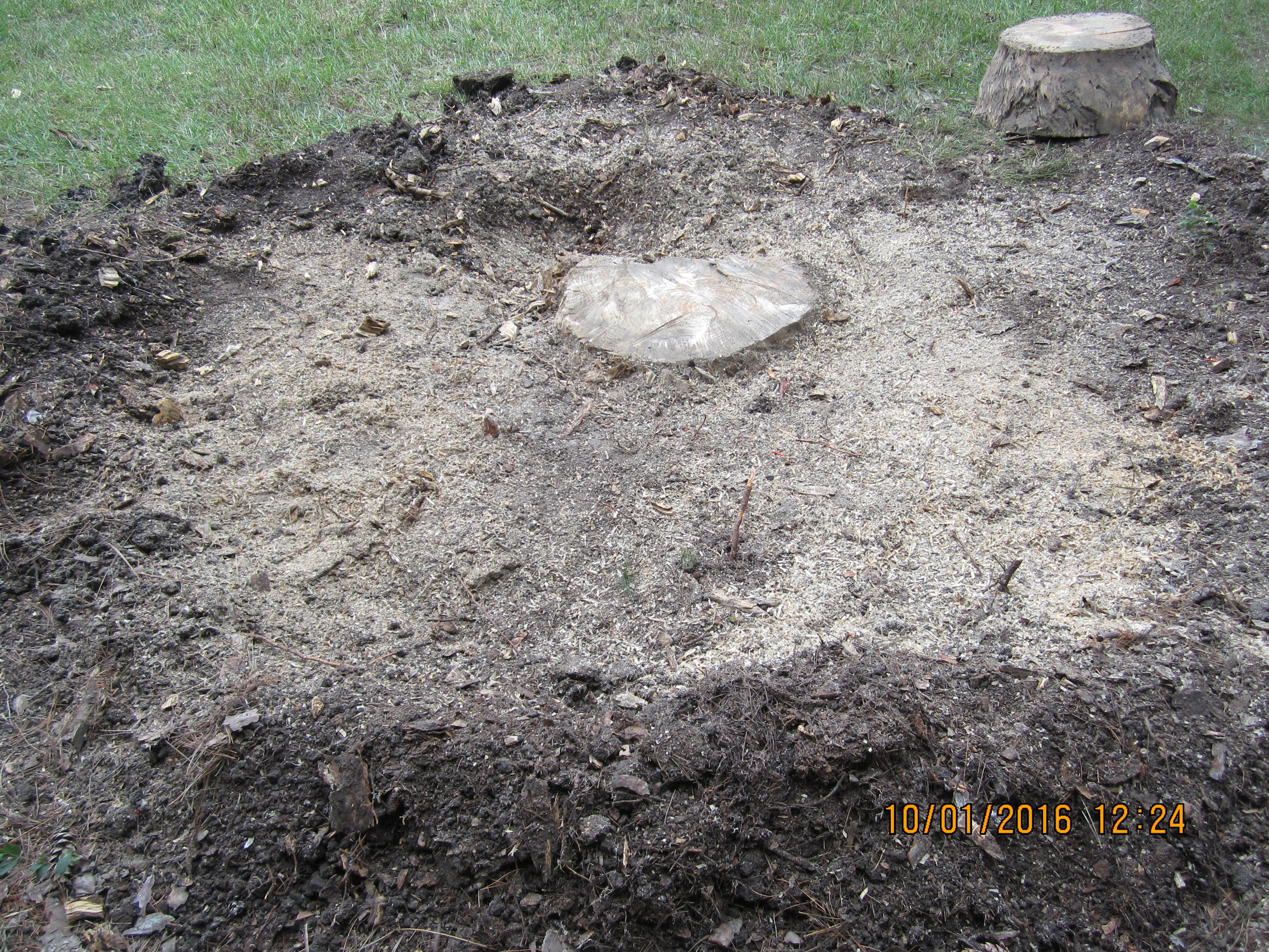

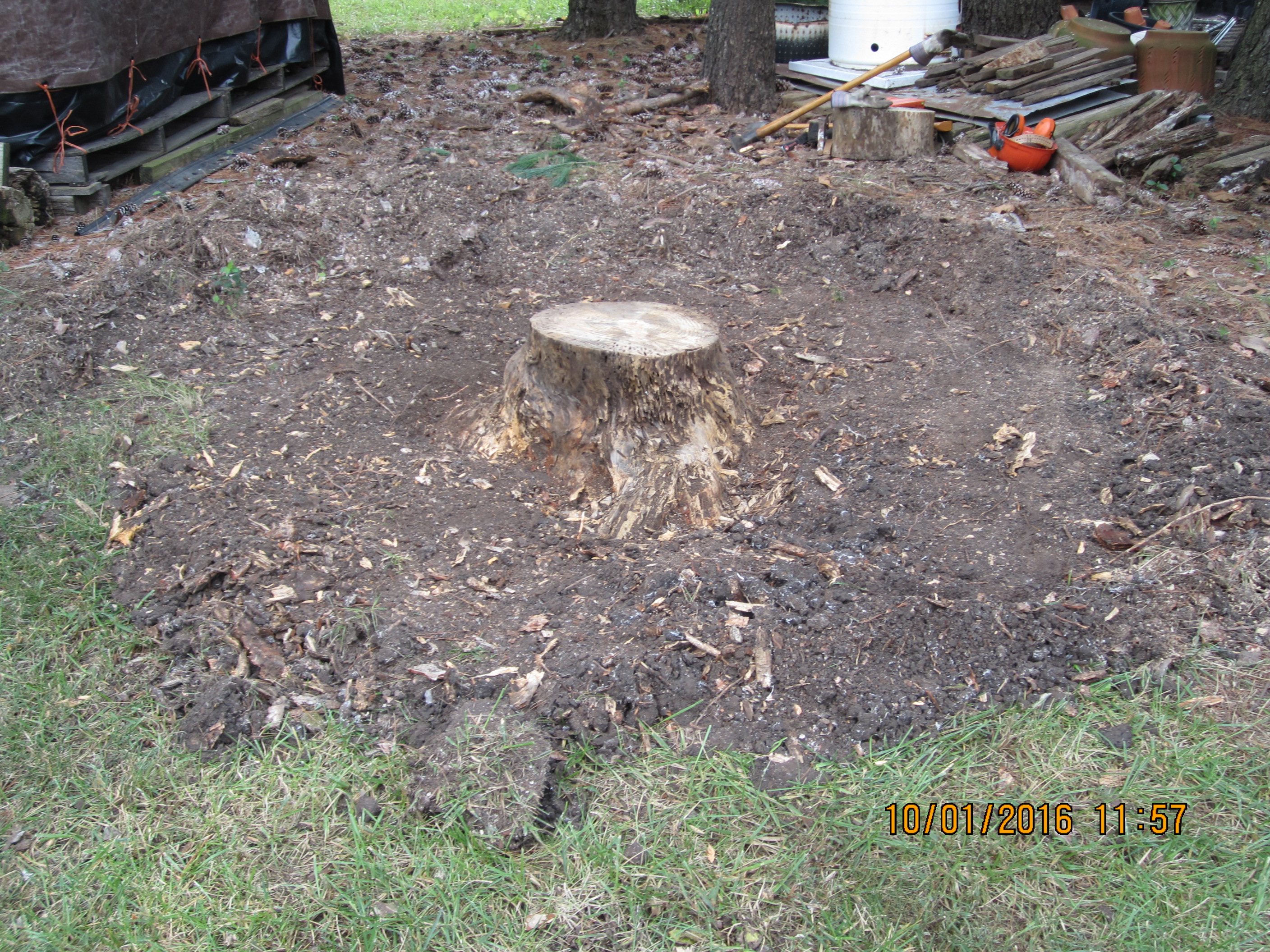

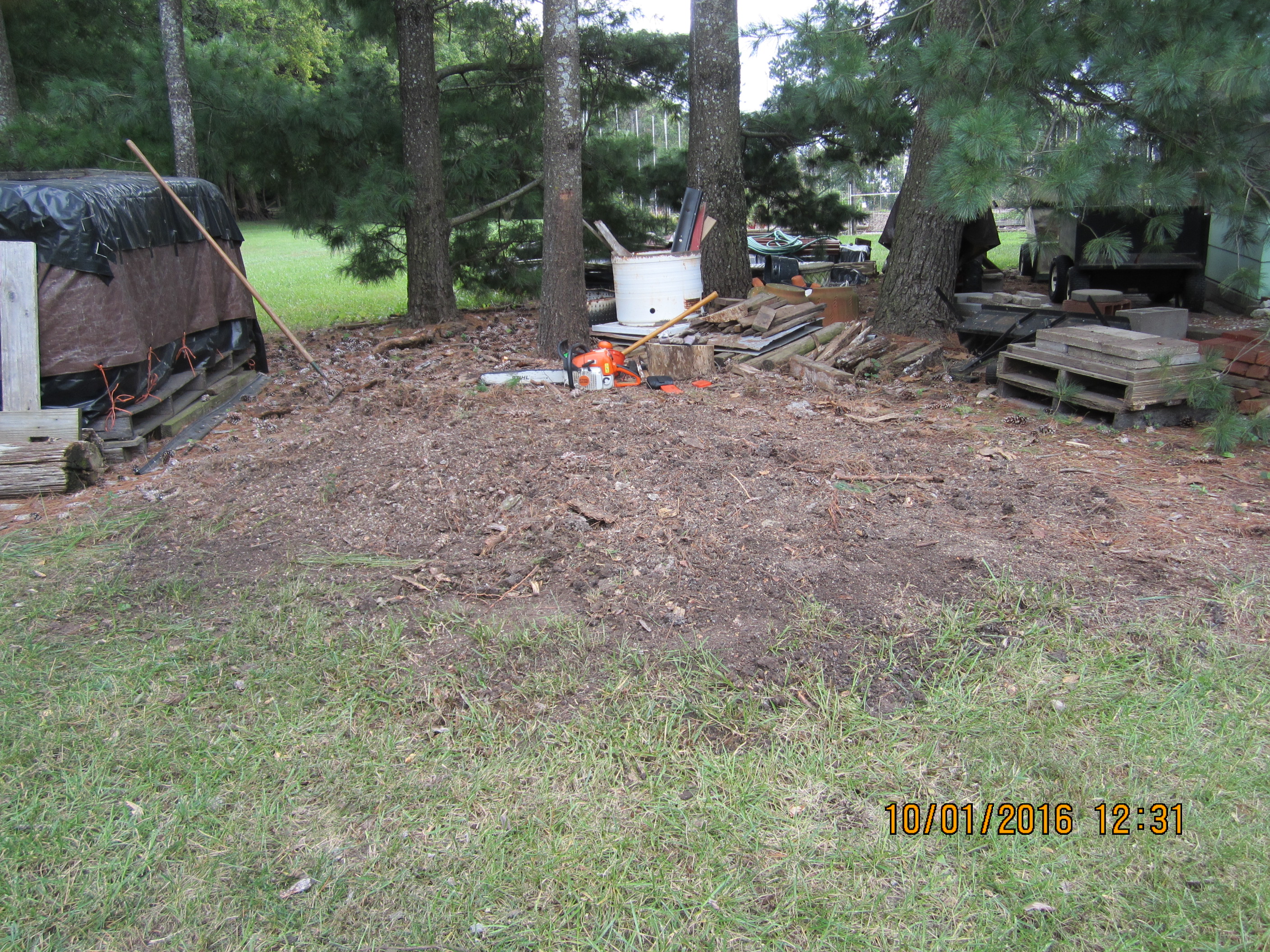

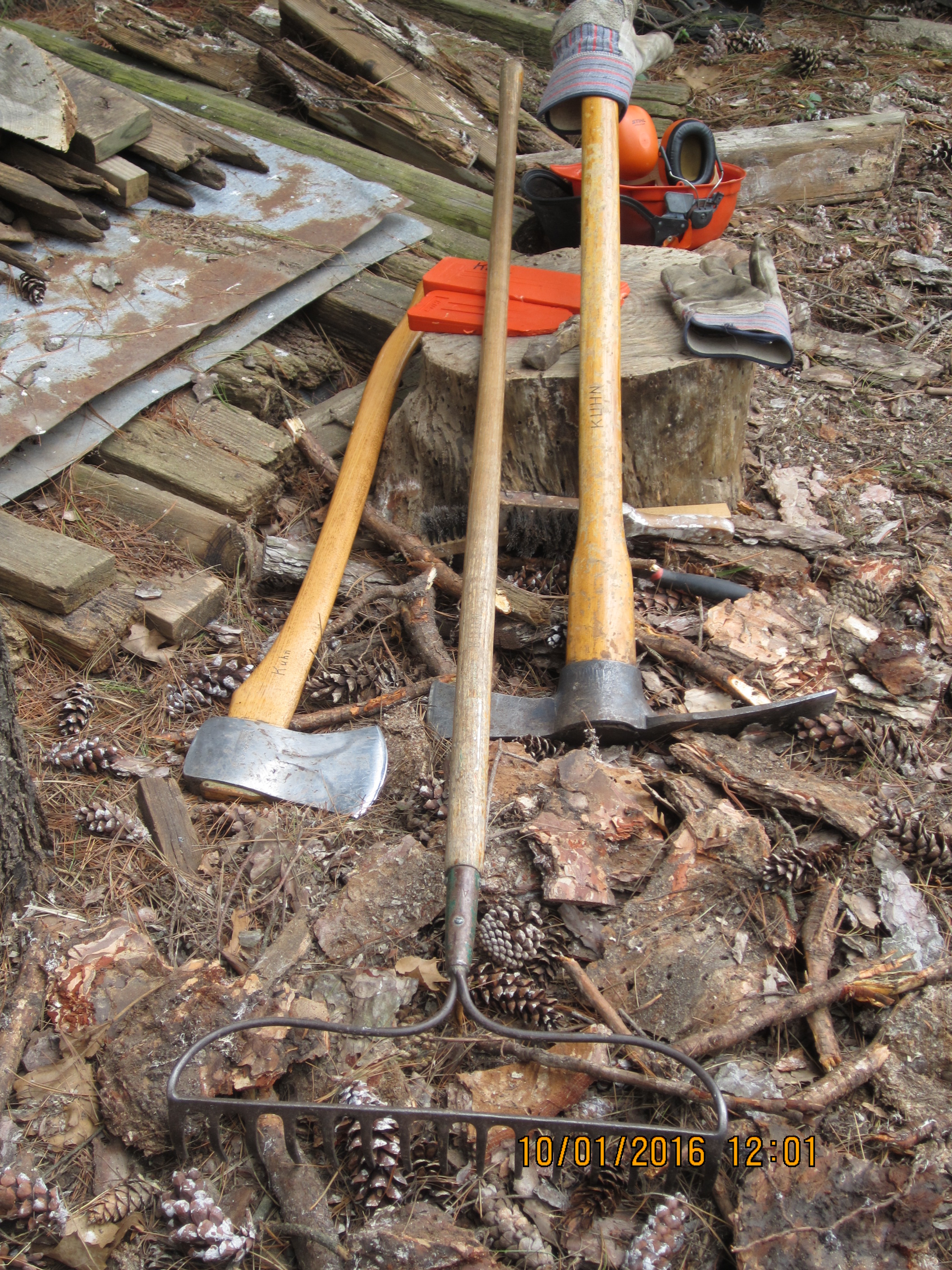

Here's a stump removed using hand tools...just as an FYI. I don't know why an old gezzer would worry about the ball that's covered 8 inches under ground....unless there is a specific reason. I probably spent a day getting it out. Six of them is a different deal however, even with some tractor help.
Cheers,
Mike.

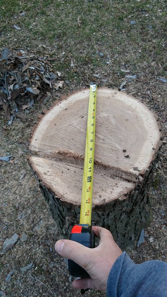

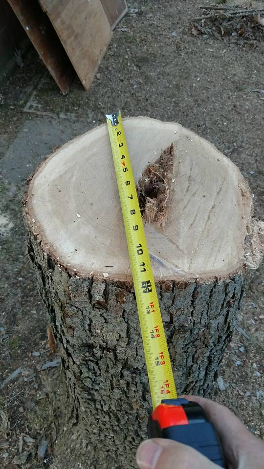

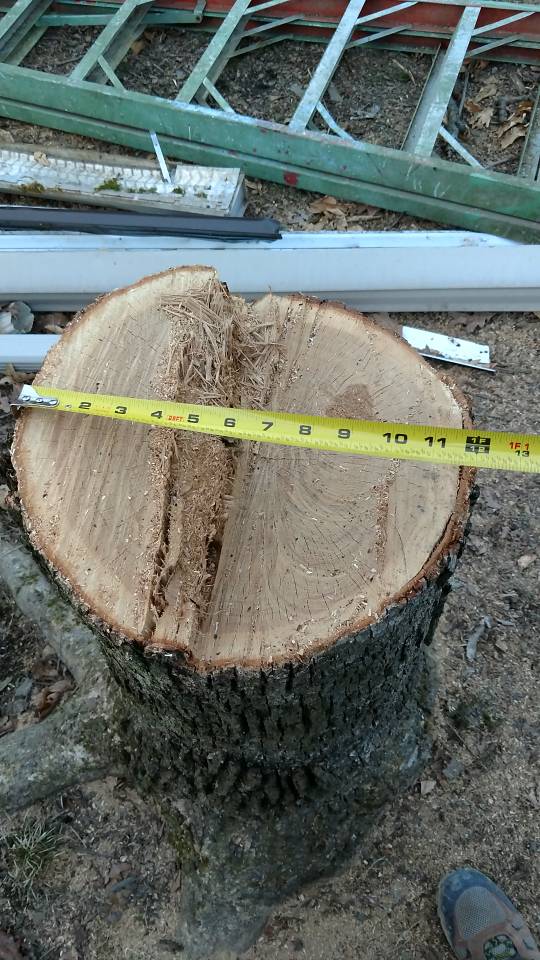

You're way under on your time estimate, and the ability to lift the stump out of the hole with your machine.
Agreed. His machine isn't even going to think about lifting the 14" stump with the huge root ball he's going to have. Maybe trees grow different where he's at but here they grow down to the flat rock and then grow out with a massive amount of roots. Cutting them with a sawzall is as practical as cutting the grass with scissors. A hickory stump would be a lot easier. Once you cut the tap root it's pretty much over and there's so few other roots that dirt won't stick in the root ball. If you proceed with this project don't give the guy a time estimate and leave room to quit if it's not going your way.
Your assumption is correct. But you don't really need the bucket until after the tree is down. The ripper cuts the side roots and loosens the soil around roots making for a much smaller root ball to contend with. I don't know how well your tractor will be able to push on the trunk because of its size but since you have plenty of other trees near by you could use a come-along to pull the tree over.
