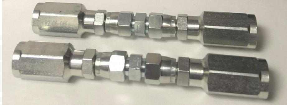

You don’t need a machine if you buy reusable hose ends and you also don’t have to buy more fittings when the hose is done, just replace the hose, using the same fittings.
It’s not completely unheard of for a hose to fail right before the fitting too. If that’s the case and you left yourself a little extra, you can just cut the bad part out and reinstall the end without removing the hose from the equipment, much less have to drive it into town.
You’ll save the $5k but will need two adjustable wrenches…
If I sold hoses, they would be crimped though. Get to buy cheaper fittings to mark up and get the “come back” because the customer cannot reuse them indefinitely.
One of these will also be handy to have.
I have heard about using those reusable compression fittings as a quick field repair option. If you blow a hose, and you're hose is long enough (almost never is) you can cut out the blown part and use these to connect the two ends back together. Its enough to finish the day, get your tractor out of the mud, that type of thing. Maybe I'll invest in a handful for such emergencies.
Let me guess, you heard that from a guy that sells you crimped hoses…
If a hose end is good for 4000 PSI today, what makes it not good for that next year?
If you are making your own hydraulic hoses, why would you make them so short, you have no room for error? Even if you have very long hoses, a bad spot can be cut out and once coupled back together are even longer than before.
I would certainly use them before I tried to buy some budget crimped for the cheap fittings. However, that is only because I have been using them for decades and know they work.
Crimped ends are a cheaper alternative, can be assembled very quickly and are not user serviceable. Those are good things if you are making or selling things but not if your the one that has to keep them going.

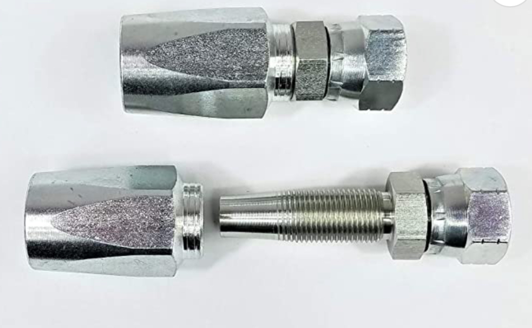

Saw a number of hydraulic repairs on "Deadliest Catch" using the field repair ends. Definitely looks like a good strategy vs crimper option, especially since 1. Ends are reusable, 2. More expensive fittings, but indefinite life (cry once), 3. Can acquire over time as needed, then have for life. Only downside I see is that you are locked into matching brand hose, since they apparently aren't interchangeable. Can't buy any cheap hose & expect top results. But, stock up on compatible hoses and the right fittings and you are probably set up for life.
   / Who Makes Their Own Hoses? #15
Most of the "field attachable" fittings I have seen (which are the two piece thread together fittings) are for R2 hose ONLY. Most places use R16 hose because its alot more flexible.
So blowing a factory hose and thinking you can use a field attachable fitting out in the field will only work if its R2 Hose. R2 and R16 are both two wire braid and have the SAME pressure ratings, but the R16 is a little smaller on the outside diameter. The field attachable fittings thread both on the outside and inside of the hose and "bite" into it. With the R16 being a "thinner" wall thickness so to speak....they dont work.
