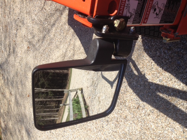

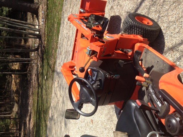

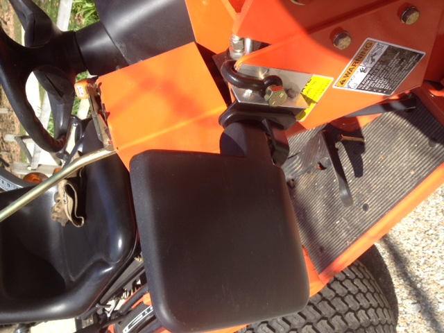

I added mirrors to my BX22, attached to the FEL mounts. I used standard golf cart mirrors mounted with shackles, which I threaded for a retaining bolt. For the right side, I needed a bracket due to the configuration of the FEL mount and FEL lever. No drilling required.
