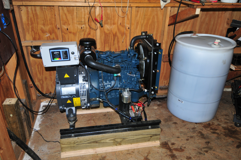

I will throw in my 2 cents. We lost power Saturday night with Irene. Decided not to start my 9.8 KW Kubota powered genset, but to wait till morning. Got up at 6:00 AM and attempted a start, but just got a starter chatter. I always run it every Saturday morning for 10 minutes to exercise it. I have a float charger on the battery and it always kicks over, but with no charger overnight during the storm the battery was shot. Jumped it with the Kubota tractor and ran two full days, with the night off since it was mainly a waste of fuel. Got a new battery and swapped it out and found a warranty slip on the old battery: 7+ years old, so it was due.
With a manual transfer I run the whole house. I kill the hot water heater (but I did run it on the second afternoon to get some hot water in reserve), but it runs my 2 geothermal heat pumps (air con this time of year) and one air heat pump for the latest addition. I don't think I could start all together, but they all run at the same time without a problem. Since it is 3 zones, they never start exactly at the same time. Total of 5 tons of cooling. Only issue is my modern stove which gets upset on gen power. I am not sure if it is power quality or just frequency not being exact. It beeps and flashes so I shut it down. Everything else works fine. We cooked with the convection/microwave. Genset is an 1800 RPM with a fully electronic regulated brushless alternator, rated at 11.5 KW.
In total burned about 9 gallons of diesel in 2 full days of operation, and shutdown overnight. Family was happy with A/C, water, TV and all of the amenities.
paul

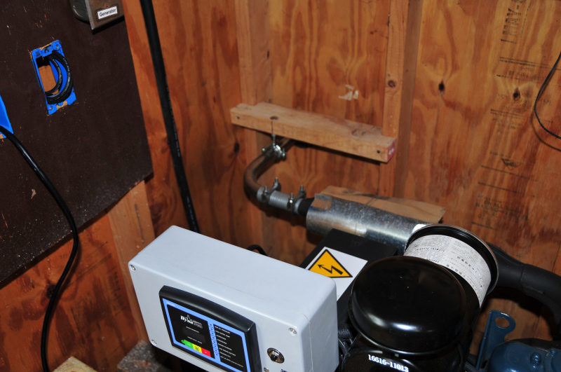

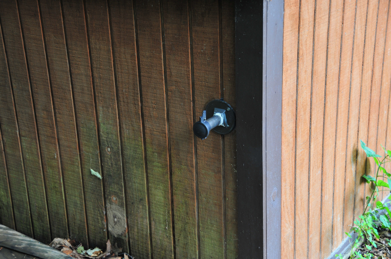

Techman that is a fine looking liquid cooled unit. It looks like it is in a shop or something like that, so what do you do about exhaust fumes?
DaBear:
It is loacated in my shed, which is about 50' from the house. I have the exhaust piped outside (see pix).
paul
