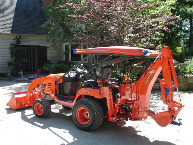

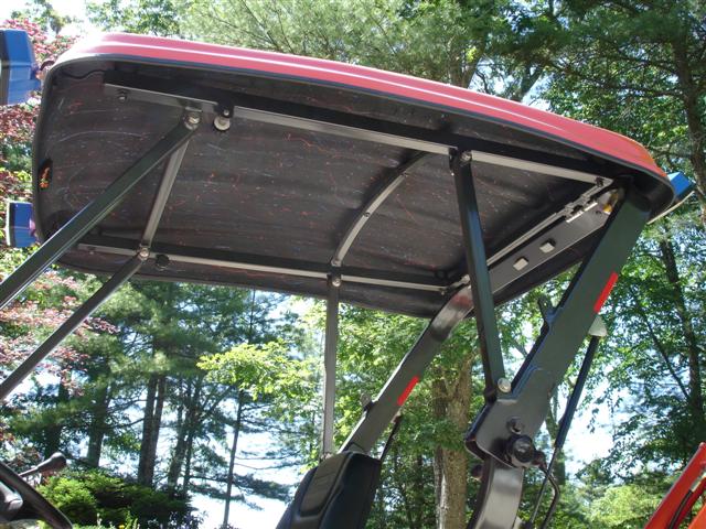

I picked up the same canopy as you - I liked the shape & heaved all the parts that came with it - and was able to take the decal off with a heat gun (just warm them up). Have the same issue with the water / drip edge, but have not come up with a solution yet.

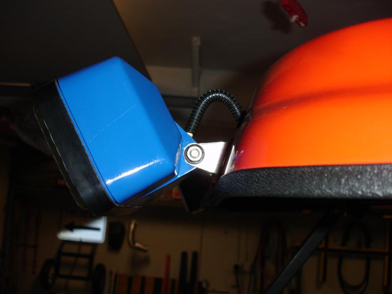

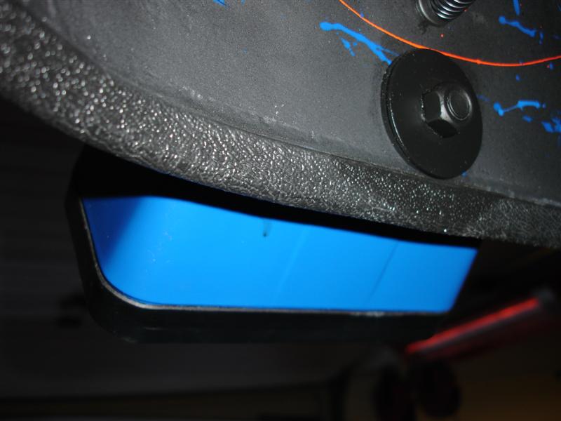

I mounted my lights directly to the canopy, but reinforced that area with 2 layers of fiberglass first. The switches were implanted in the rops & all the wiring was hidden pretty well - the main feed is inside the rops. It is hinged at the back end which allows it to fold & stay level in the process.

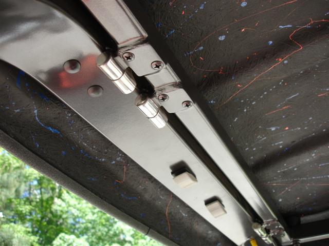

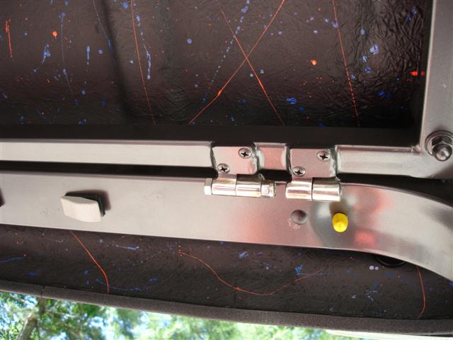

Pics of hinges

A very nice and clean setup- I like the switch mounting.
I would like to make a liner and all for mine, but I'm not sure how much to do now and how much to put off until I can try to build a cab. I may mount the switches to the center console to keep them out of the way of future additions.
