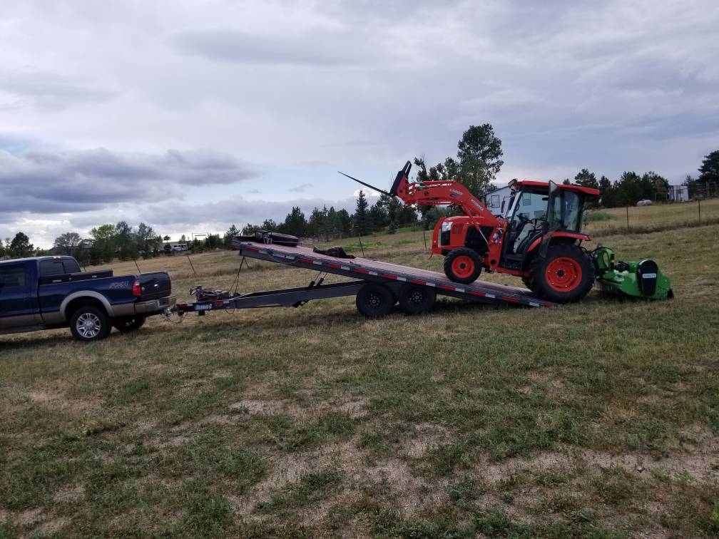

/ Tilt trailer choice #2

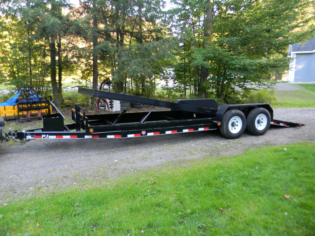

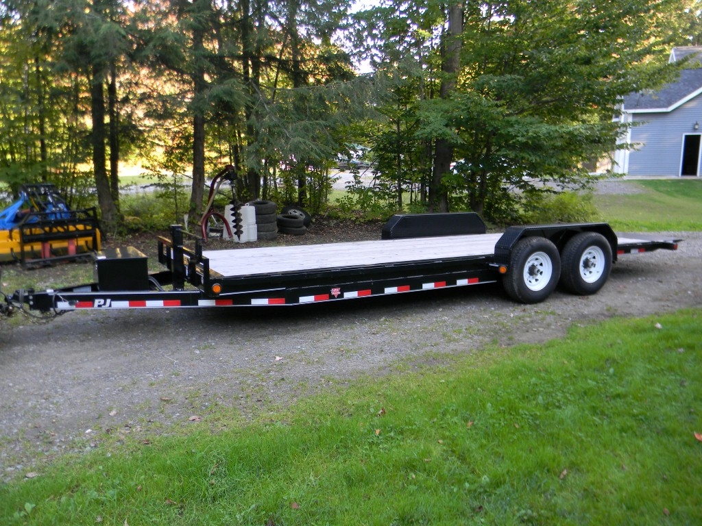

I have the PJ TF 22' 14K full power tilt. Bought it new 11 years ago. Pivot point is behind the axles. No problems with it at all. I added a winch.

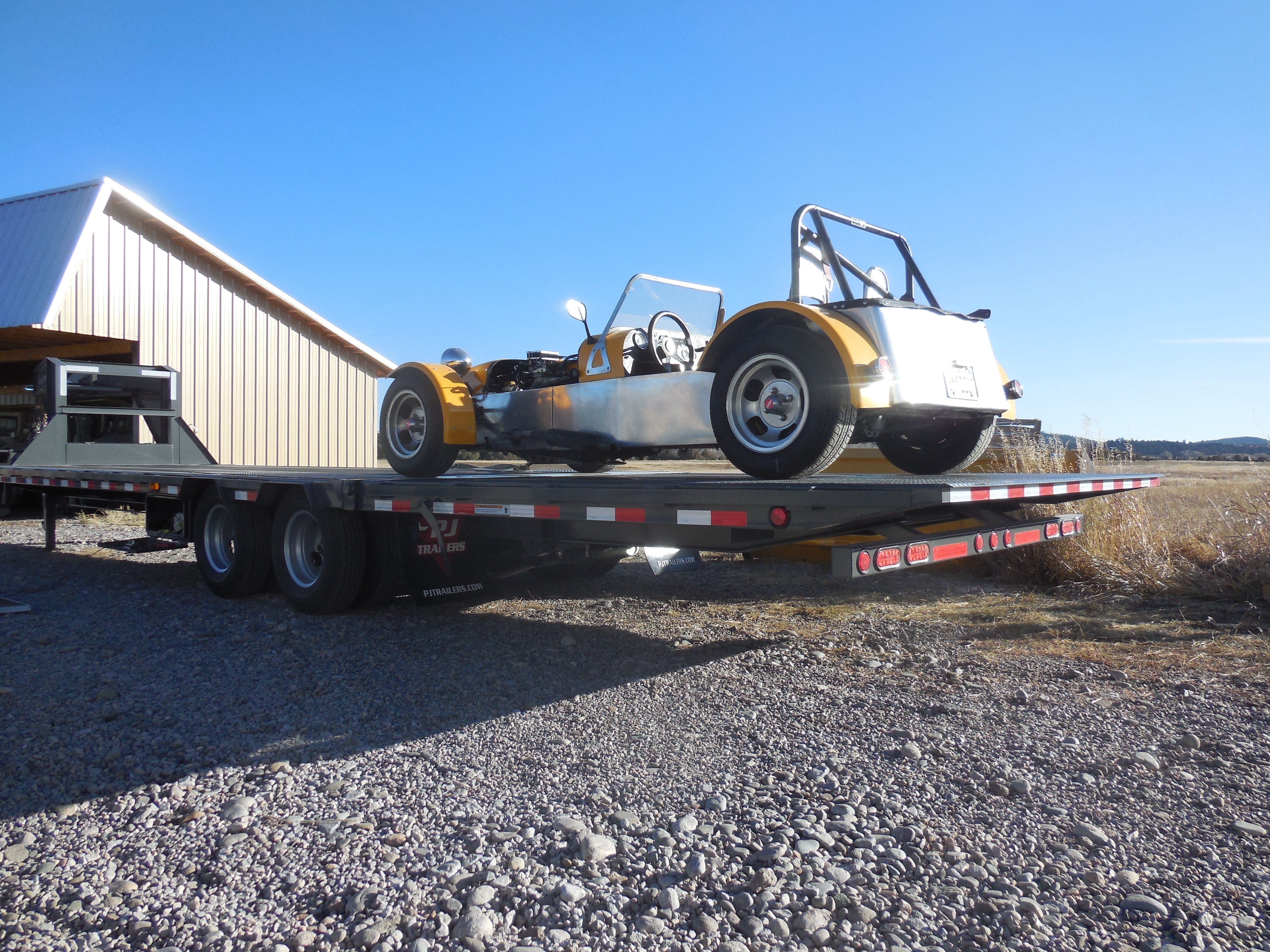

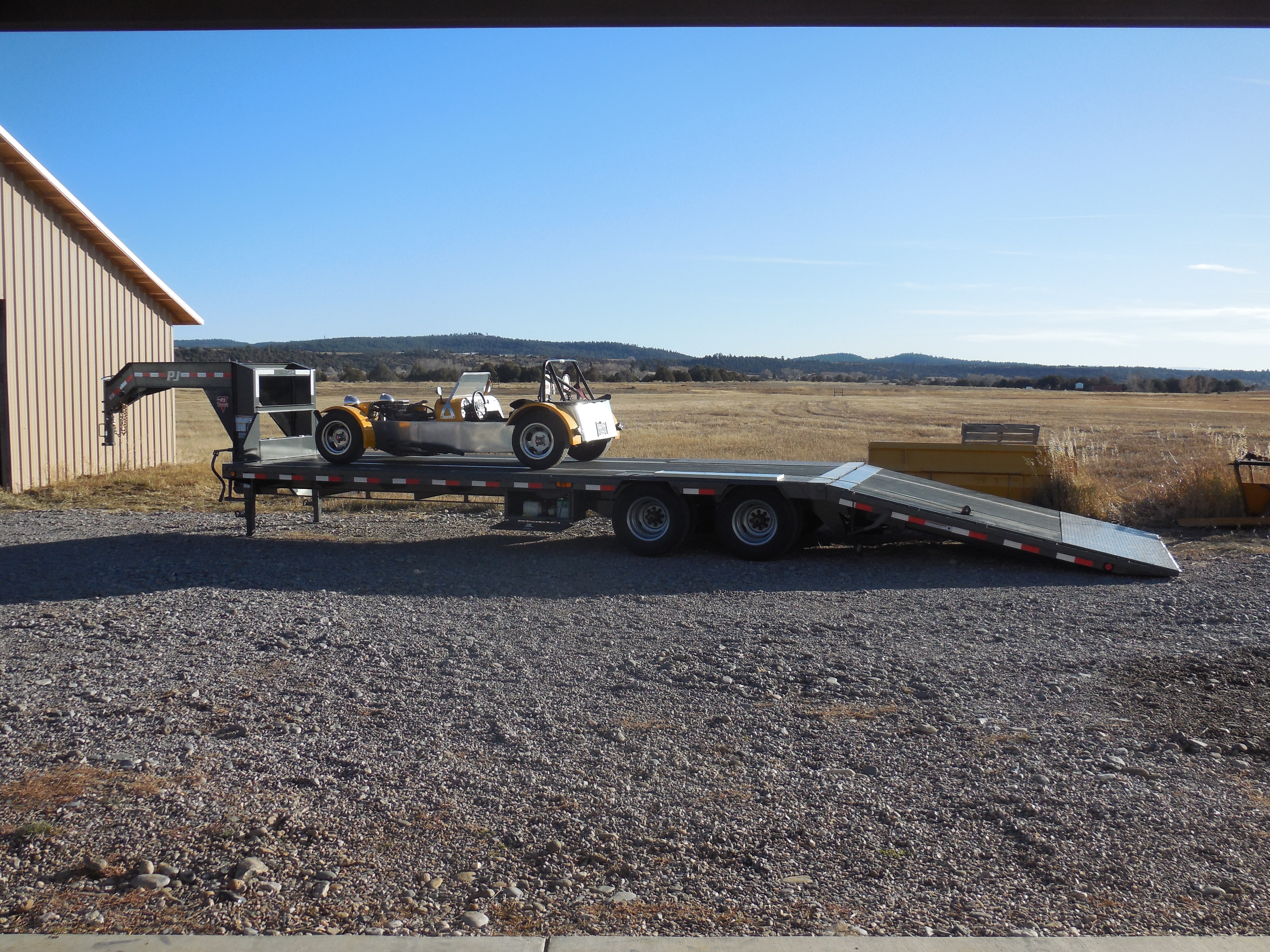

/ Tilt trailer choice #3
I like my deck over power tilt Diamond C. The deck angle is a bit steep though. Some compliments drag loading & unloading. A SUV loads fine, but wouldn't recommend it for a car, much less sports car.
Not having fenders or sides interfering with loading stuff over the sides is super nice. Makes up for the steeper deck angle that makes loading the tractor marginally harder.View attachment 3169041

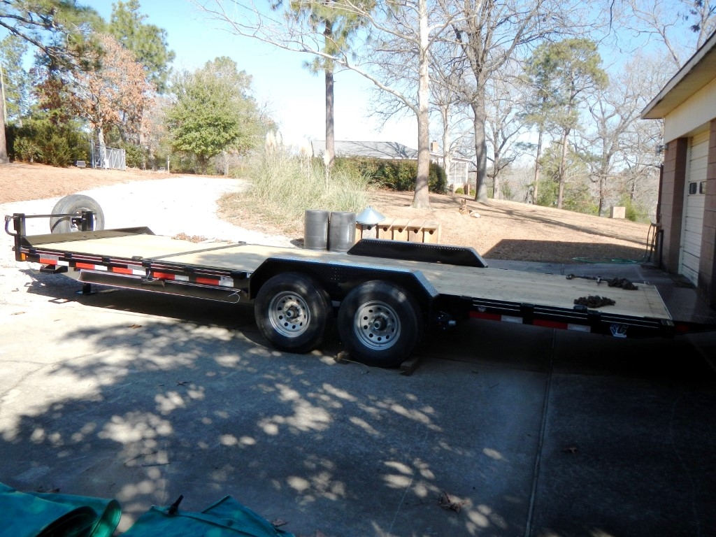

/ Tilt trailer choice #4
A basic flatbed with a 2-3' beavertail and longer ramps (I much prefer aluminum over heavy steel ones) works well for me.

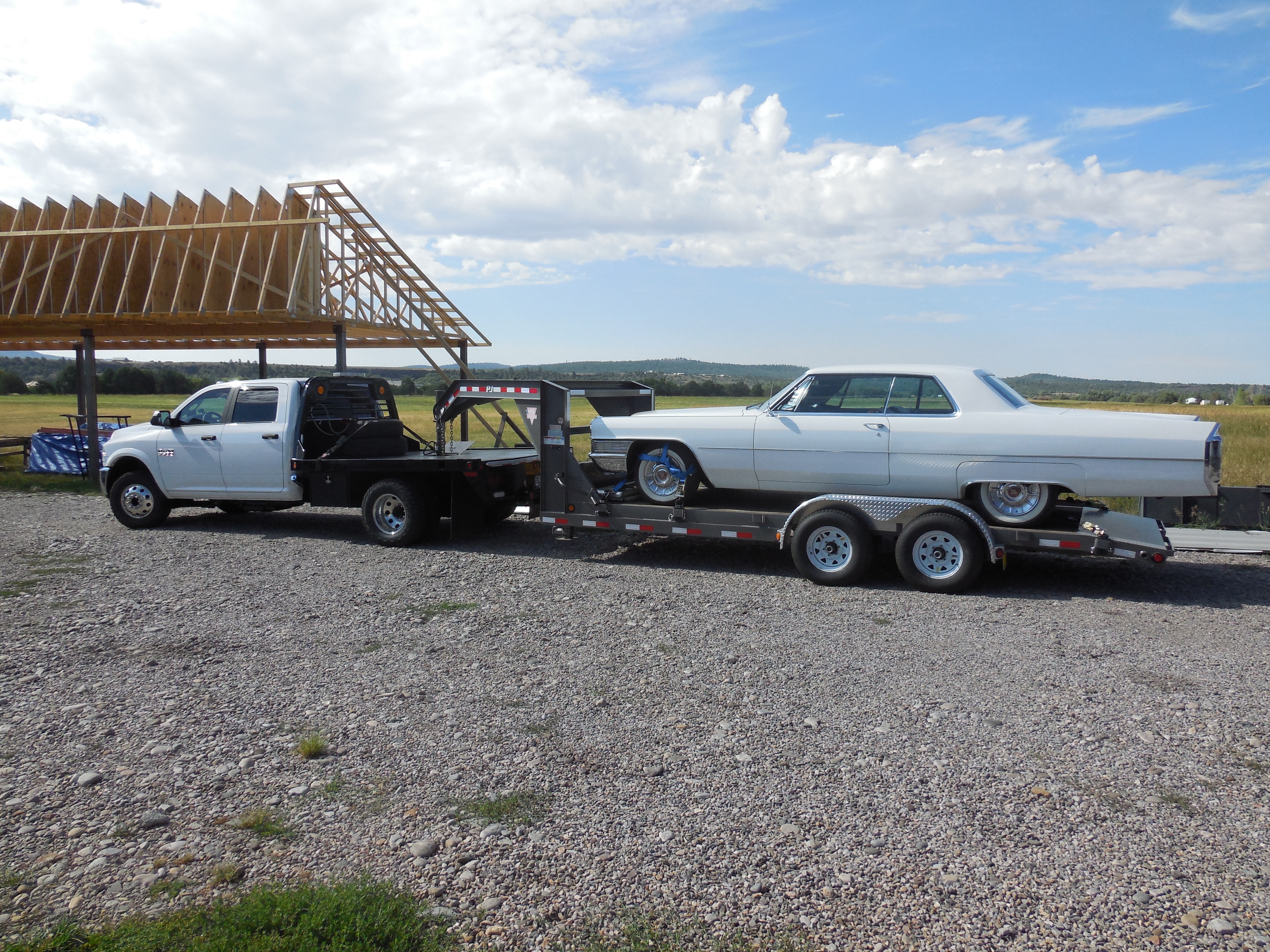

/ Tilt trailer choice #7
Nice setup!
How much does that trailer weigh and what are it’s specifications?
Thanks!
I'll have to look at the registration, can't remember the weight, but it's surprisingly light. With 5,200-lb. axles it holds enough load, yet lets the suspension work even with small cars or tractors.
The small size is handy in cramped locations, but I wish it was about two feet longer. And one of these years I'll probably add to it.
Overkill for the OP, but I really like my 35' with hydraulic tail. Dump the air suspension, lower the tail, and the approach angle is good enough for most cars. If the breakover angle is a problem, raise the tail once the rear tires are on it.
I'll post the weight later.

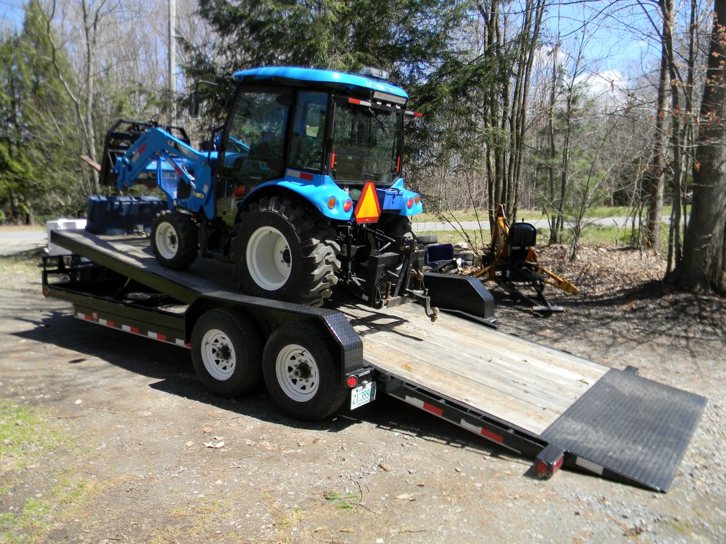

/ Tilt trailer choice #9
I have a 24 foot Diamond C tilt bed. I have had for a few years. 14K and lockable toolbox up front. Very happy with it.
