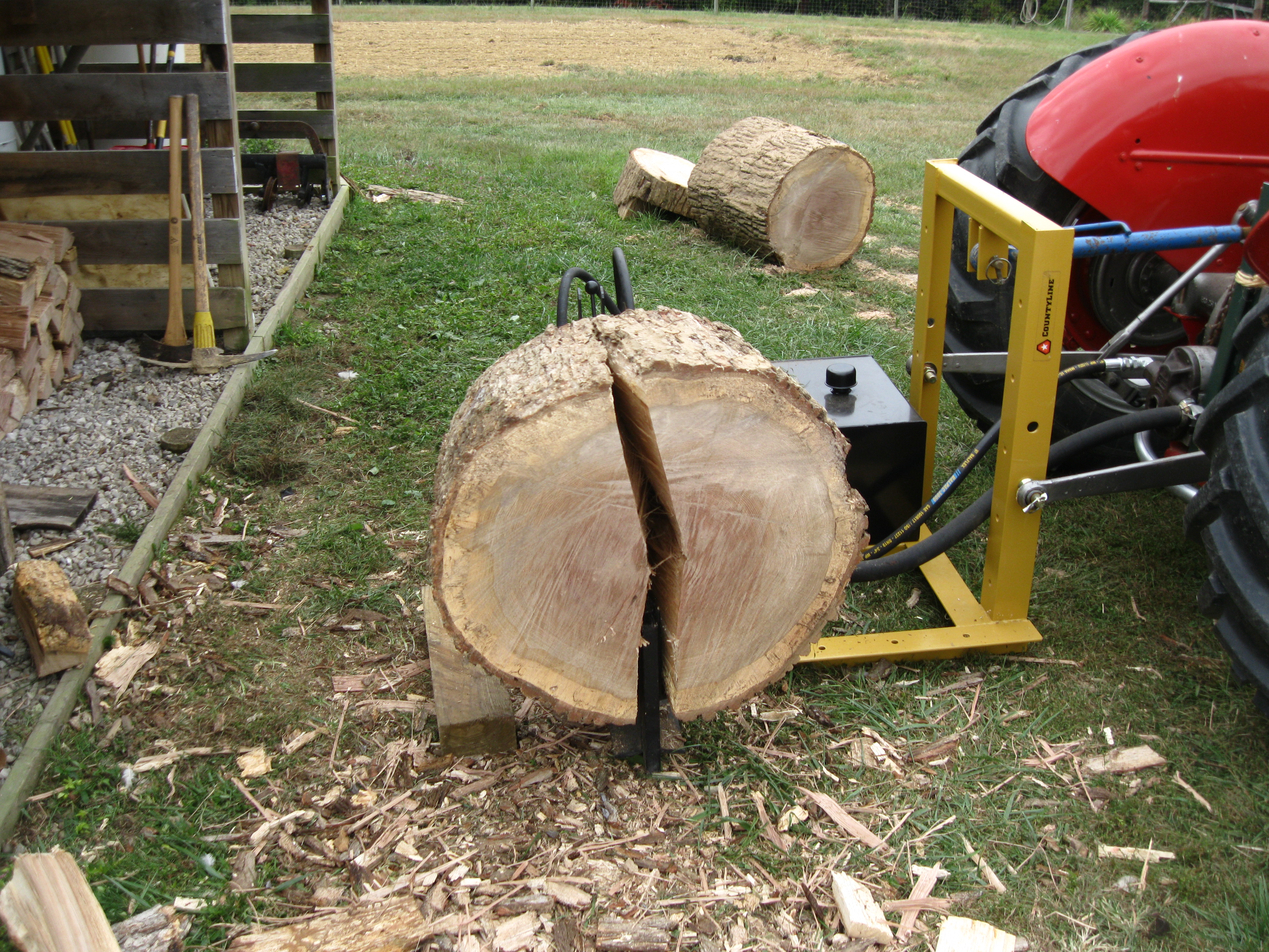

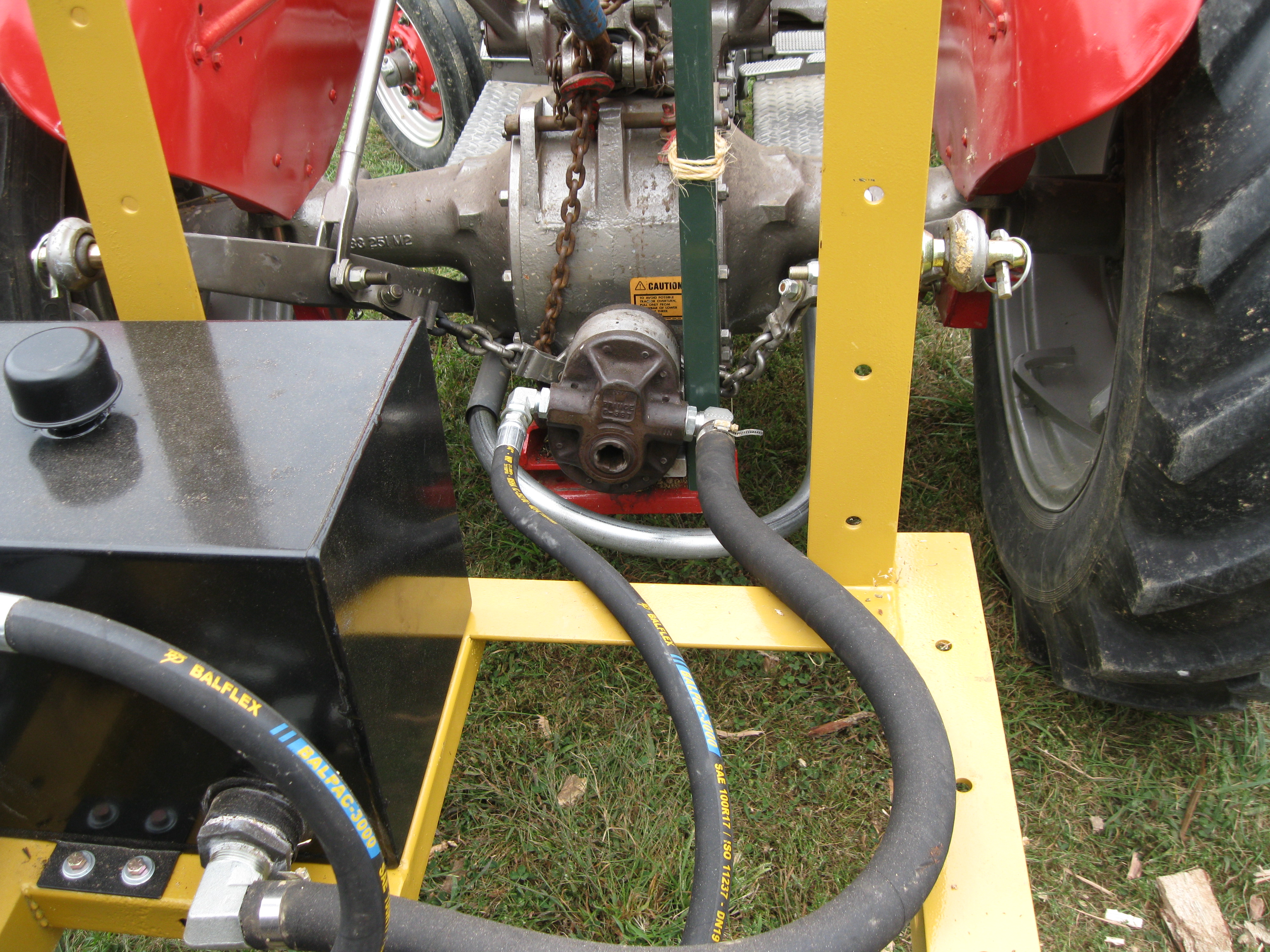

Here are some pictures of my log splitter running on PTO. I went this route so as to not to have another small engine to keep operational. Works on any of my tractors with PTO except my Farmall Cub. My 135 diesel runs just above idle.

A few questions...
Did you make it yourself (Pictures please)
What remote do you use to power it (Dump/Tilt or PTO)
What would you do different?
I'm thinking some people are thinking the title of this thread is asking if they're running their splitter off of their PTO.
The PT in the thread title stands for Power Trac.
But it's still interesting to see other folks' splitters.
