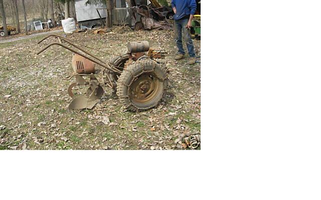

Let's make the tractor simpler. A David Bradley tractor is actually a good model for the hitch attachment question.
This simplifies the COM issue considerably, and I hope it helps clarify the issue a bit. The center of mass issue is mostly gone, but the implement attachment issue still remains.
