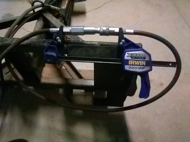

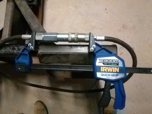

Will try it this afternoon after it warms up outside.
Warmed up to 40°f, so tried it for putting the attachment hoses together.
They are lined up:
Clicked together, easy peasy.

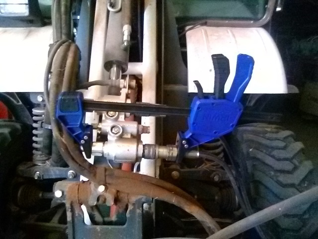

Tried it on the Toolcat, top connector lined up:
And seated:
Bottom connector lined up:
And seated:
The XBoom QC-Mate is a gooder-un 🤞
   / Why are hoses hard to connect??? #37
I'm glad it's working for you. I'm very pleased with mine!
I've even used it with FF couplers on loose hoses. It worked fine. Before getting the tool it was a nightmare for this old geezer. :)
