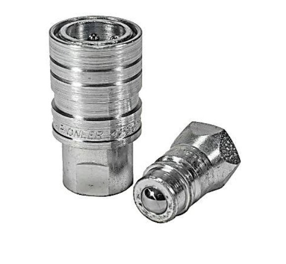

Today I went to connect my grapple hoses on. Anything hydraulic I use plastic end caps when not used. I always shut tractor off and relieve pressure by moving levers. I shop rag wipe everything clean. One went on easy as pie, I hold female ring back, slip in & release in seconds. Other I fought with 1/2 hr. No nicks or burrs, it's similar to picture but 3/4" so more holding balls around edge but same ball valve design.
Finally I removed female end and it went on & off easily, so I just coupled it back connected. No leaks.
What In the world makes them hard to connect at times? Doesn't make sense.View attachment 736194
Most 3rd function hydraulic hoses don't relieve pressure when you cycle them with engine off. You either have to milk the male fitting or crack open the connection at the grapple cylinders to relieve pressure. Also make sure there is no residual oil in thr female fitting when you retry a failed connection.

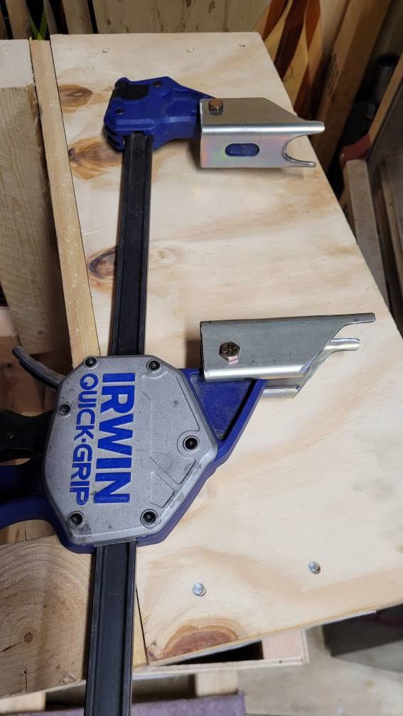

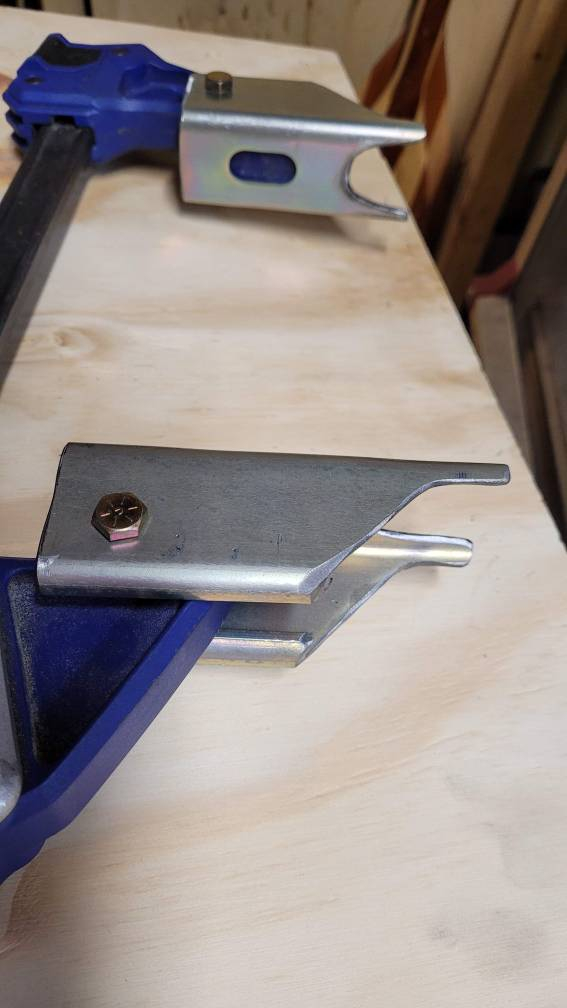

Couple of 3 inch sections of left over Uni-Strut, 1/4 inch bolts and a grinder...
Works great on the Skid Steer style flat face couplers which I find tougher than the AG style to tap and bleed off pressure.
