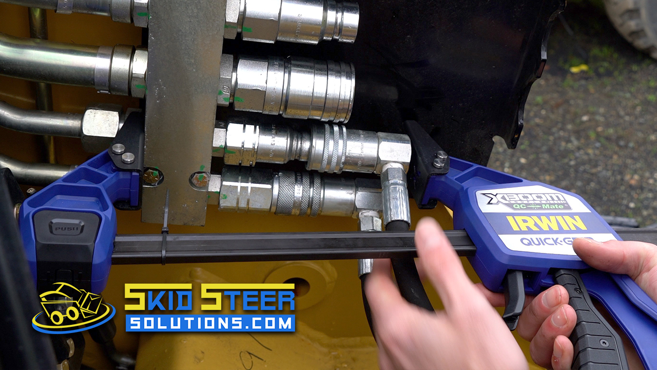

Between built up pressure in the lines, less than perfectly smooth/clean mating surfaces, and arthritis in my hands I was really struggling with couplers (Ag and Flat Face). This tool has really helped me. It's a bit bulky, but man does it work!
Mike Morgan recently showed this tool on one of his YouTube videos. Seemed to work very well.
Personally I use The Waite Hydraulic Decompression Tool - BoltOnHooks LLC which releases the pressure like the various "cover with a rag and hit with a hammer" tricks, but with more control.
In theory I love the solution of connecting your implements' hoses together....except if both implement sides of the circuit are male!
As others have said, thermal expansion of the fluid is the usual cause. Made worse if gravity and sag compress the fluid too. What got me to spend the $ for the Waite Tool was my backhoe, where the stabilizers sag as its sitting there, increasing the pressure.

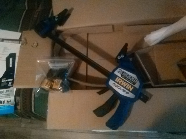

Just got mine today, ordered on eBay from the manufacturer: Items for sale by xboom-coupler | eBay
Will try it this afternoon after it warms up outside.
