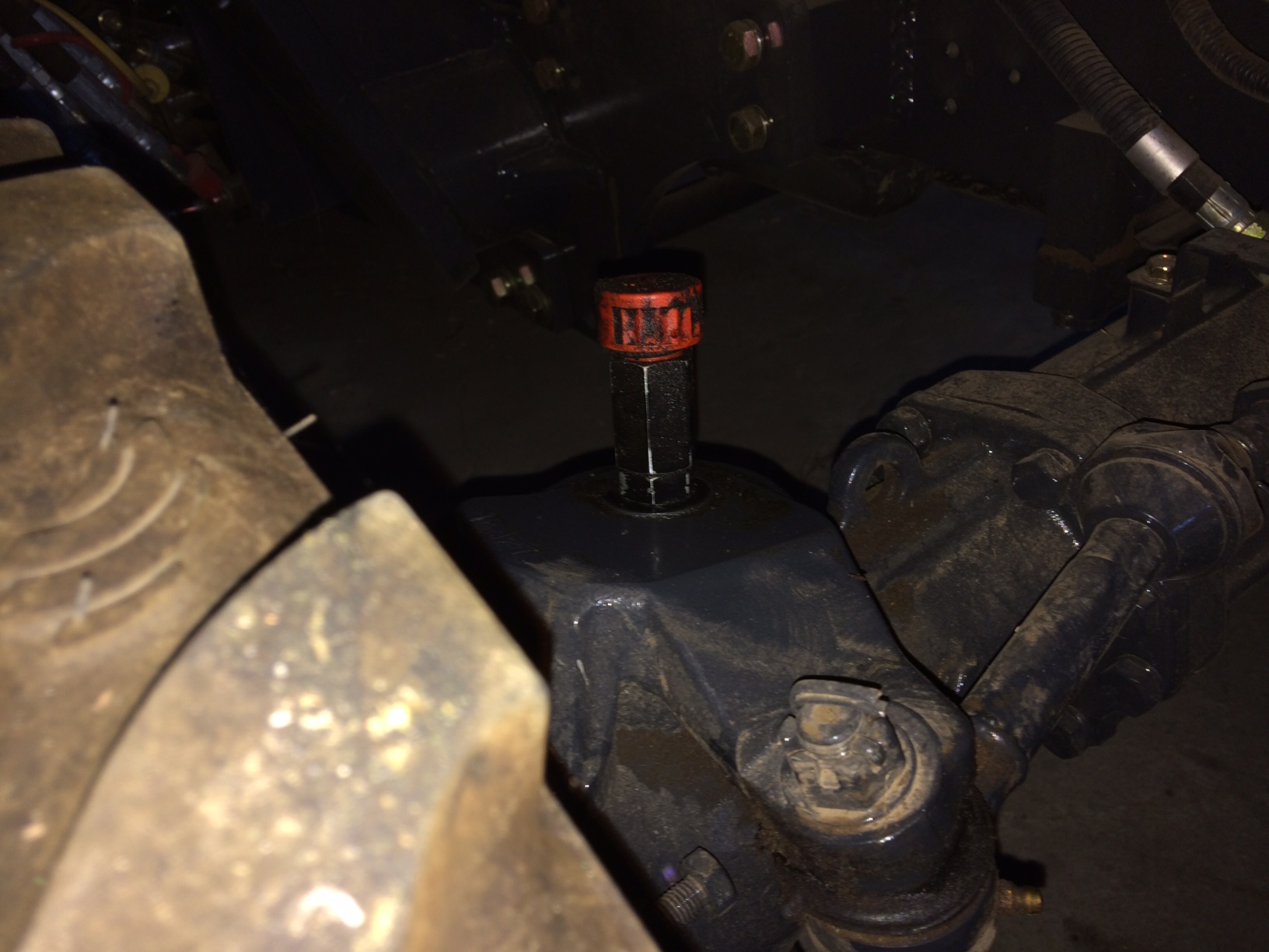

Eric, The front axle leak at the filter vent, is that a problem on all Branson tractors or just your particular model ? I wouldn't be happy about that issue.
Maybe some of the others can comment on this issue. Does anyone else have the same problem ?
John
Nope. Front axles come with built in dip sticks and are sealed. Some may only have one dipstick which is ok since you are supposed to check on level ground and if in the full or near full range oil is all away across the front axle and you only need one.
   / Why Branson over Others ? #35
Axles heat up in normal operation and the air expands, raising the pressure. That can push oil past the seals or even push the seals out. So they need vents or breathers. Pretty much all axles have them. On my 3725 the orange plastic cap that isn't the dipstick has the breather in it.
Maybe a more complete fix than the tube I got from Dave's would be to connect a hose to that tube or the filler cap and run it along the axle and then up the center of the tractor. Then plug the vent in the cap. My concerns with that would be ripping the hose off in brush and the oil pooling in the hose where it dips down to run along the axle. Breather hoses are supposed to go up so there's no oil in them to block the air. The hose damage problem can be addressed by running the hose on the back side of the axle and tying it down well. The oil would just have to be left in the hose. Maybe put a cannister in the hose at the center of the tractor so air can push the oil in the hose out into the cannister where the air can get around it and escape. It hasn't been enough of a problem for me to do this.

Here is a video of a Swedish dealer showing the 25 series Branson.
You can see how the engine looks without the DPF and also, you can see the new style vent on the front diff.
