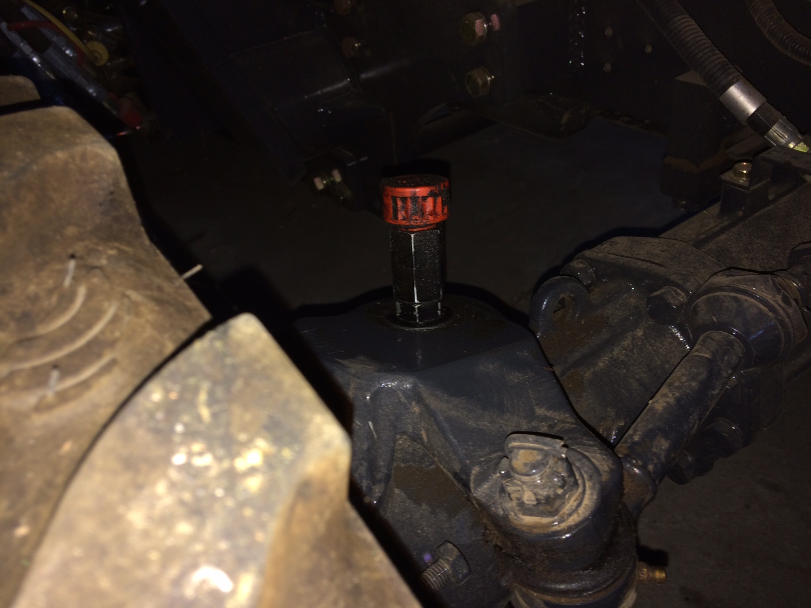

Mine also does that. Or at least did. It came from the dealer with the front diff quite a bit overfilled and I do a lot of mowing in steep hills. When the tractor was tilted to the vent side, it would leak off. Now it's on the right level and doesn't seem to do it anymore. It is not the end of the world anyway.
The last time I went to the dealer, in April, I've noticed that Branson changed the vent style on the newer tractors.

Eric, The front axle leak at the filter vent, is that a problem on all Branson tractors or just your particular model ? I wouldn't be happy about that issue.
It's on some models. Dave's tractor told me they'd been asking Branson to change it. @ptsg says they're different on the new ones. I'll have to see if there's a possible retrofit.
My land is super steep. Dave's put together a package with smaller wheels from the 10 series and spacers on the rear, to make a lower wider tractor that can handle slopes better. I probably do more side hilling than many owners. The axle has only leaked when I park on a sigificant slide slope with the vent on the downhill side.
It was something along this lines. Not exactly that as that is just a picture to illustrate. It was fitted on a F47Rn Narrow.
I've noticed the cap. All steel, not plastic like the ones we have. Looks like it works like a check valve.

Here's front axle vent fix from Daves, on my tractor:
