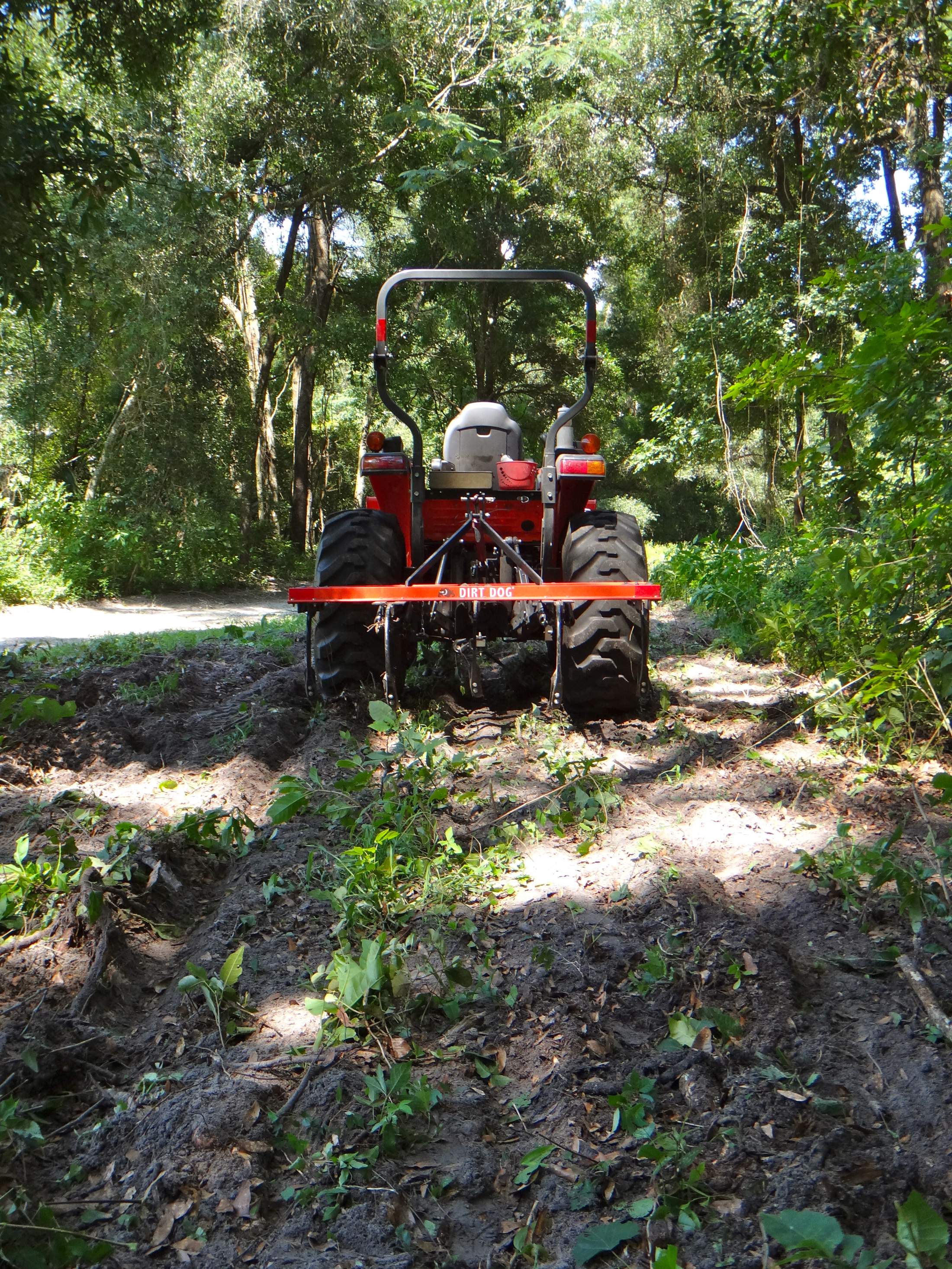

With my soil conditions, sandy-loam, my 800 pound ETA Cultipacker leaves ridges which a homeowner would find objectionable in turf. Turf would also be uncomfortably bumpy to mow. You probably need a smooth roller for residential grass seed.
Likewise, a Cultipacker is too much for very fine Clover seed. A roller will give better results.
Cultipacker is for larger seeds than Clover.
When my house was built the yard was compacted by the subs parking trucks and equipment on it. I have struggled ever since to get a really nice lawn. I did not own it at the time but I now have a Field Cultivator which would have been perfect for aerating soil 10" deep before the sod was laid.
