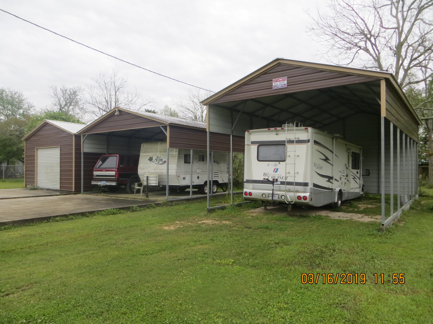

In my area the building code states that you must have the top of the side walls closed in to park an RV or travel trailer in it.
   / Why do some carports and lean-tos have panels half-way up?
#23
Wow, that seems a bit over-reaching. Does the law also dictate what viscosity of motor oil you shall use in said RV?
   / Why do some carports and lean-tos have panels half-way up? #24

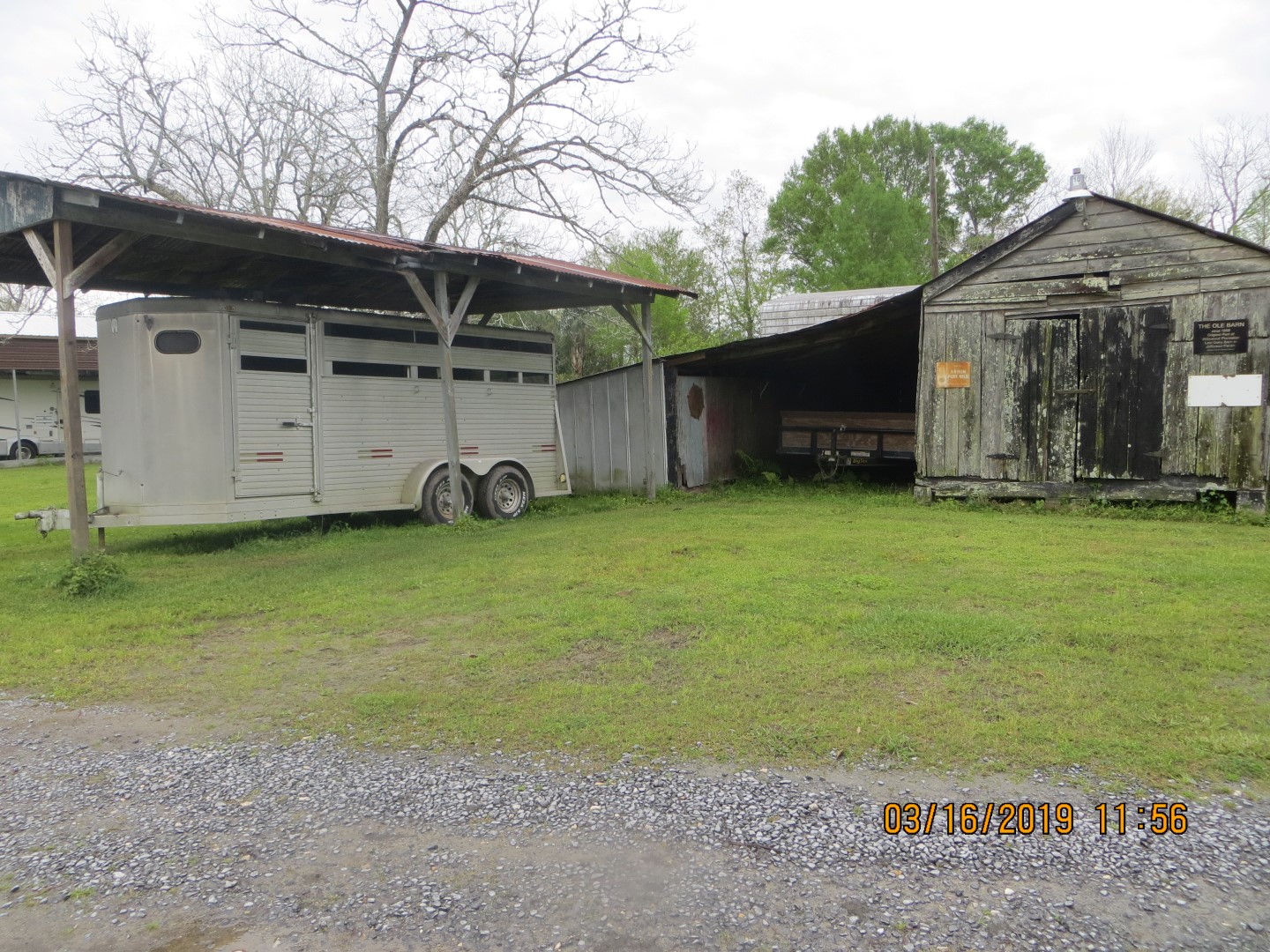

The first photo is my new carports built to the building code. The second photo is my old carport built before the building code and grandfathered in.
   / Why do some carports and lean-tos have panels half-way up? #25
Both your pictures show why the siding is needed to keep the building standing. In the picture with the wood, diagonal bracing is used. On the metal building, a sheet of metal accomplishes this, and does a better job.
