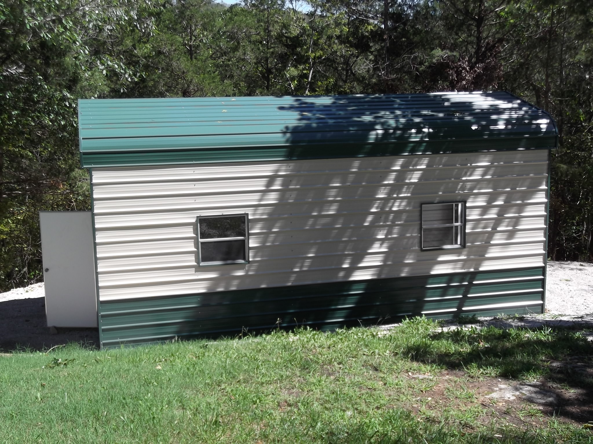

I will tell you my condensate story:. My building is fully enclosed, and NOT insulated. The floor is just gravel over the native dirt. When first built it would "rain" inside the building at times. Big huge drops of water on the inside of the roof falling down on the implements and tractor. I installed large louvered vents in each end one at the gable apex and one on the other end lower down. It solved the condensate problem almost 100%. Very little and only under extreme circumstances now.
When it was sealed up without any air flow, the hot days would make very high humidity inside and then as soon as darkness came and the sheet metal cooled down, the water formed on the roof and rained down. I suppose my vents let out a lot of that hot humid air and if there is any wind, it flows thru the building and exchanges the hot humid air with cooler less saturated air. The photo is before the vents were added.

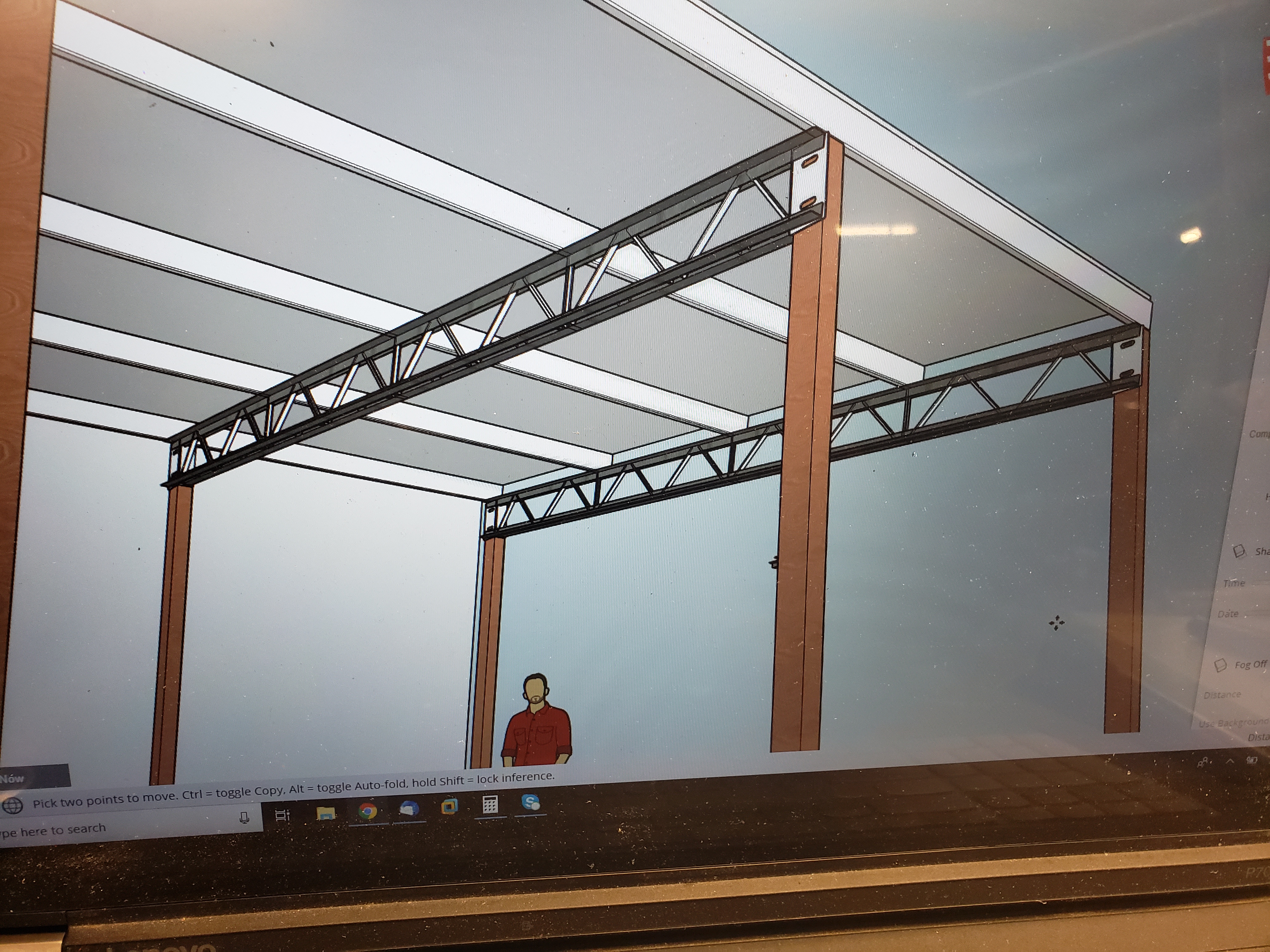

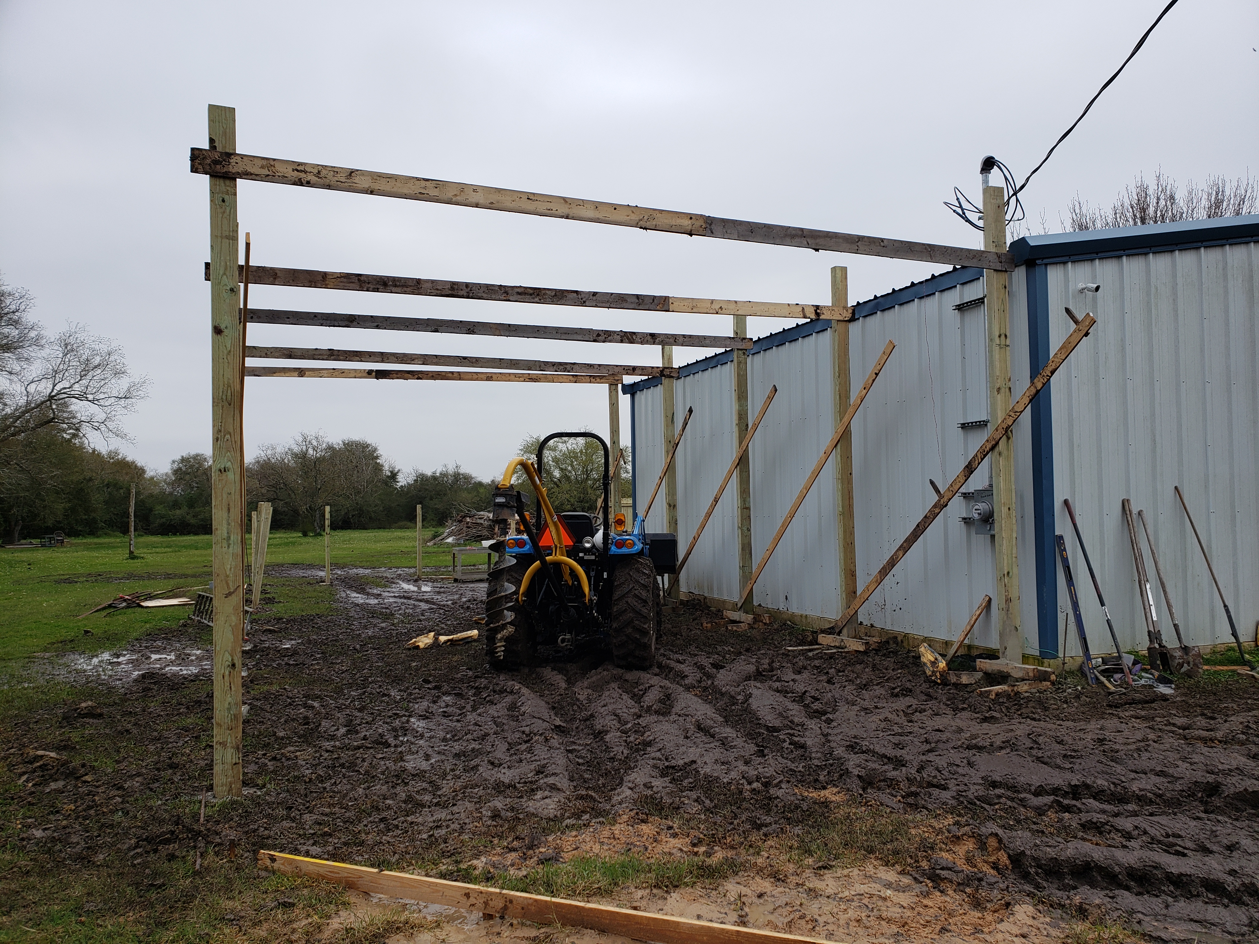

GMTA. What I'm calling a "lean-to" isn't really a lean-to at all. It's a pole barn built as close to my shop as possible, self-supported and not attached to the building at all. I had the building built by a licensed contractor who had it engineered and to withstand hurricanes and delivered with architect-stamped prints. Because I live near the coast in the wind zone, I'm operating a business out of it, it's full of expensive stuff, and I wanted to insure it. I don't know all the technicalities surrounding the insurance and what it takes to void that insurance, but I know that the building, as insured, is designed a certain way to withstand a certain load, and hanging stuff off the side of it in a way that it wasn't engineered to support, would likely be a pretty big nail in the coffin if it ever blew down.
So it won't be attached at all. I'll add some flashing under the existing roof panels to transition from one building to the other, but it won't be fastened to the addition. The addition will be free to flex in the wind without ripping the roof off the existing building. I have some concern about wind getting under that unfastened flashing and pulling it up (leading to pulling up on the roof panels) so I'm considering different methods to hold it down without fastening it down. I'm thinking some powerful magnets spaced every foot or so. Or maybe some tires thrown up on the roof LOL (seems to work in trailer parks).
But I'm trying to make it as robust as reasonably possible, to minimize any relative movement between the two buildings. I went with 4x6 poles spaced 90" apart, cemented 4ft into the ground. I was welding up lattice roof trusses with 12" web but they proved to be so labor intensive that they aren't worth the effort. I've abandoned them in favor of dual back-to-back 6" steel purlins. The extra cost is more than made up for in recovered man-hours even considering the $480 in steel I spent for the truss material.
