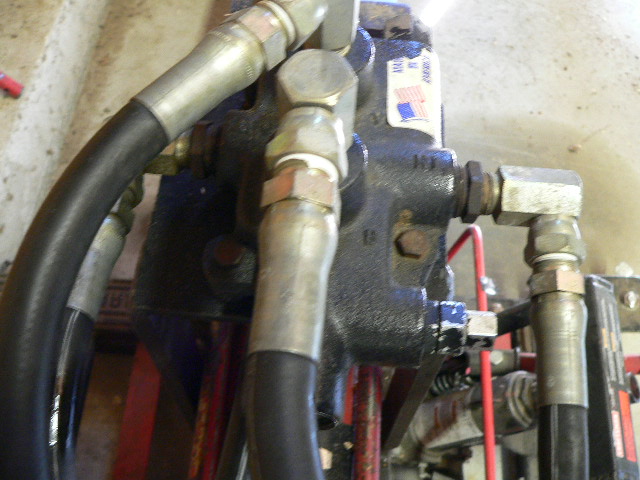

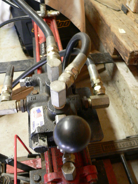

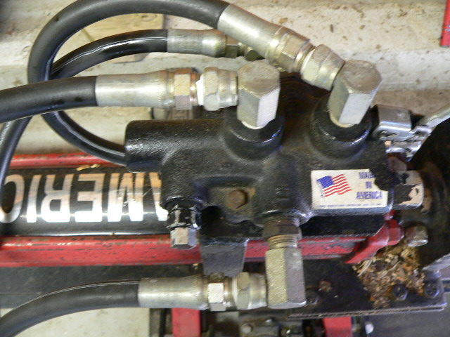

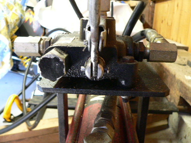

Sure would like to see some side , front, and back pictures of that valve. Is there a name on it?
A good many aux circuit have their own relief to protect that circuit, and anything used downstream will be protected. If you should increase the splitter valve above the tractor relief setting, the tractor relief should come on when you hold the lever in the extended position. If it doesn't, there is leakage somewhere. If that is a true log splitter valve, the lever should detent on the return stroke, and release to neutral at the detent pressure. Some detent reliefs are adjustable.
JJ, I dialed it all the way down and the detent still does not kick off. I will go get pictures of the valve now and post them via edit in a couple of minutes.......

You have to put that gage in the system to see what is going on.
Does the valve go into detent on the return stroke, and what happens to the lever, when the rod is fully retracted? Do you have to pull it out of detent. I would clean the detent relief, and inspect the spring and ball, and if rusted, get a new one or new valve.
I will get a gage and check it out.
Yes, the lever stays in detent position and I have to pull it out, to neutral. The tractor's hyd pump labors a bit, but does not go into pressure relief mode.

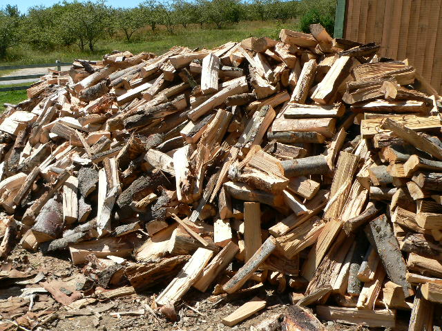

I am done with the splitter for the season, as of this morning, (see production results) so the next rainy day I will pull the valve apart and see what is going on.
Side note, when I dialed down on the PRV I noticed that it took marginally more force to pull the lever out of detent......... wierd.

Cripes Dead horse them are some big sticks you feed your fireplace or woodstove! Around here I have to cut every thing at about 16" so that it will fit in the woodstoves. My woodstove I left at my last house would take 26" pieces. Is that oak you are burning? It would be nice to have some more oak around here. I think the best stuff to burn here is Madrona or Maple followed by Douglas fir.
