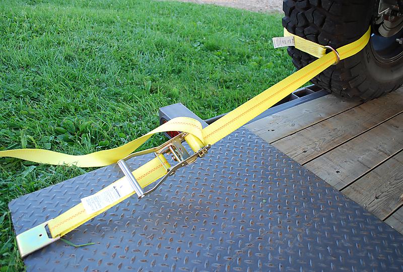

Another idea, for front or rear.
Bruce
   / Why don’t tractors have dedicated tie down points? #14
Bruce
Not sure I like that tie down arrangement. Metal hook on a metal edge. Not sure if there is anything locking the hook in to keep it from sliding sideways. Jon
   / Why don’t tractors have dedicated tie down points? #15
I don't care for that part of the photo. I looks like a very little slack would let the hook slide or come off.
But the real point of the post was the attachment to the wheel if no tie down point was available on the vehicle.
Bruce

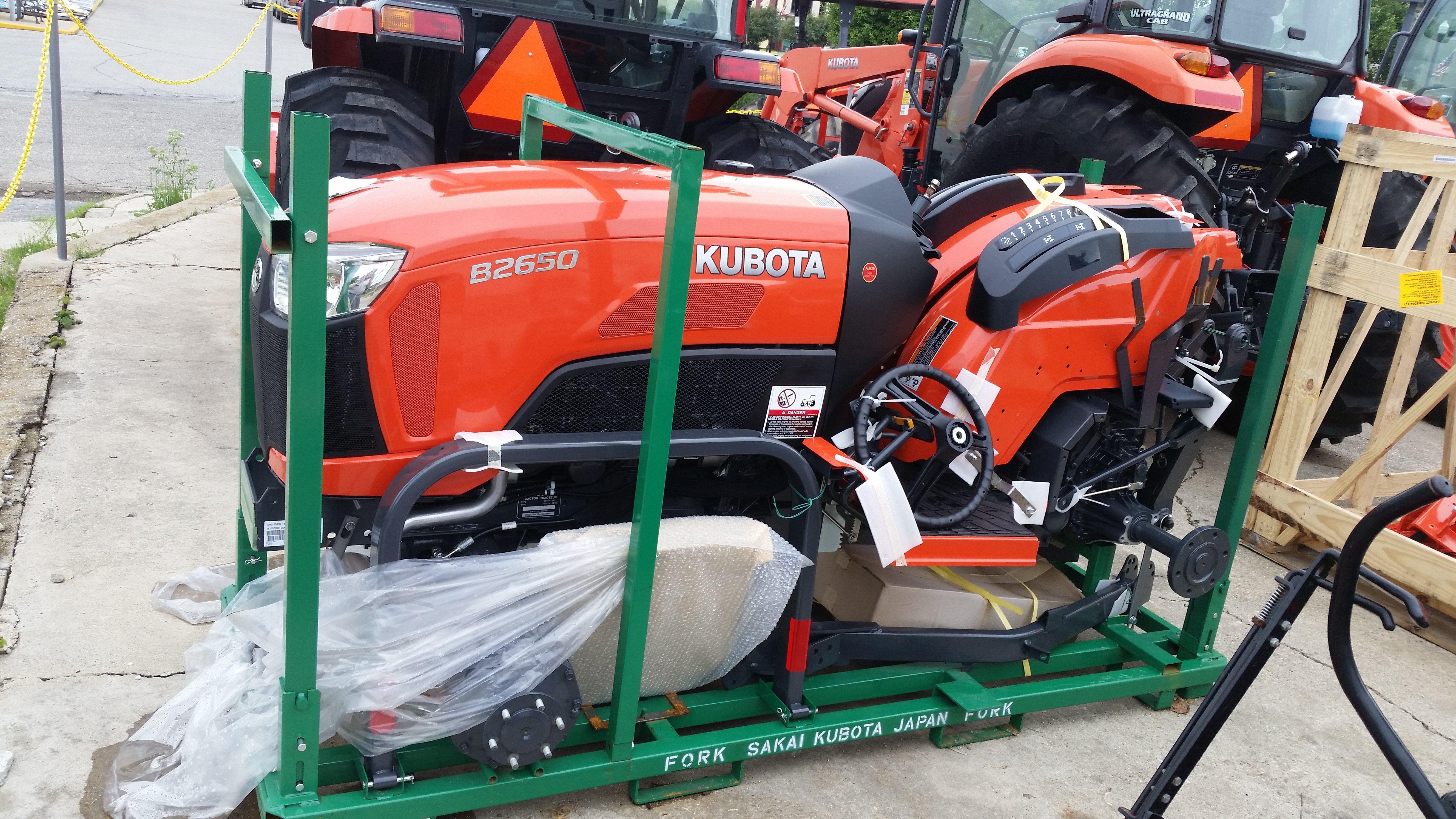

Are yoo sure you don't have any? The grill guard on my Kubota has holes in it that serve as a tie down point. Like previously posted almost every tractor has a draw bar in the rear that also can be used.
