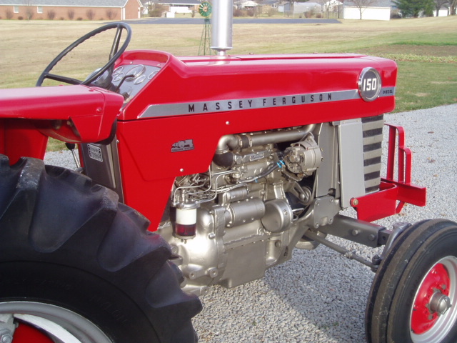

By this time next year, it'll look like a used tractor again. Oh well...... It took 35 years to wear out the original paint job. Maybe with some luck, this one will last 10 or 15. (More'n likely about 6 months.)
Why, we even have 'lectricity here in K'ntuky. Uss'ns hillbilly folk lik all them thar modern conveniences.
Just got off the phone with Valu-Bilt. Ordered all the wear parts for the Massey Ferguson #66 plow and #25 disc I've got to go with the 150. They get the royal treatment next. I'm planning on trying to locate the #39 planter, #41 Dyna-Balance mower, and any other "period pieces" that match up with the tractor. This is getting expensive! (Also have a line on the mid-mounted 2-row cultivators. VERY rare)

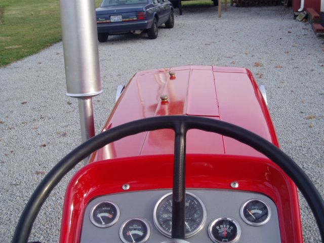

I've already wet sanded and buffed out one "sag". (Not quite a full-blown run)
I'll probably wait 6 weeks or so to let everything dry down good, then do some polishing. I'm not so much after more shine as I am just getting a good lasting finish. It just happened to turn out REAL shiney. I used the absolute maximum amount of hardener, sprayed just a tick "wet" (thinned) with the paint, and the lowest air pressure I've ever used with my paint gun. (25psi-Sharpe Platinum HVLP) The hood has been done for almost a week now, and from 10 feet away, it still looks wet.
And funny you should mention it, but the 3 remaining runs are ALL in high wear areas. (Where leg makes contact with fender when getting on and off the tractor) Before painting, those areas were worn clear to bare metal. It won't take too long to wear off the runs in all likelyhood.

If you do decide to sand the runs out, try this it works!
Take a single edge razor blade and drag it across the high side of the sag.
A few swipes with the blade will have the run near the surface of the paint.
Then wet sand & polish the area, I do this all the time with clear coats.
Sags in metallic paints is not so foregiveing.
Sometimes it's also a good idea to round the corners of the blade.
Again your work looks nice.

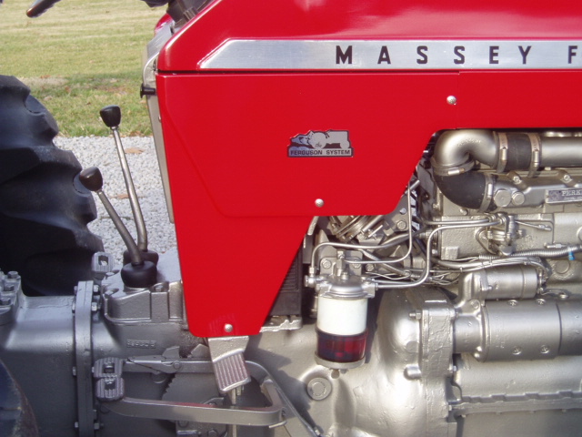

Nice tractor.
Noticed that there's no blue paint on the injector. Did you replace the old injector after the paint job? Or did you mask the injector before painting?
I notice that the injector is painted over on a lot of restoration/touchup jobs that I see on TBN and on eBay. My feeling is that it's probably not a good idea to paint over the injector fittings and other associated plumbing. Any comments? Am I being too nitpicky here?

All the new tractors I've ever bought had the injector pump and lines painted from the factory. Shouldn't be an issue.

Thanks flusher,
The injection pump along with the engine was rebuilt last year. The pump shop that I took it too dipped it and cleaned it and them put a coat of clear lacquer over it. I like the look of the bare pump vs it being painted. Plus if I ever need to prime it, the diesel that comes out of the plug on the top will more than likely remove the paint anyways. Here is close up of the injection pump and engine on my tractor.
Ford used the same injection pump in the Major, from there original design up until they were changed in 1962 with the Super Major.
The pipes from the injection pump to the injectors are painted. We painted those because they were steel and I did not want them to rust.
If the tractor were to go back to its original paint job the whole tractor would be painted blue. They even painted the radiator hoses, fan belt, and electrical wires.
