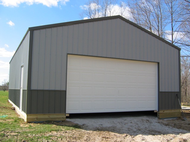

Here are more pics of the almost completed project. I know all about doing things myself. I was al set to build this thing on my own. Last year I completly ripped shingles and rotten decking off the house and reroofed it. I love building things myself but..... If I was to buy the kit either from the 84 lumber or menards or the metal sales place that build this barn it would have cost me $5500 for just the kit. This company build the thing for $7415 including tax. And the builders are amish and if there are two things the amish can do its build barns and build cabinets, not to mention they started on thursday morning at 8am and were finished at 12 noon on friday. I still have plenty of work to do. As you can see by the pics I still have the concrete floor to pour (already has 40 ton of fill dust in it, plate compacted every three inches and still needs more). I have to run the wiring from the house to the barn for ac, phone, intercom, etc. I am going to slowly start insulation and finishing out the wall and ceiling as time and money permit. And I still have a good bit of driveway left to install. Thank god the neighbor has a bobcat, backhoe, and dozer. So anyway enough of that more pics. btw the building is 26'x40'x10'. 16'x8' overhead door.
   / Why I let pros build it (pics)
#12
overhead door

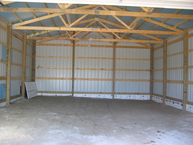

#13
inside, floor still needs more fill before the concrete..

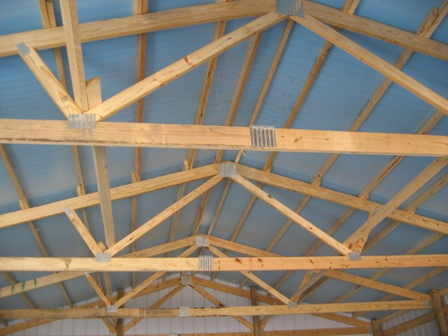

#14
trusses 8' o.c. 39# snow load. Also had 1/4 inch fanfold under metal, over purlins to prevent condensation. Also had ridgevent installed so when I do get the ceiling in and insulated I can cut the fanfold out at the ridge and have a functioning ridgevent.

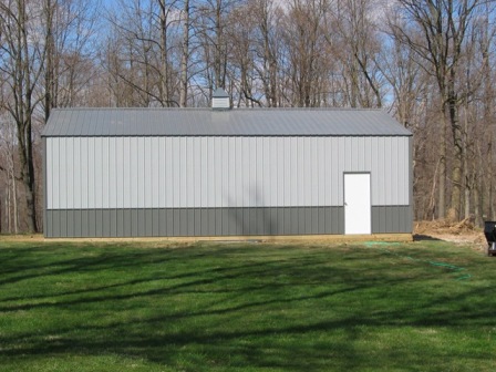

I really like the two tone siding. That is definitely a good buy. $2000 dollars for that much labor is a good deal as far as I’m concerned.
Very nice
Eric
#16
Yea, I like the two tone sides, only added $250. That darn cupola on top, now thats a different story. $275 for that thing, it is 2'x2' and about 3' tall. But that is the one thing the wife insisted on so i did not fight it to hard. Thinkin I may add some windows later, it kinda looks plain.
