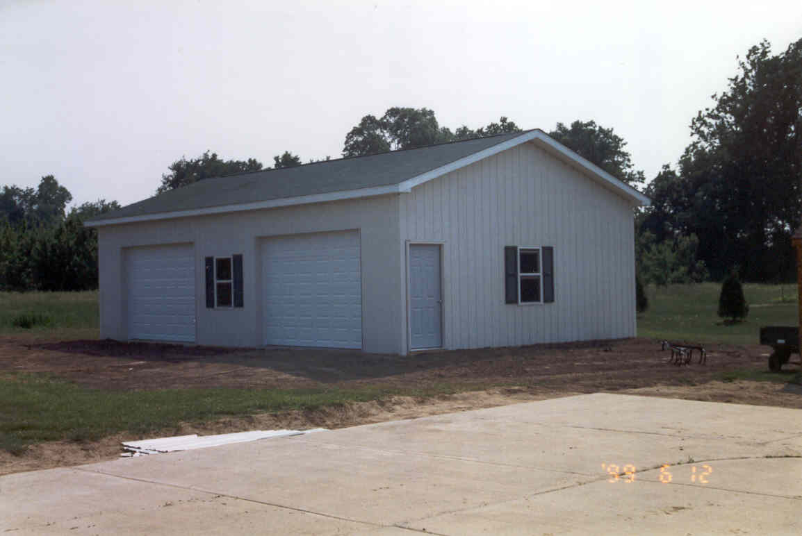

Your barn is similiar in size to mine. Mine is 24x40x10. I paid $8,000 for my barn and $2,000 for the concrete work. I had two 12x8 doors installed and two windows. The windows really set it off and make it look like it belongs in a residential setting as opposed to a commercial look.
The big difference for me was that the two-man team I hired was in no hurry. They never worked more than eight hours in a day and spent about a month building the barn. (not including concrete)

The $7415 does not include concrete, fill stone, or insulation. I am finding that this can add to the cost quickly. I already have 120 tons of stone in the drive/barn and still need about 80 tons. I agree with you it does need some windows. I will add that to my list.

Your builders did a terrific job. I like the two tone look. I'd be thrilled with the building.

Nice building. "?". Is your overhang vented all the way around or did you mix between vented and non-vented. When mine was built I was told it was good to vent all the way around, which I did.

Hey Mark, I don't think it is a violation of the forum rules, The company is Davies County Metal Sales. The $7415 was material, labor and tax. No site work or concrete. The concrete added another $1800. Davies County Metals has a web site. They dont list package prices, but it does kinda give you an idea of whats available... Davies county metals
