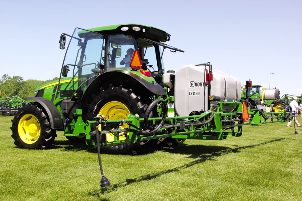

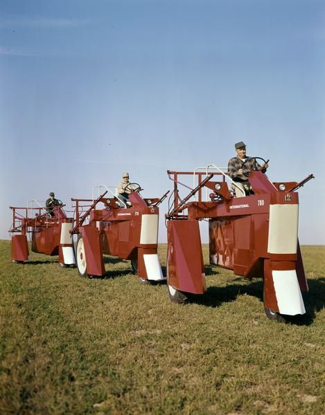

Taller or narrower tires aren’t just for increased traction but also for crop clearance. Fewer and less effective chemicals were available in the past for weeds and pest control so crops were cultivated or sprayed longer into a season. Multiple tractors or High Boy type sprayers aren’t affordable or practical for everyone. Cotton grows to over 3 feet and tobacco to over 5 feet. I operated a IH High Boy spraying cotton for boil weevils one summer as a teenager in the late 70’s.
