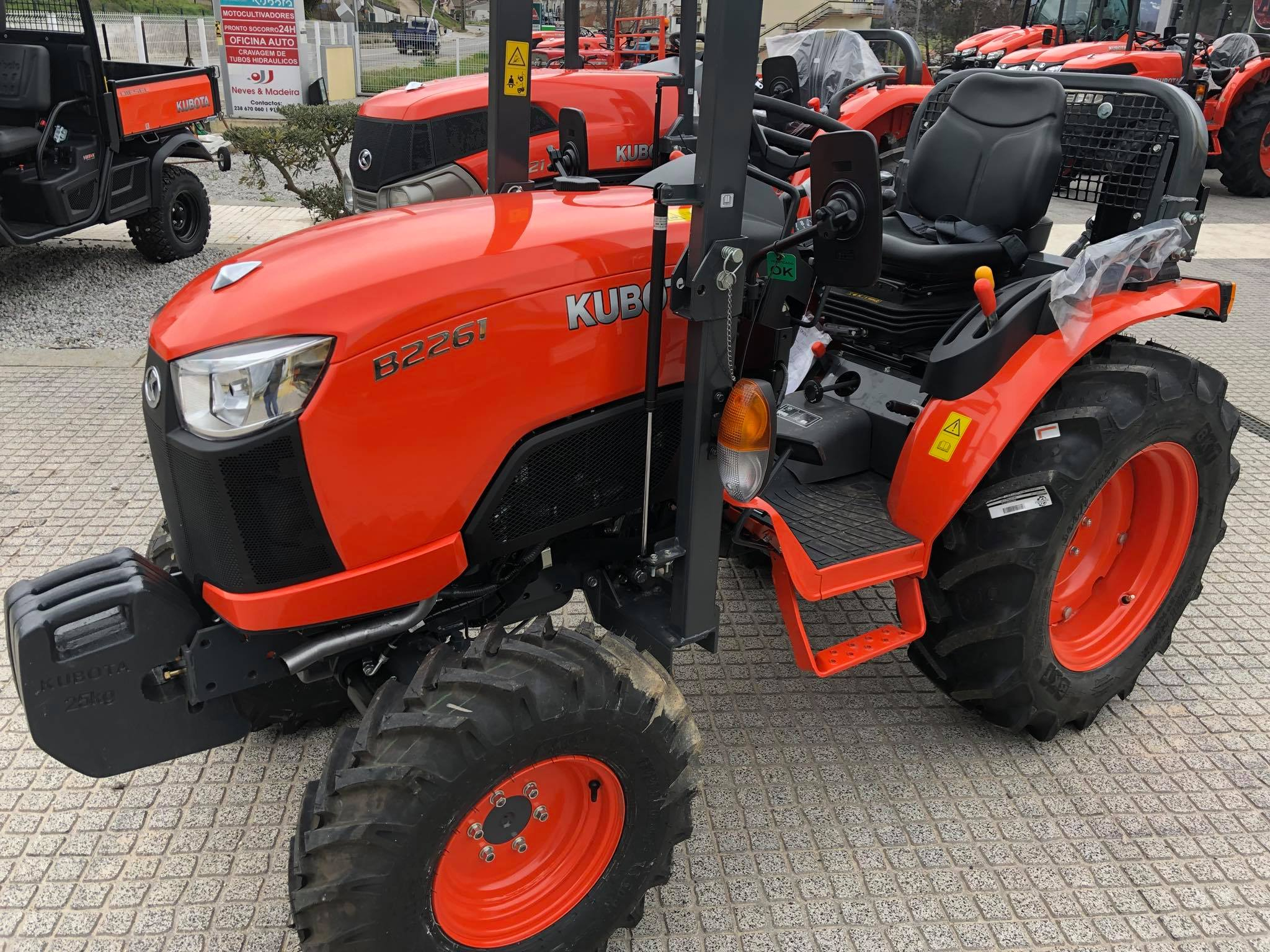

I keep watching videos and lots of people keep the roll bars down. Is there a reason this is done? Maybe simple question, just trying to learn if I am missing some performance gain. Mine are up and have never thought about lowering them.
Keep mine either in 90 degree position (i.e. straight back) or in 45 degree position. On the Kubota B, the 45 degree position allows it to go underneath my garage door without bashing it and causing $3,000+ damage and to also function as ROPS.
