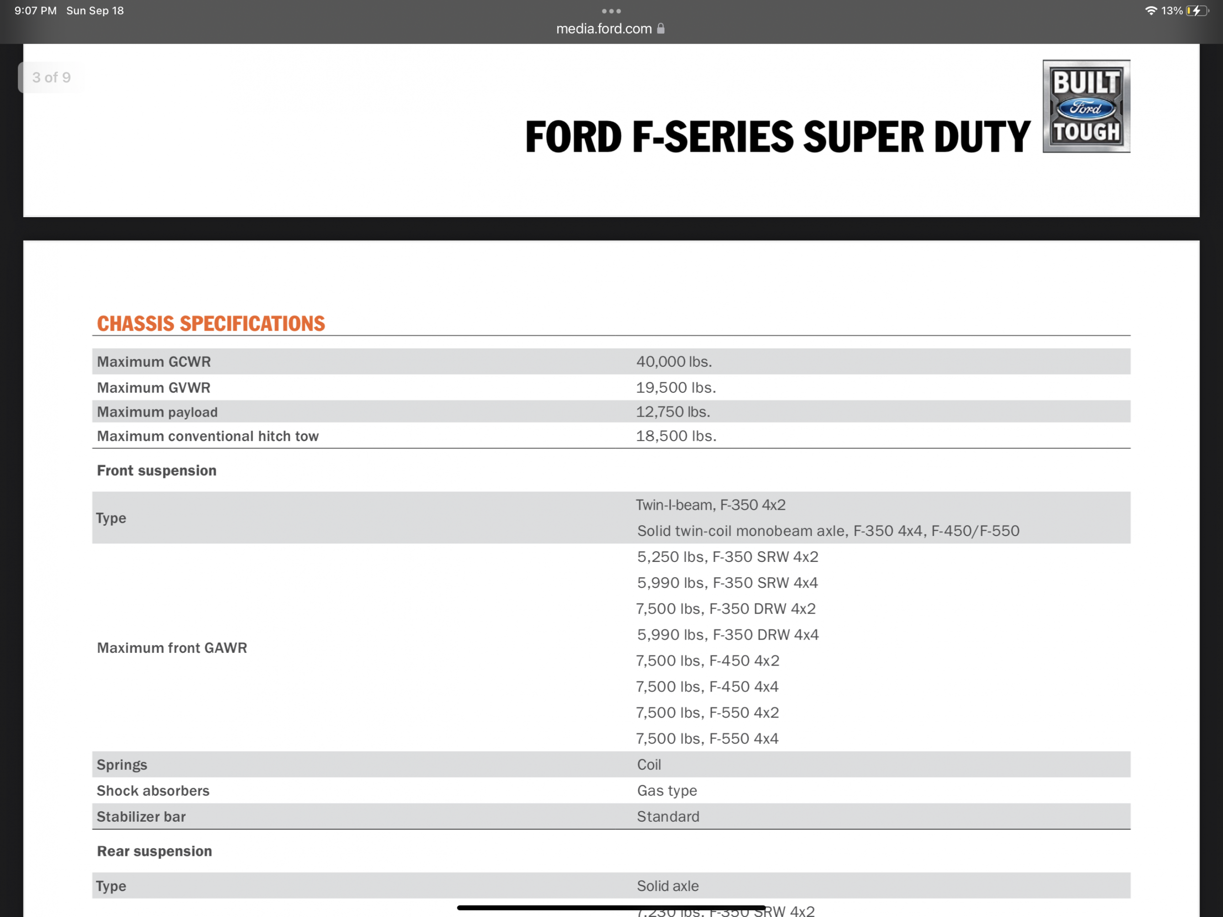

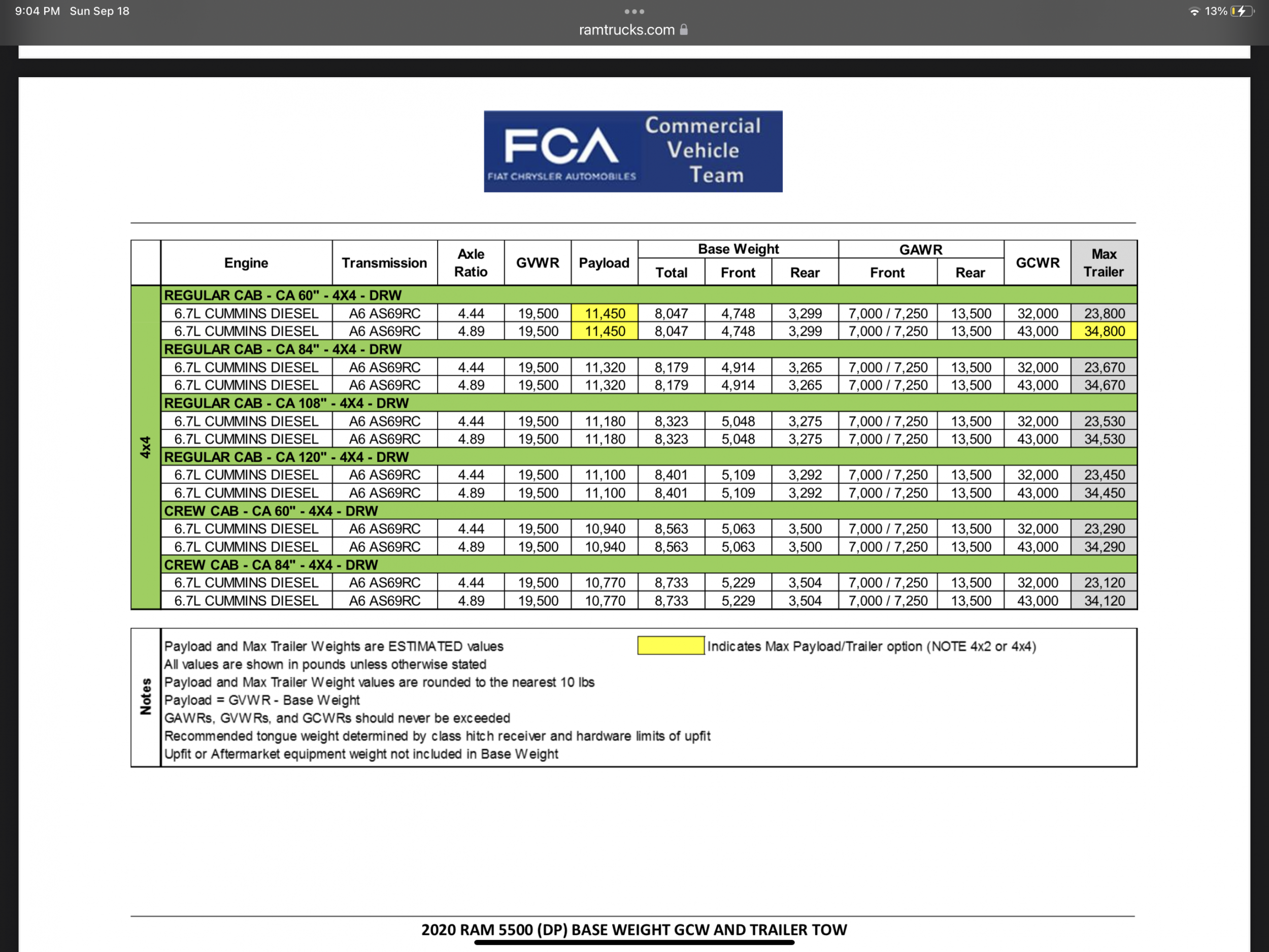

2020 Ram 5500 crew cab cummins GCWR 43,000.
2020 Ford crew cab Powerstroke was GCWR only rated at 40,000
