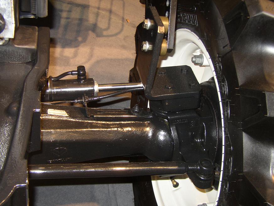

I saw four wheel brakes in hubs on TN70D on tractor fair in Italy. And this option is written in brochure too.
If I remember good, it has 16F+16R sinchro shuttle tranny.
In picture you can see a hydraulic hose going to hub.
