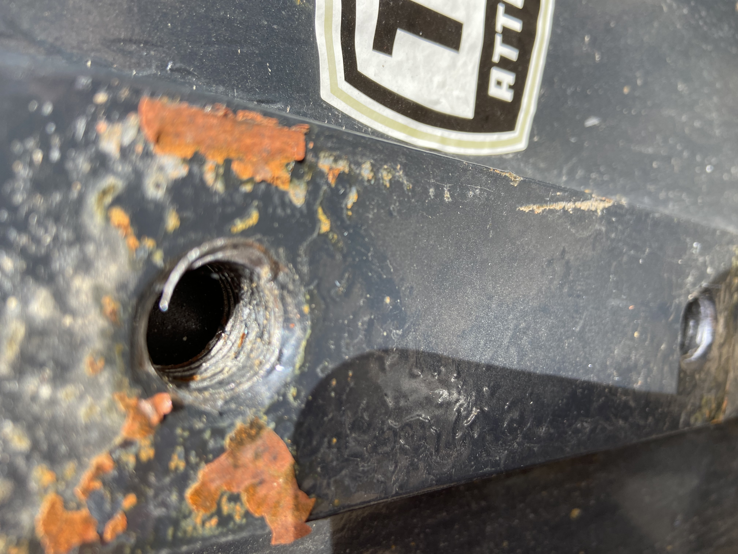

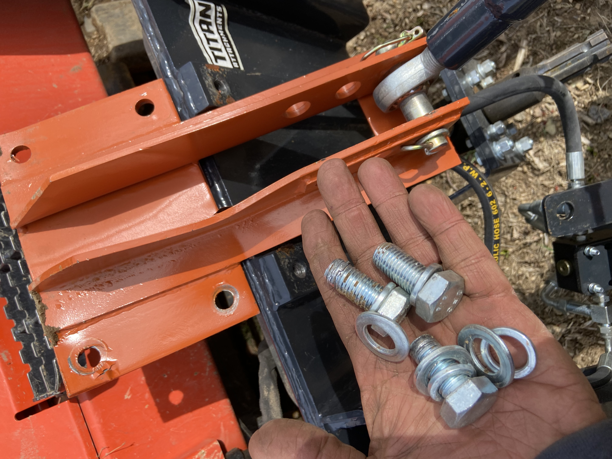

I ordered a PTO and 3 point adapter rated at 2400lbs. The first time I used it I was using an 800lb sweeper. I went over a slight bump and the bolts holding the face plate to the main unit pulled the threads out of the main body. The bolts did not shear or break, they pulled the threads out of the unit. Clearly cheap steel (it did come shipped on a metal frame with a Made In China sticker). Titan took their maximum 90 days to review, hoping I would go away, then they denied for misuse. I used it as advertised at 1/3 the rated weight. Total Junk. Their quality has gone down, this is the 4th piece that I got from them, 2 before this were sloppy fit to SSQA. Main plate damaged when it fell under unit

Did the bolts pulling out bend the bracket too?
Either the threads were cut wrong or that metal is way too soft.
how did they say you misused it, seems like you were well within spec.
