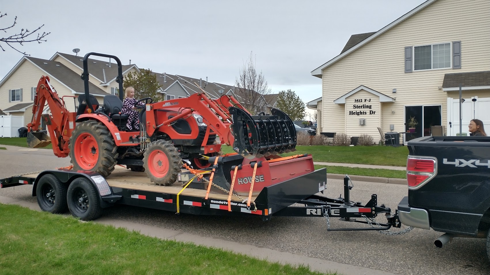

20' Rice 10K trailer loaded with everything precious to me ;)
Pulled with 1/4 ton F150 and weight distribution hitch. Rear sat 2" lower (which actually leveled the truck) and front raised 1/2" ... if front lifts any higher you have to adjust load.

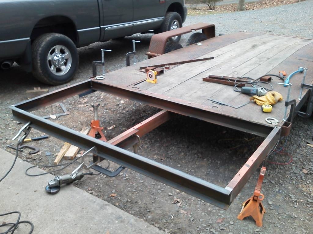

I have a 15ft open center deck car trailer that I converted to a full deck equipment trailer. The axles were almost centered (enough that you didn't need a tongue jack on level ground) and was miserable to tow empty and hard to load correctly.
I ended up adding 3ft to the front of the trailer which gave it a 60/40 a le placement and its been a fantastic trailer since.
I wouldn't want the axles any further forward then about 60/40, unless all I did was haul front heavy cars with light duty tow vehicles.
