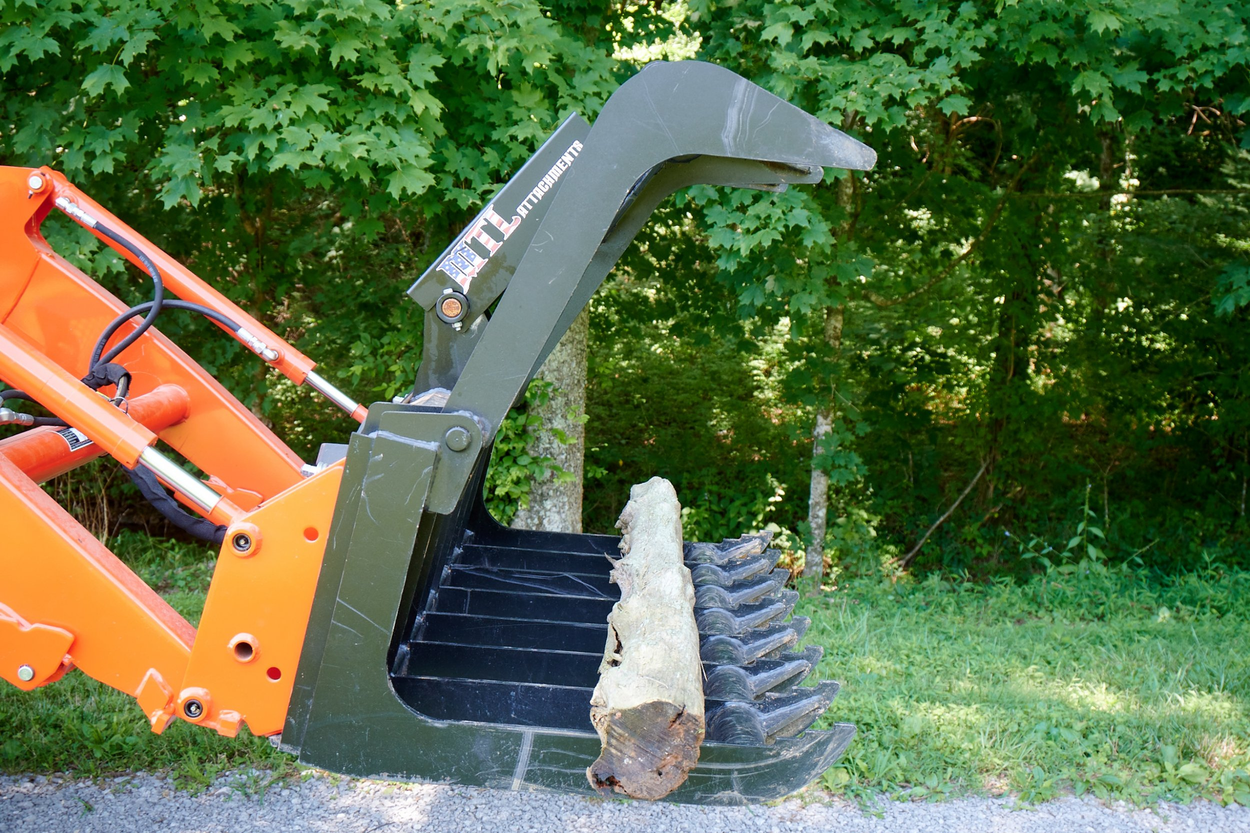

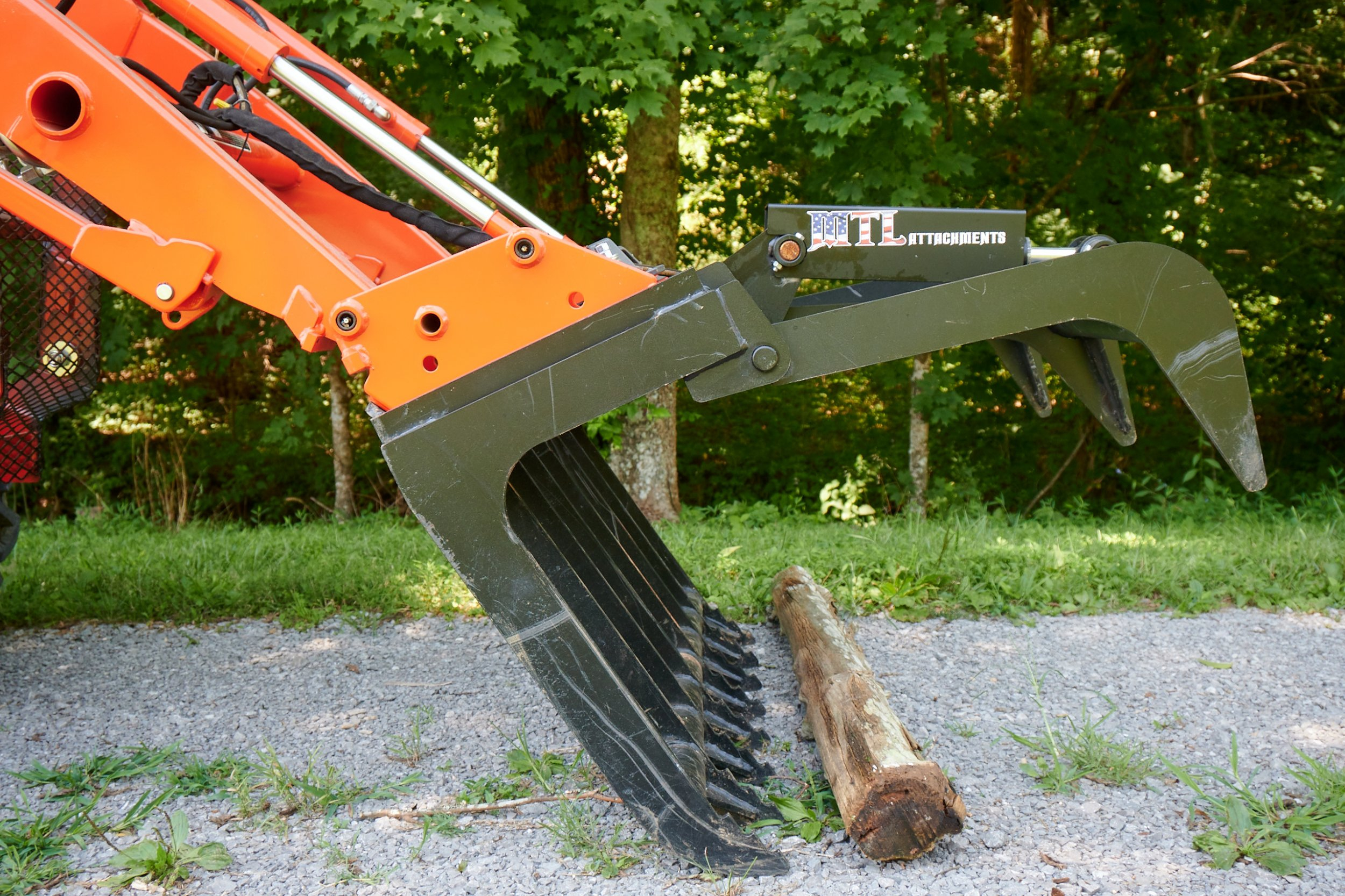

The pics showing the rod extension is enlightening. Thank you. Regardless of which grapple I get, I plan to be very careful engaging the ground (if at all) after reading all these helpful comments. Seems like a stump bucket or something similar would be better for digging things out.....
