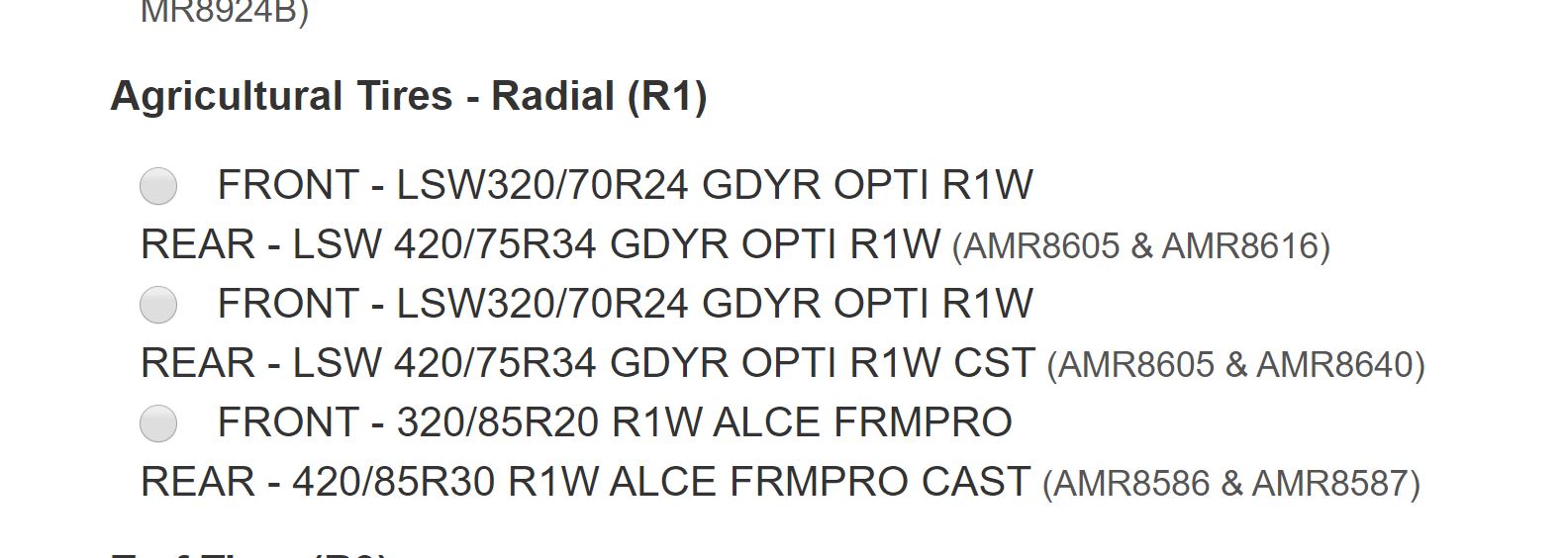

I forget once but forgot so this is a guess. I think 12X20 or 12.5X20 was the size. You need to know the rolling circumference (listed with each tire size) of the 360/70R20 and find a size comparably close. BUT, you need to double check the numbers to make sure. For that you need the "front axle ratio" of the tractor and I have the M7040 written down somewhere. It's also all over this site in various places. The numbers are to make sure the front tire runs 2% to 5% faster than the back tires. It's not as difficult as it sounds and once one of us does it, the numbers are good forever. It might already be done and posted somewhere on the TBN.

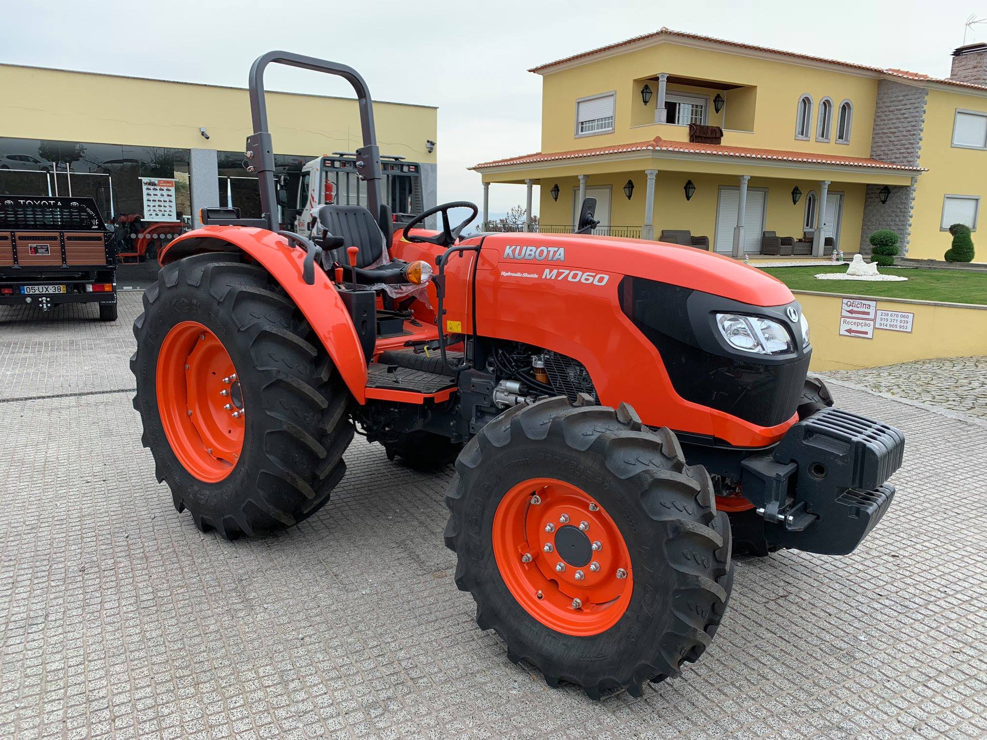

Anyone have a picture of their M7060 with the 360/70R20 on it?
I have the 320/85R20.

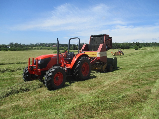

This is a typical setup over here. R1 Radial tires. I don't know the size though. Some also have a slightly larger radial tire.

That is a 320/85 also.

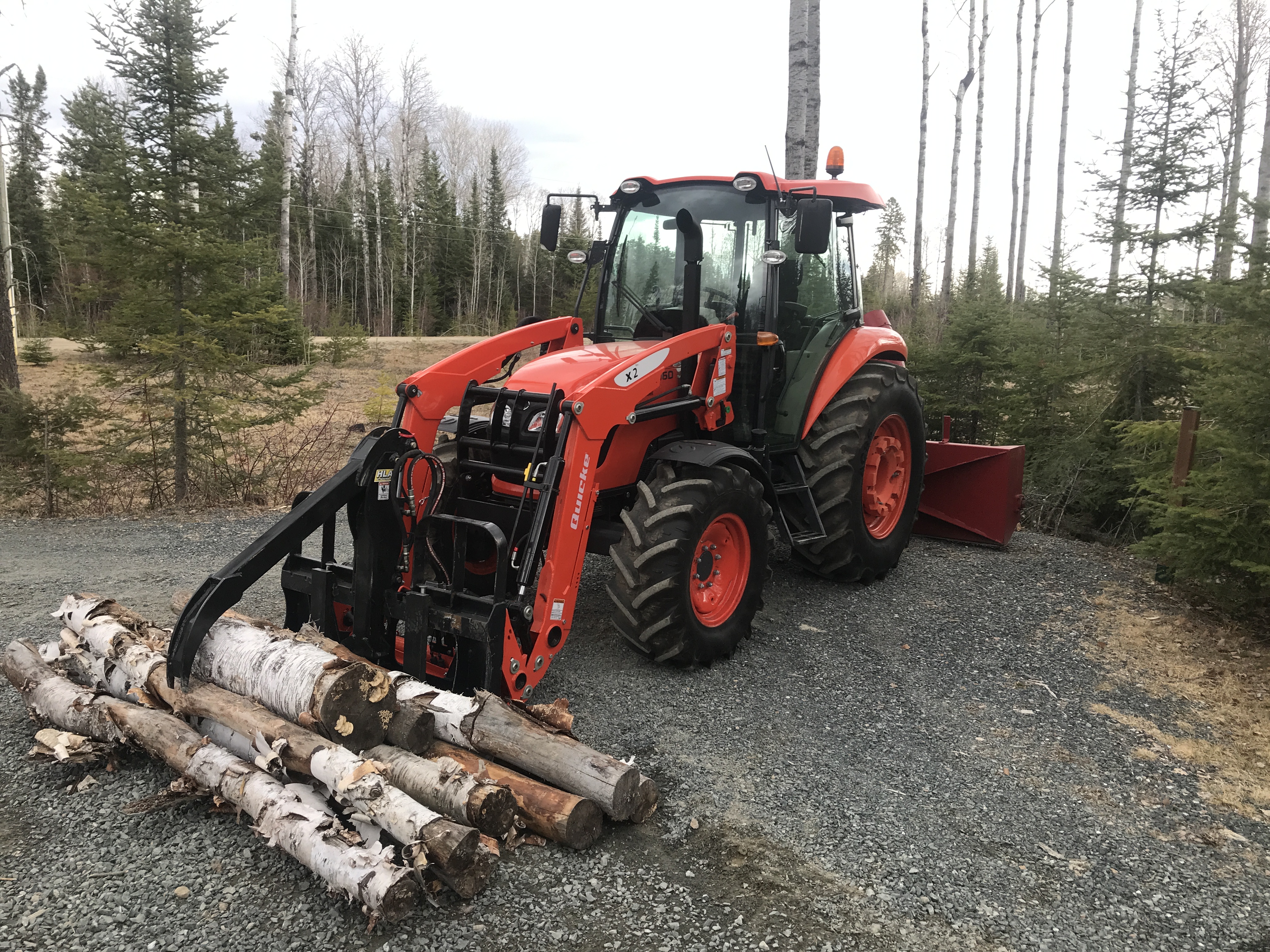

I have them on a 40, metric R1W radials on all 4 corners, they were standard equipment on Canadian market tractors. Sales lit shows narrow bias ply, every M7040 or M7060 on the lot is on metric radials.
