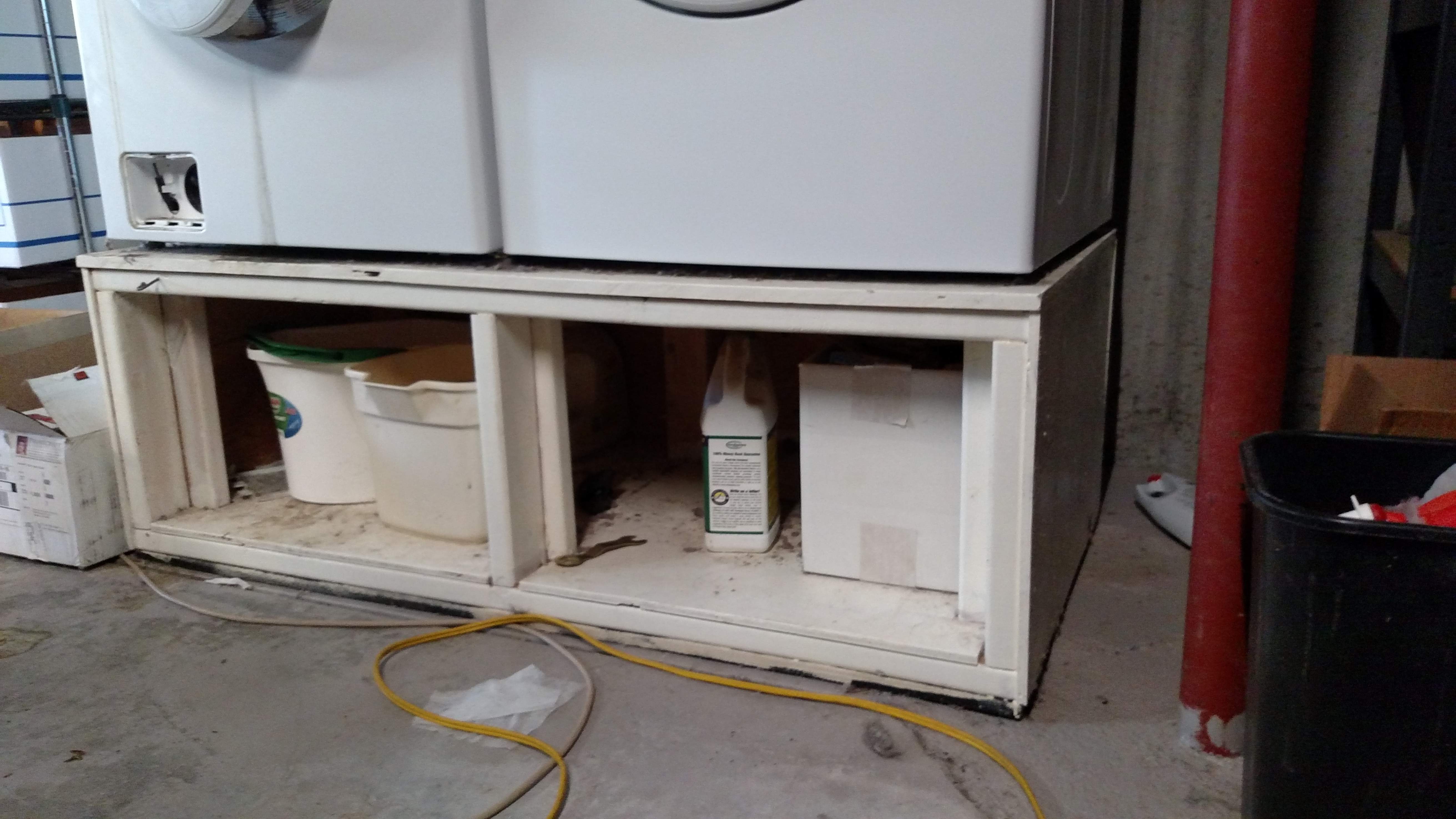

We've built boxes as proposed for basements that may flood and to ease W/D access. Second the 3/4" ply top and 10"-12" center spacing as suits o'all dimension. Wood and paint, that's it. (Also built/carpeted a few for console TVs years ago to ease watching from a recliner. ;))
'Box' may need some sound deadening (a few internal braces?) but don't expect rubber cushions to work much better than carpet would as far as stabilizing (during spin cycle, etc). Given room to jiggle a machine will do so (much more with top loaders) and try to 'walk' no matter how level or how confident that all loads will balance during spin.
Things might run more 'steadily' if W & D are mounted on the same platform. (Use a Forster bit to pocket their feet 1/8" into the top.) Weight of box and both appliances should help them stay put, with 'dampers' beneath the whole shebang. (BTDT, .. easy peasy) tog
btw: Stall mat on concrete may show dampness (hydrostatic pressure) from below grade. On a wood floor I'd expect some 'rumble' even with it. (A thinner mat'l may reduce 'rock-n-roll' vs something that's a bit 'springy'.)

Built mine out of wood. No problem with vibrations.

Some washers will walk right off a home made base from vibration. Best setup is on a bare concrete floor. If you were to build in a ledge to keep the washer from walking, and attach the base to the wall behind the washer, then you might get it done without issues.
