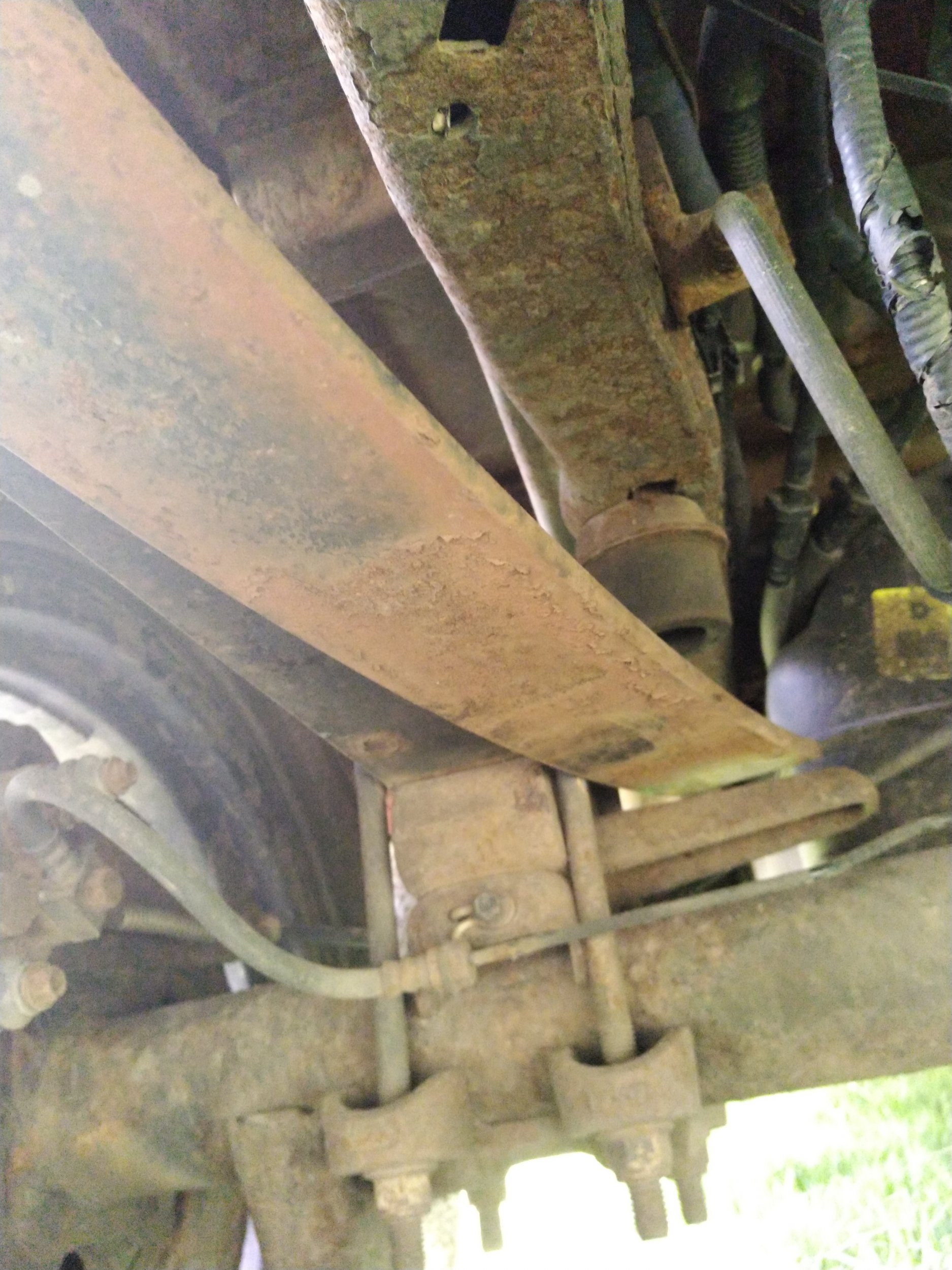

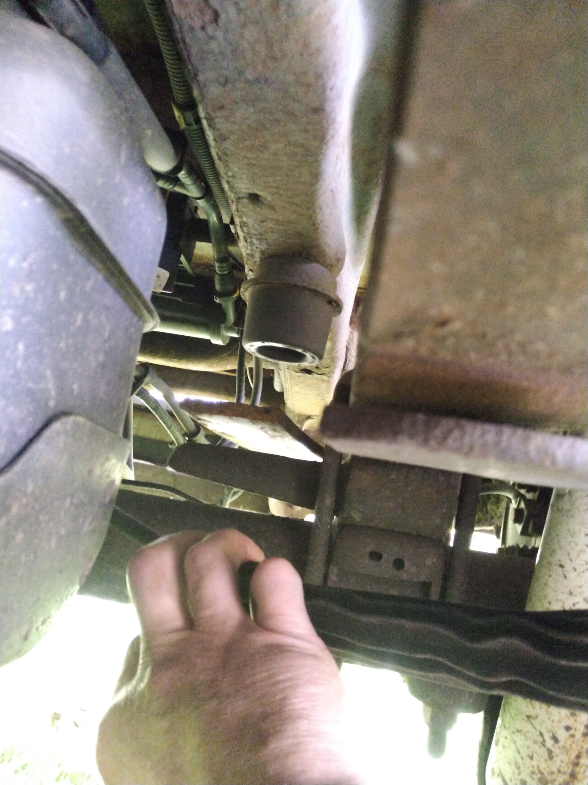

I don't drive my wife's truck much but used it yesterday to go to my dad's to cut up an oak tree that was down.
Drove good but dang, something was wrong coming from the bed area.
Got home and found a broken leaf spring.
Asked her about the noise and she said she just got used to it and I'm sure just turned the radio up.
For 25 years I've been telling her she has to tell me when something isn't right.
Frustrating.
View attachment 745801View attachment 745802
Time for new shocks...
