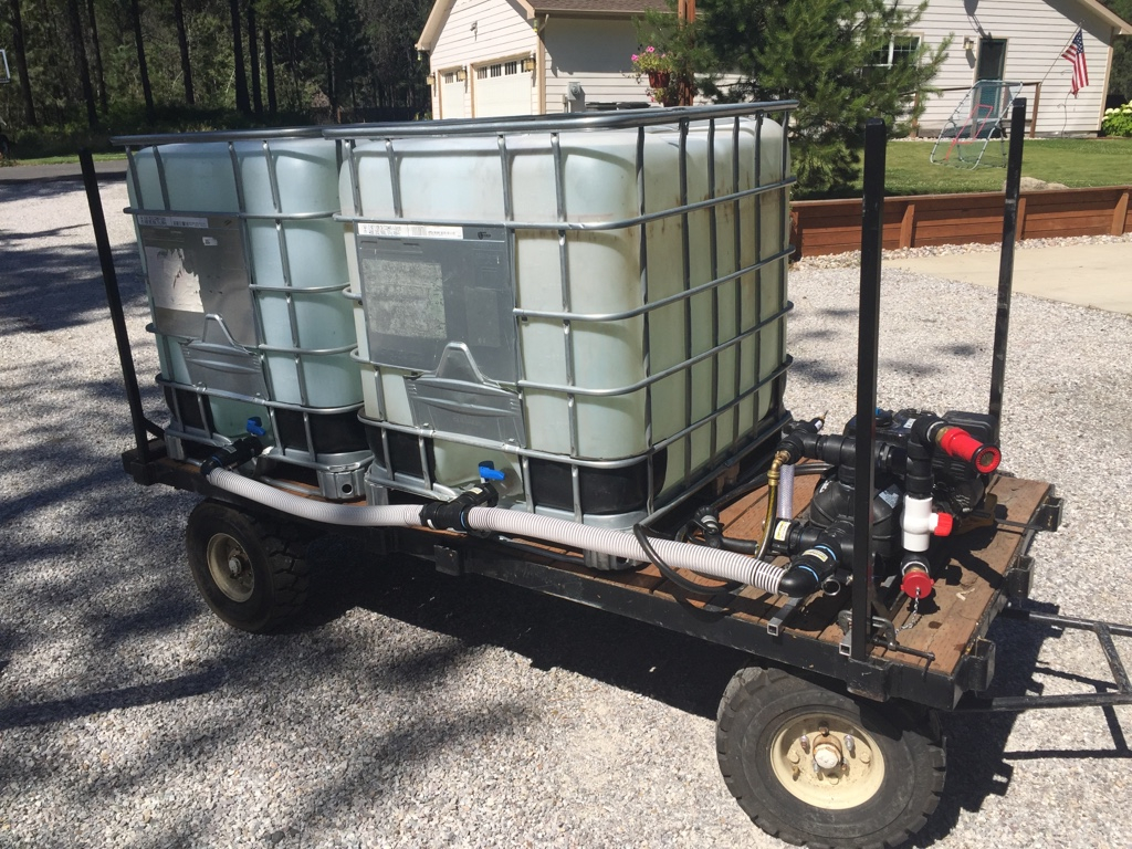

I’m almost complete with my setup using two 375 gallon IBC totes on a 7k lbs rated former military 4 x 10 utility trailer that was used for many things back in the day. It doubles as a logging trailer in the spring.
The pump was plumbed with a bypass pressure relief valve so I wouldn’t need to worry about shutting the pump off. I don’t let the pump run too long while in bypass mode.
What’s left for me to do is to add a booster reel with a 1” hose. Currently, it has a 3/4” commercial grade garden hose which puts out quite well and I could operate it in my hands while driving it (pump & roll). The icing would be a foam injection setup which would drastically increase the usefulness of this fire trailer. I also have two 100’ 1 1/2” fire hoses (not pictured) and plan to build a simple box/carrier to hold the flat hoses, shovel & rake, etc.
