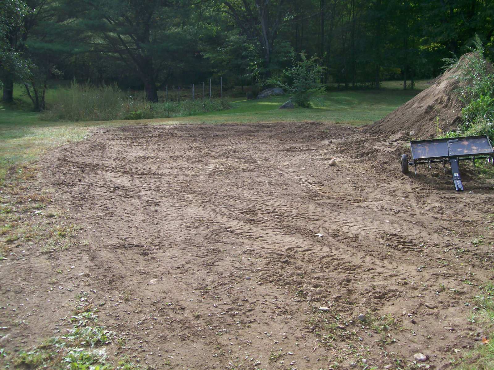

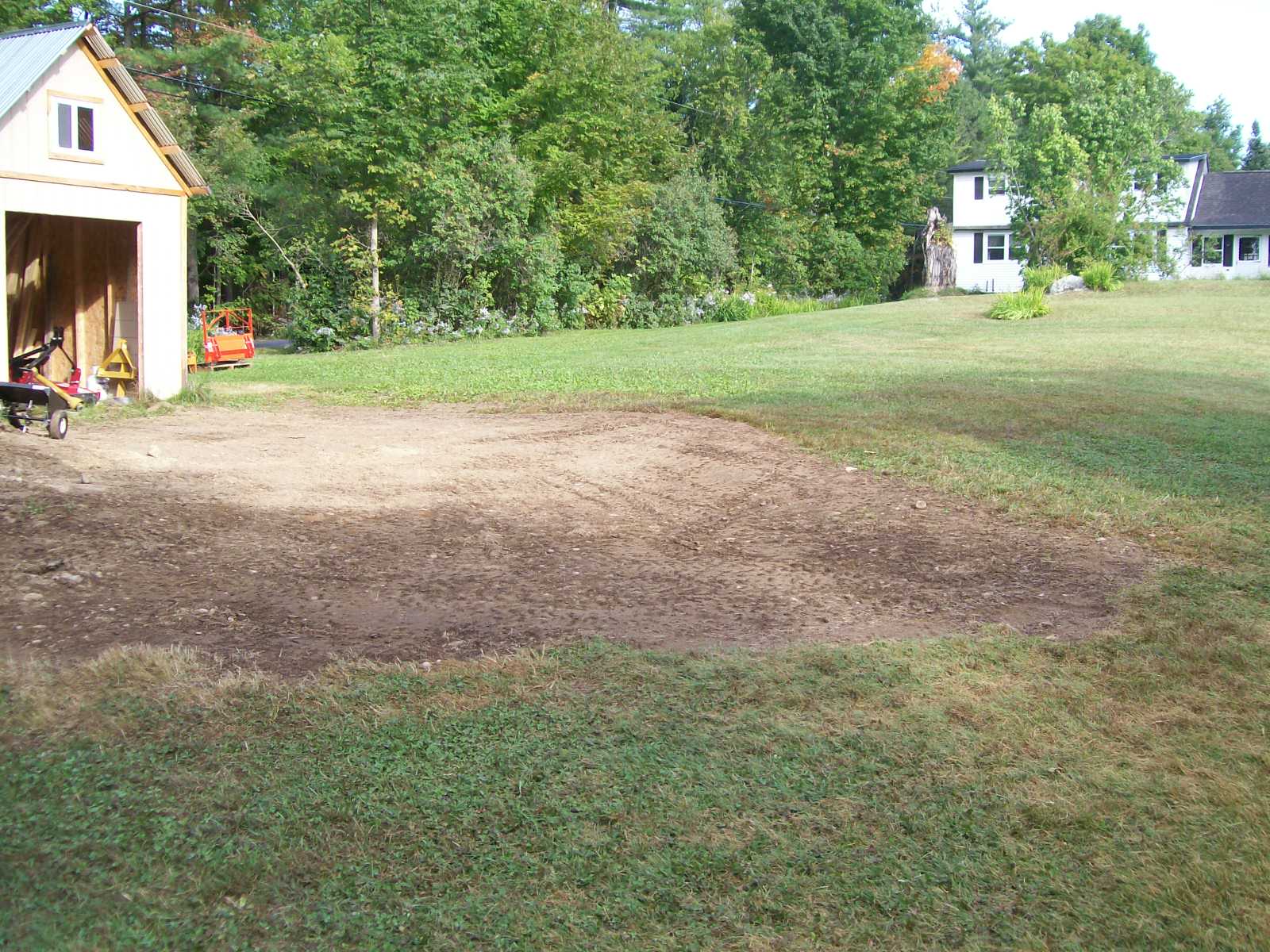

I just flattened an area for an above ground pool using a box blade. I just dropped the rippers down all the way and made a couple of passes with the blade slightly above the ground, letting the rippers loosen up all the sod, then I raised the rippers up and pushed the sod out of the way in one pile, went back and moved the dirt. the pool pad was on a slight incline, I removed about a foot of material on the uphill side. It was a very easy process even with my little tractor. I think it would work very well for your application.

Here are a couple of pics of a small swale that I made with my 4' box blade. I actually started it with the loader, but the BB does a much smoother job. So far I've found that it cuts the sod pretty evenly along the edges as you can see.

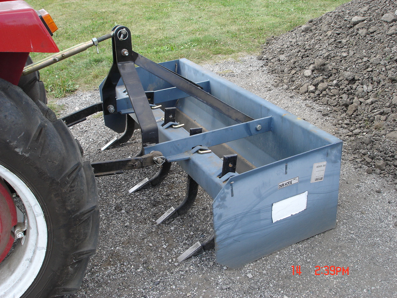

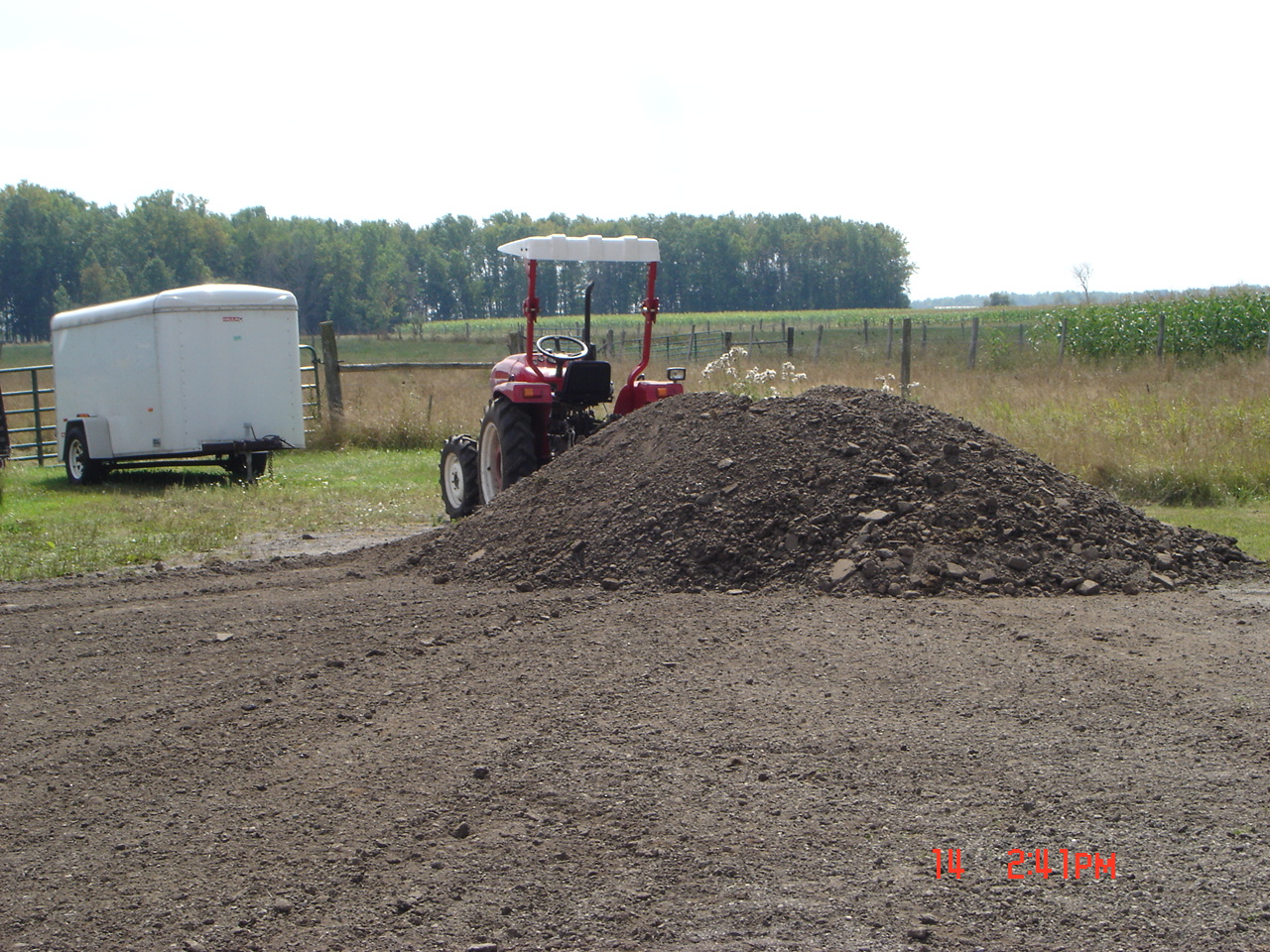

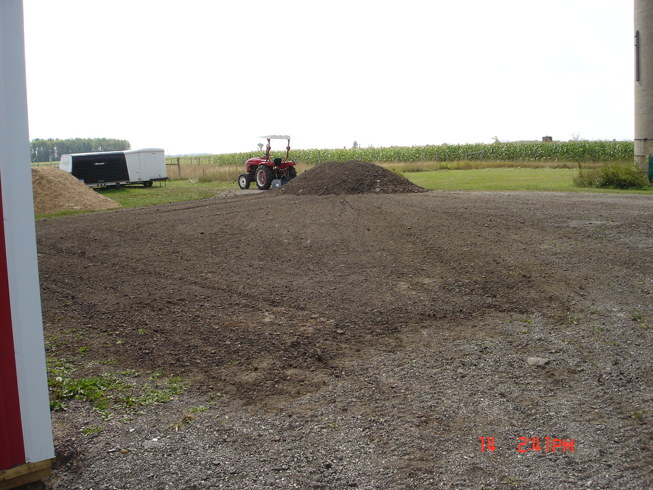

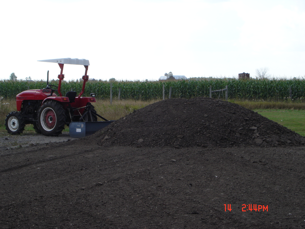

I bought my box blade brand new for $199 at Tractor Supply, it is a Dark Horse brand marked down from $300 Some TSC stores have these but most don't they were test marketed in the mid west. TSCy might be able to ship one to your local store at no cost to you. The TSC store in Ionia Michigan is where I bought mine. They had both the 5 foot and the 6 foot in stock. The 6 foot was only $249 but it is to large for my tractor.:(
They have been sitting there all summer. I can't imagine why, mine works great. It looks identical the the $550 blade that it was sitting next to except for the color.:D:D:D
Ask your dozer operator if he can do the job for $100........if not have your local TSC store make a couple of phone calls on your behalf and see if they can get you a blade. You will love what you can do with one of these things.
The pile of recycled asphalt in the photo is what I moved in a couple hours with mine.....
