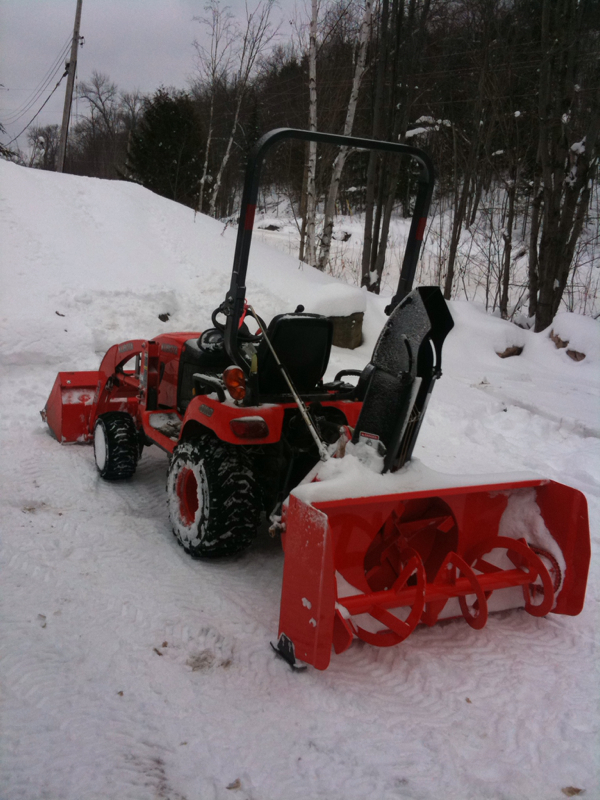

Yes, the BX will plow snow. How well depends on your perspective. When compared to a riding lawn mower with a 3' blade, the BX will do amazing things. When compared to a 60hp, 6000 lb, tractor with loaded tires and chains, the BX is rather disappointing.
In my experience the BX will really shine when it can use all 23hp. Since it just isn't heavy enough to transmit the power to the ground, especially on slippery surfaces, I bought a rear snow blower. Being on the back has it's disadvantages, but it balances the weight nicely and allows the loader to stay on the front for removing slush or ice.
The picture below is from last year. The snow was ~18" deep, my wife is driving. The only thing different for this year was the addition of tire chains to help with traction on ice.
On Sunday I used the blower to remove some snow drifts that were 100' long and 2' deep. It cut a path 52" wide in one pass, no stopping and no ramming. It created no banks and left no piles. I'll never go back to plow...

What brand rear snow blower do you have on your BX? Is it 54"?
