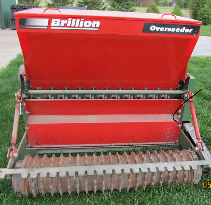

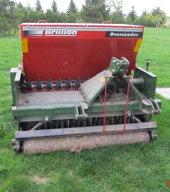

So, what's the implement? What are the dimensions? I know you posted the weight, I'm just curious about how big it is and where that weight is centered.
Glad to hear it'll do what you wanted.
It's a Brillion slit seeder and heavy as a bear.

It will be fine if I take it easy and watch myself on any turns with the implement up. This puppy is really heavy and a good lesson that a tractor may be able to lift a given amount of weight but not be able to navigate real well with it off the ground. I can see how newbies could get into trouble.
In my case the tractor may be rated at 2300 lbs of lift two feet back from the link ends but for all practical applications I would say 1800 or maybe 1900 lbs is really the max I would want to put on it for a field appliccation.
