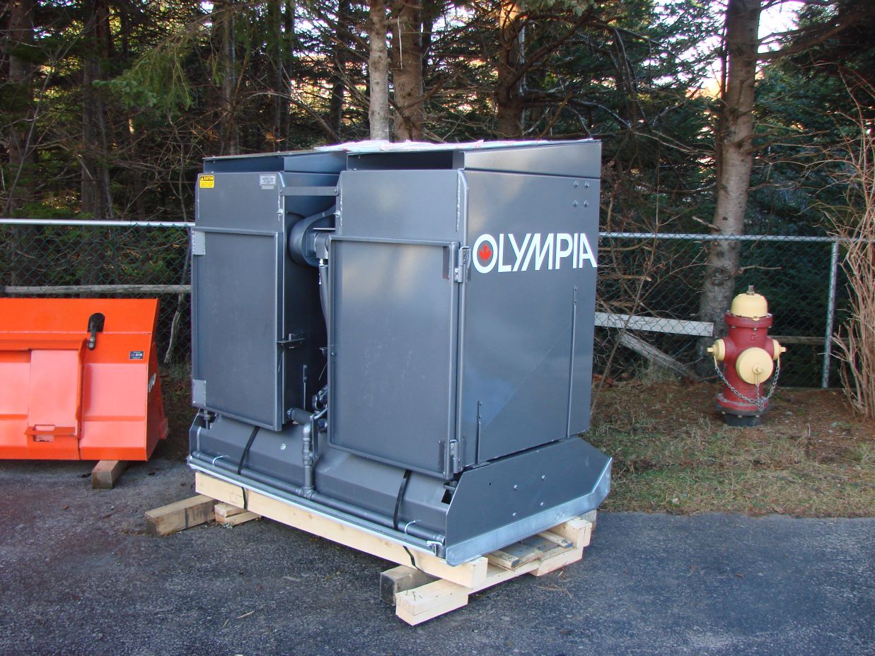

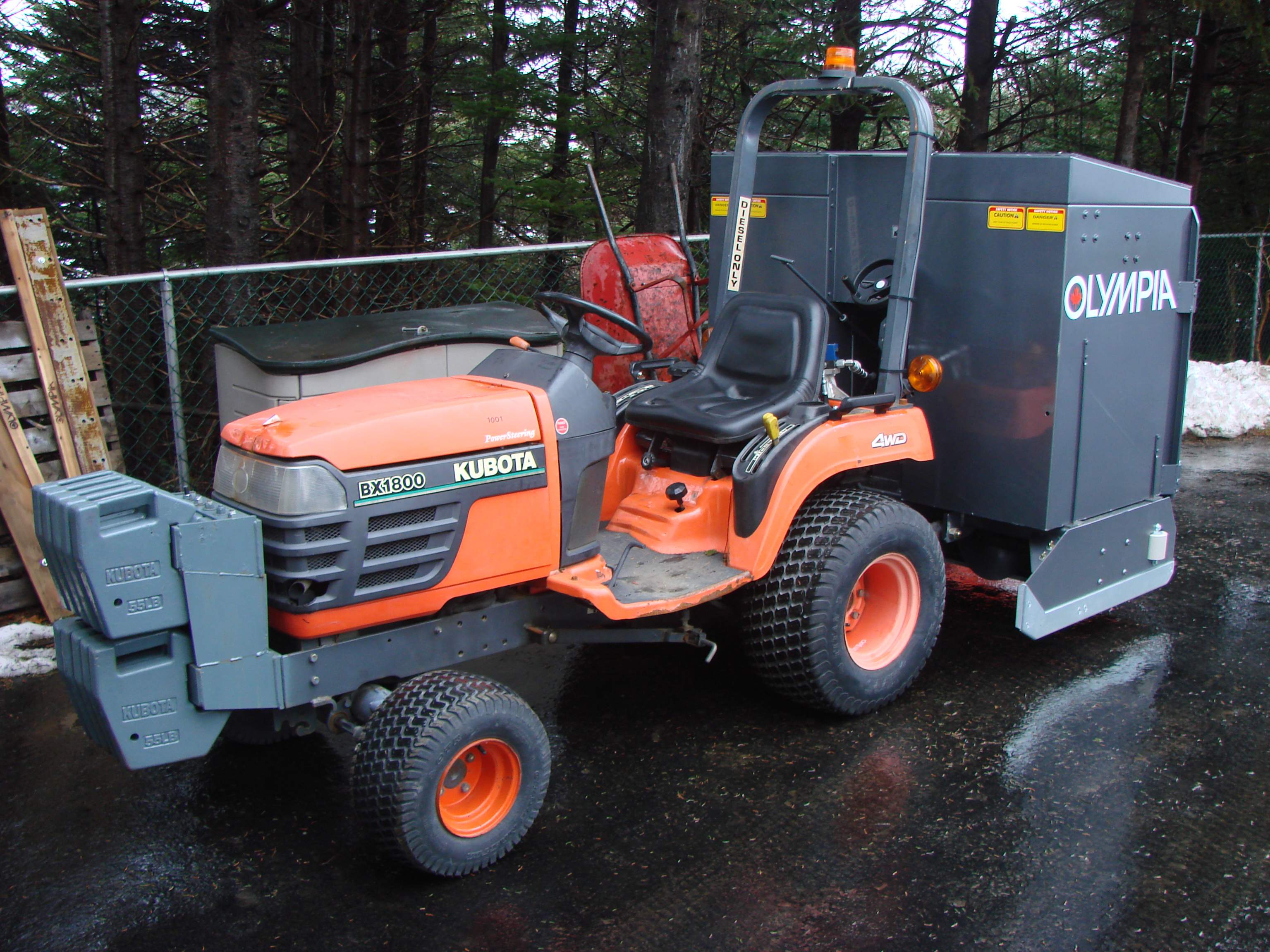

There's wiggle rood for sure. I adapted an ice resurfacer to a BX1800 a few years ago. The resurfacer was over 1200lbs. Had to add some extra front weights but it did lift it no problem. It didn't lift it when the water was added so that's when the mod started to help it lift. Yup. There's wiggle room. :thumbsup:
