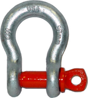

You know how the drawbar has a large diameter hole on it. I'll be attaching a hitch ball to it. I will then use that to attach the hook on to. The hook will have a trailing chain which will pull logs.

The ball will be handy, for sure, if you want to move trailers and so on. My experience, though, is that your chain will fall off with some regularity. But perhaps that's just my poor technique.. I often have to back up and get another angle on the pull, and having a chain with a snap hook which can't come off without humanoid assistance is easier. Your idea will certainly work, although I wonder if it's really optimal for what you plan to do.
You can also just stick the hook end of a chain through the hole in the drawbar.. for quick and easy jobs.
It's been so long since I've posted here that I hope I can still remember how to attach a pic! /forums/images/graemlins/blush.gif
Regards,
Bob
