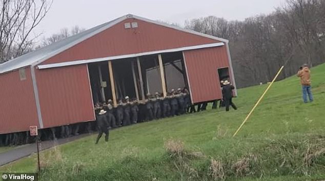

Put poles under it and get a bunch of Good old Texas boys to lift and walk it. 50D4059B-E7E5-473F-B58D-67A325F1A9C3.jpeg

Don't pull with a V hook up. Put a spreader bar in, then do the V hookup.
What he said...
I'd also see if you could dig shallow ramps under the 4 skids at the end you want to pull from, and slip some greased boards under the leading edges and up the ramps. That'll help it clear the initial hump to get it out of the dirt, depending on how far down it's sunk over the years.
/ Will this tractor move building? #31
Completely empty the building. Jack up and use telephone poles as rollers.

When I moved mine I hooked chains from the ends of the bucket to the skides to act as a spreader bar, lifted the building slightly and pulled it backwards to to its new location.
/ Will this tractor move building? #36
I don't think you acknowledged the best advice you received which is to put round logs under those skids so that they roll as the building is pulled. You should be able to pick up a few 16 ft or 18 ft logs. I use treated fence posts because I have them. Someone also mentioned a spreader bar - you will need that too so that the chains aren't trying to pull the skids together towards each other.

Friend moved a 20 ft loaded shipping container with a 60 hp tractor so I think it can be done.
Lift if possible one corner at a time and slip in some HD planks to slide it on and push.
Wet and oiled planks will work best.
/ Will this tractor move building? #40
Rollers are a beautiful thing when moving heavy stuff, especially when trying to turn. I've moved shacks and equipment using all diameters from water pipe to rounded wood fence posts. I 've watched buildings being moved and lifted including my own. One problem I have personally encountered on do it your self projects you try and really go cheap on the prep or process. Pros don't go cheap and use the right stuff for the job. Rollers and spreader bars and jacks. Once you get the initial inertia overcome, how smooth is the ground and how tight are the quarters? You've got all winter to think abouti if you don't go ahead on 'er. now
