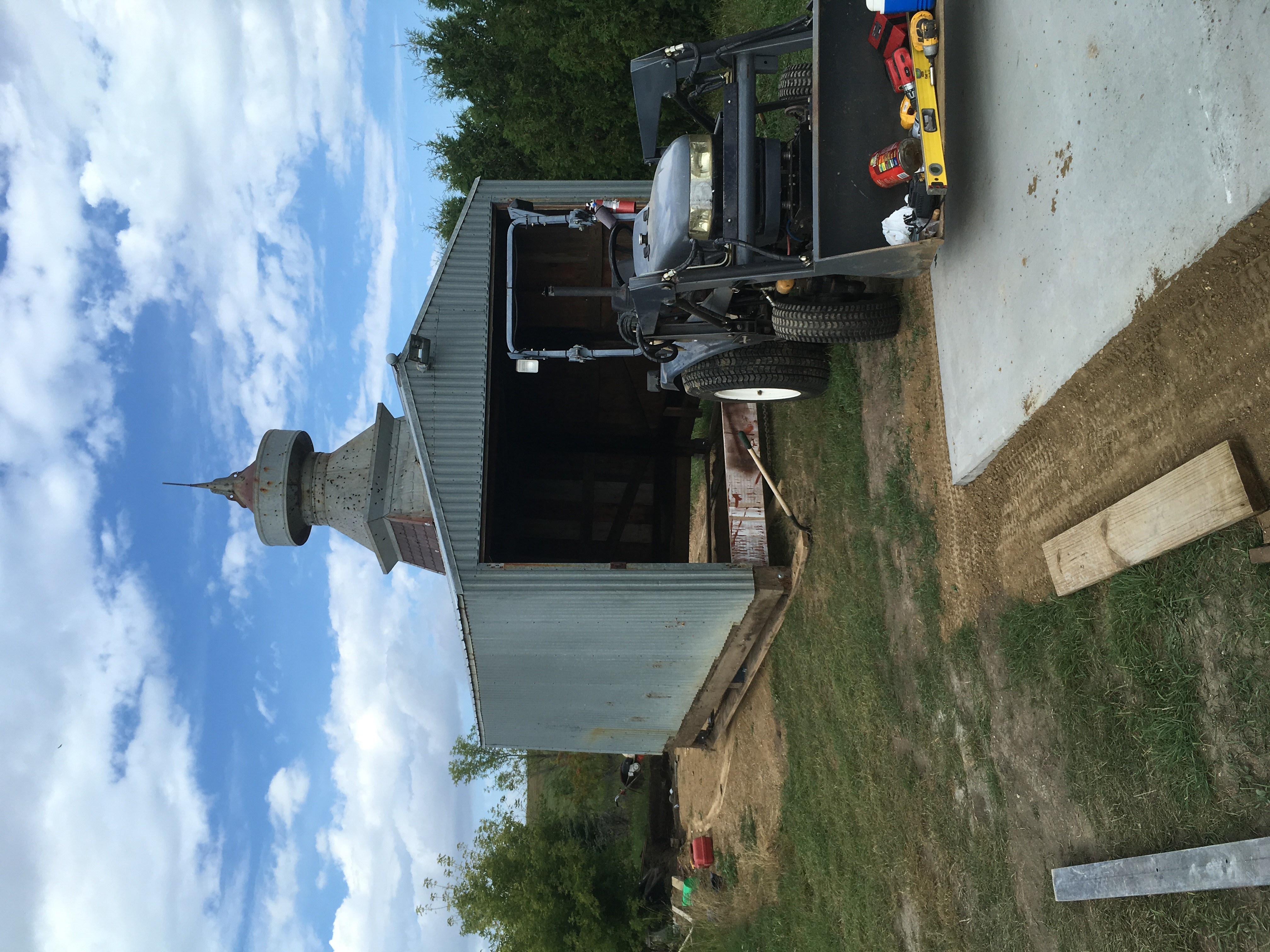

I moved my 14x16 tractor shed twice. First time about 8 miles on a trailer, second time dragging it on the plates on gravel aprox 80 feet up onto a cement slab. Braced the door opening down at the plate with a 2x12, ran chains under it to the back wall corners, bent a scoop out of old pole barn tin to tuck under the back plate so it wouldn't bulldoze, hooked it to my 28hp 4x4 tractor and pulled. I used the 3 point drawbar so I could lift some on the front wall where the chains ran under that 2x12 brace. Even my wife said it was easier than she thought it would be. I just put in creeper gear and it walked away with it. The gravel was the key I think as it is a heavy building made from 7 RR ties and sheeted with 1x12's then covered with tin.

Ok I gotta ask..... what is that structure above/behind your shed?

Yup. I have a thing for "cupola"s.
I had a moisture issue inside when it had a gravel floor and I always liked cupolas so I found one on a barn that fell and installed it. Cured the moisture issue immediately. Apparently they are designed to produce a upward draft to dry the hay in the loft. It also dropped the temp inside in the summer huge. I also have one as a lawn ornament, (wife won't let me put it on the house :laughing:) that doesn't have the added 22 caliber ventilation. That one has the full lightning rod/porcelain ball/weathervane top. Very cool looking. Would love to install the same on top of this one, but people think they are made of gold now.

Look up how venturi works and you understand barn vent cupula.
Lightning rod on top NOT good idea unless grounded right. Might convert barn to charcoal.
