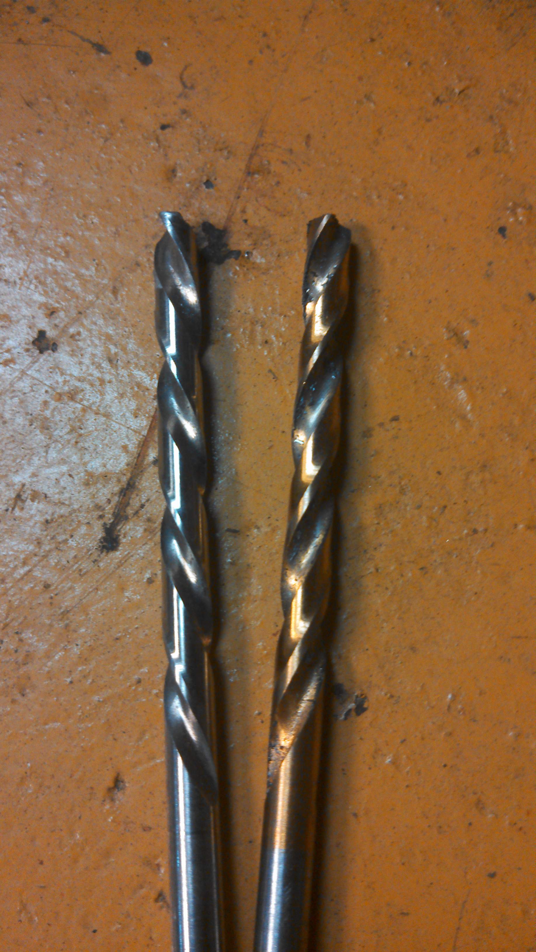

If its "way down" in a hole, like a broken cylinder head stud in a Mercedes block, I use left hand twist drill bits like the one ont the left in the photo below.
With those two "tricks" I don't remember the last time I used an easyout for anything except broken pipe fittings.
Once you break off an easyout you have just made the job MUCH more difficult.
If you do try easyouts or LH drills don't buy cheap ones, if you don't have one of these http://www.electroarc.com/ or a TIG and Hastelloy filler rod.

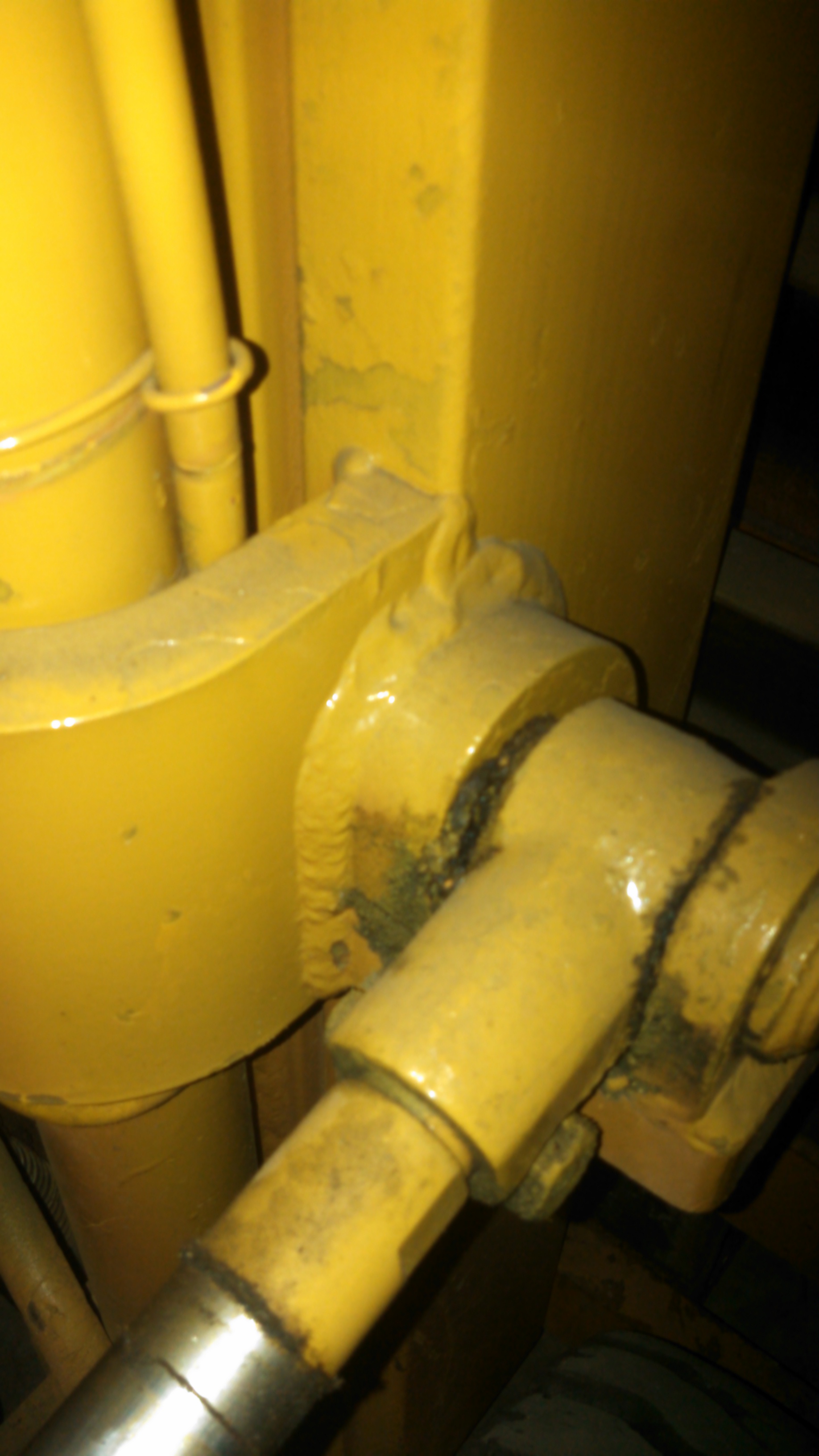

Some times a "solid" weld can also weaken the part. The OP's drawings don't show intentions of welding the ends of the gusset but if there were length wise loads a weld would just make a shear point that was not there before. Plug welds or nothing at all would be better. Like the attached Komatsu forklift tilt support. They knew, from experience or testing than the mast lived better without welding everything.

   / Will this work? If not what will? #25

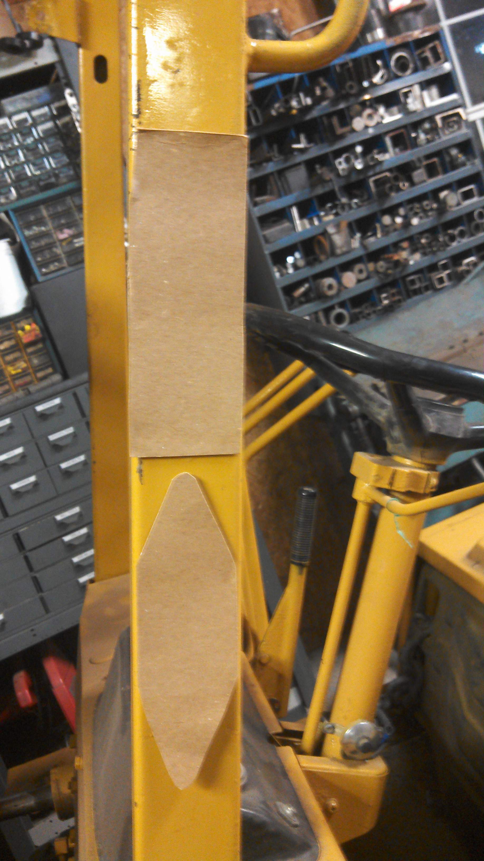

If you intend to fully weld a support at least try to not create a stress riser in the part.
For instance, The lower, tapered pattern would be much better than the upper gusset and the upper would be better welded only length wise than length wise and across. It's not just about making a good weld but where to put them.
