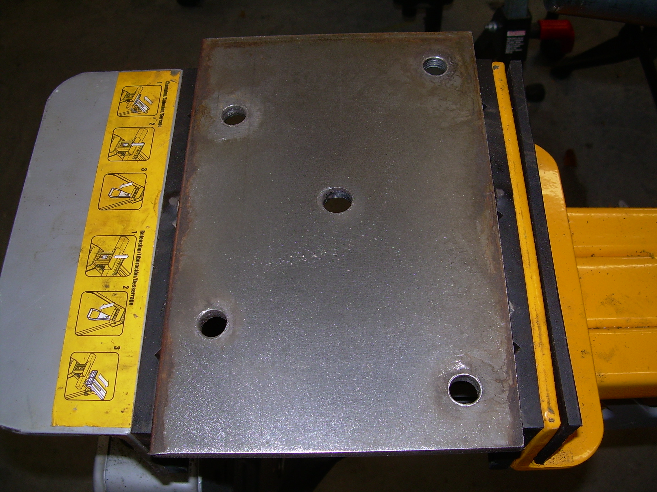

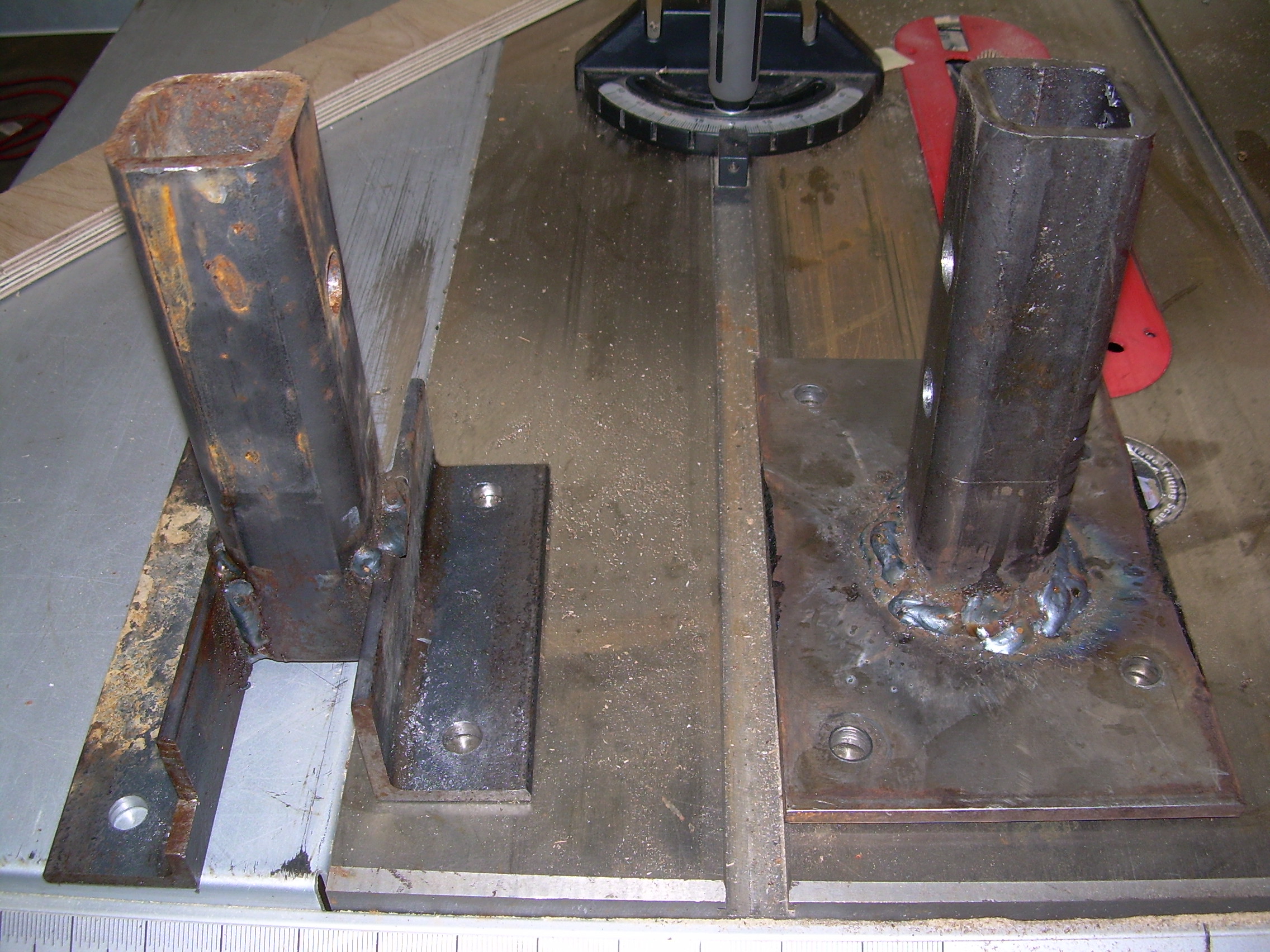

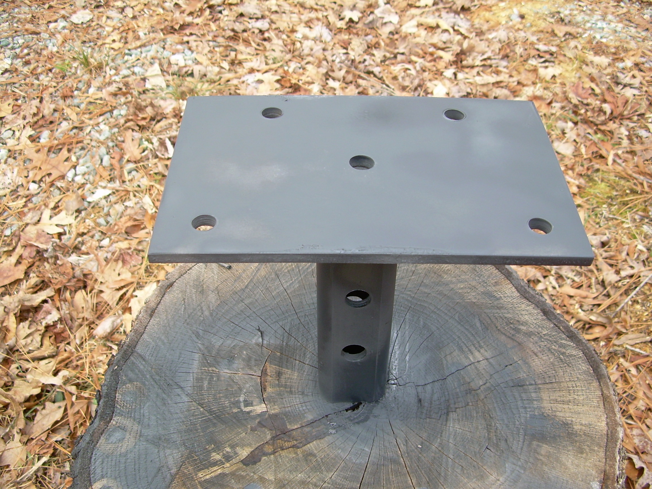

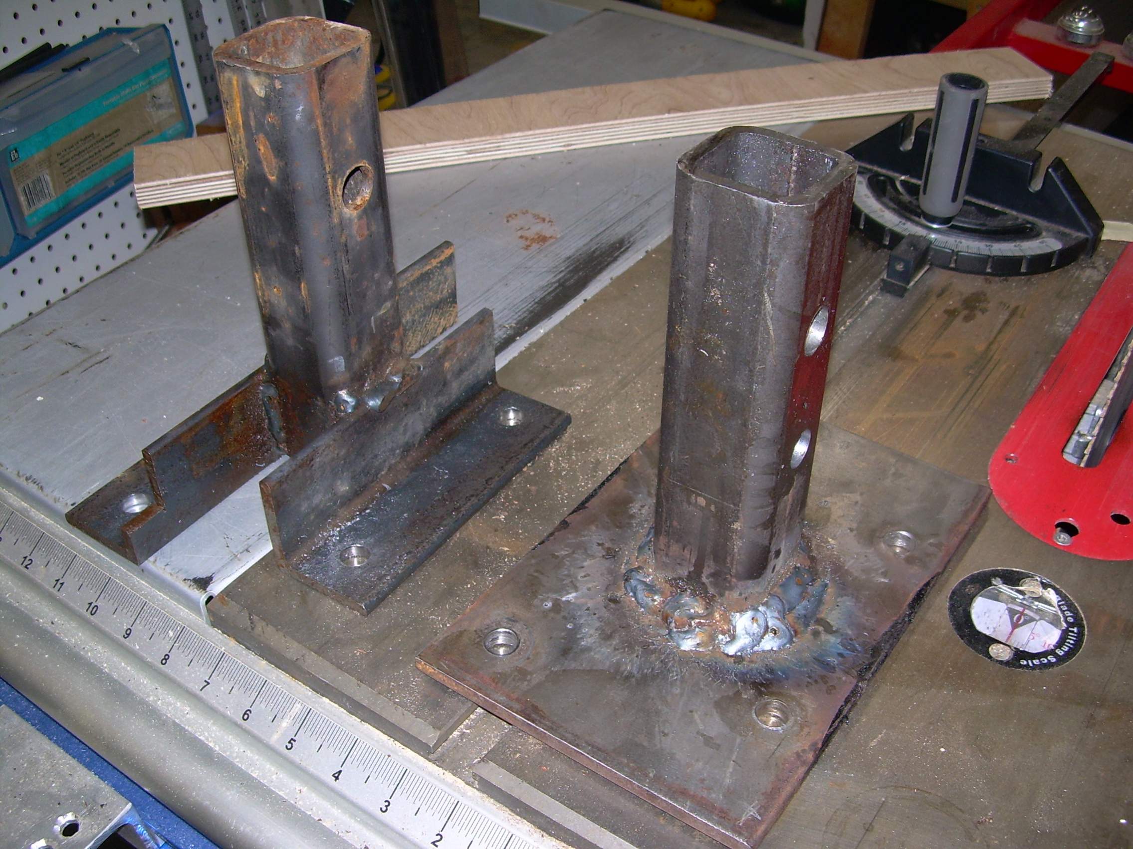

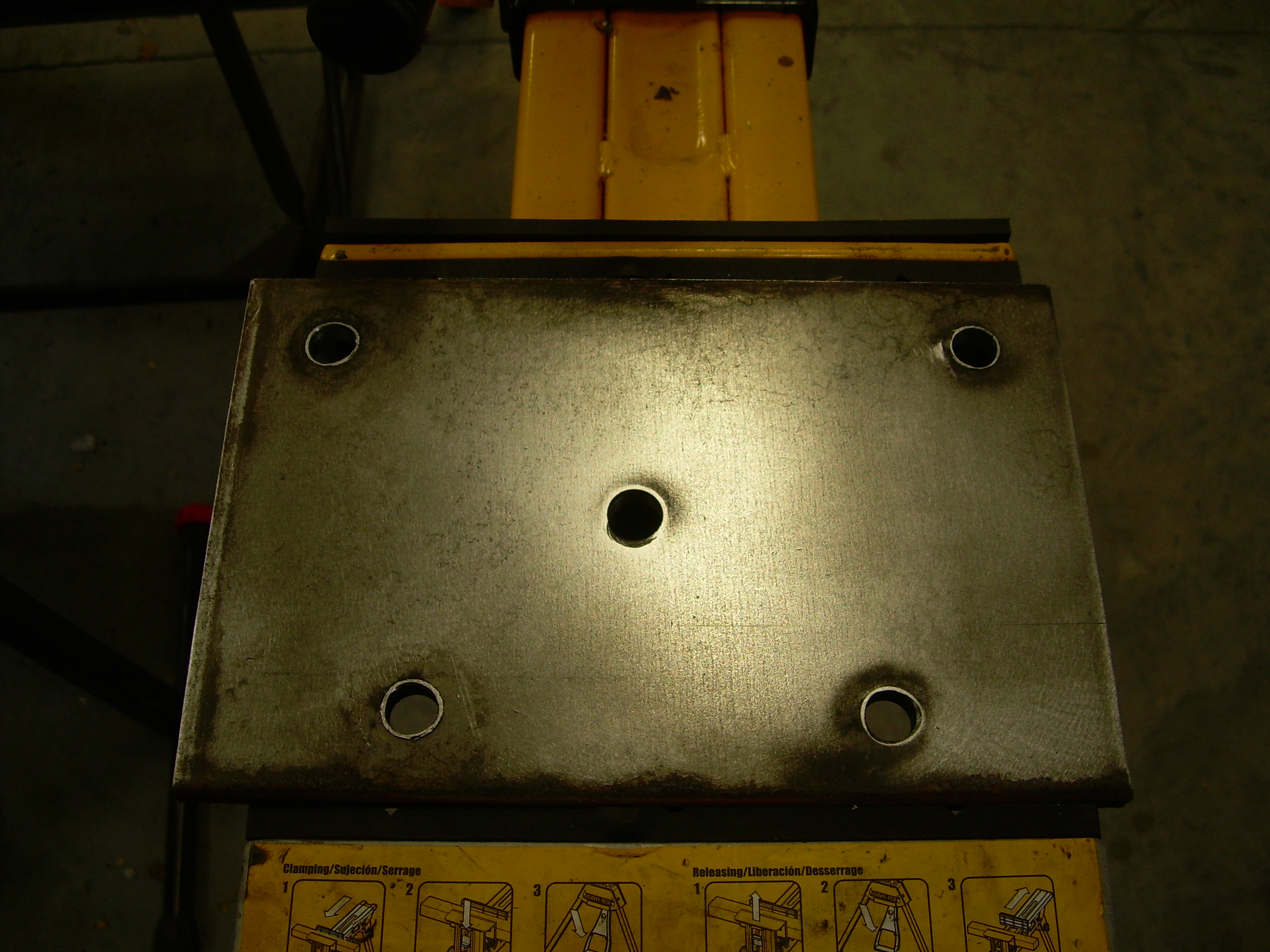

Attached are some pictures of the new base bracket for the winch. With this and adding a new receiver pin hole, I can reduce the length of the assembly by about 3 inches.
I added a 5th hole in the base and into the winch backplate. I then welded a nut to this hole in the base. The male 2 inch receiver post is welded right on top of this (just covered it not actually welded to the nut). Just a little extra strength where the forces are greatest.

Well I just tested it out and it works very well and is easy to use. I have the following options.
1. I can set the valve at the back to reel, stop, or unreel and then at the drivers position use the aux PTO to engage it.
2. I can lock the aux PTO to down (must be down only) and operate it from the back.
3. I can disconnect the valve in the back and operate it with the aux PTO in both directions from the drivers seat.
It is a lot easier to use now since I can watch the winch cable and operate the controls. J_J, I timed the reeling in starting with the cable fully extended. It took about one minute. The cable is supposed to be 50 feet, but I did not measure it. It seems plenty fast to me and while I did not measure it the engine speed did not seem to have a big effect. I don't understand that, and it could be an illusion.
Again, thanks to all for the many comments, suggestions, efforts and patience. I really did not expect to do this much, but I am a lot happier with the winch than before.
