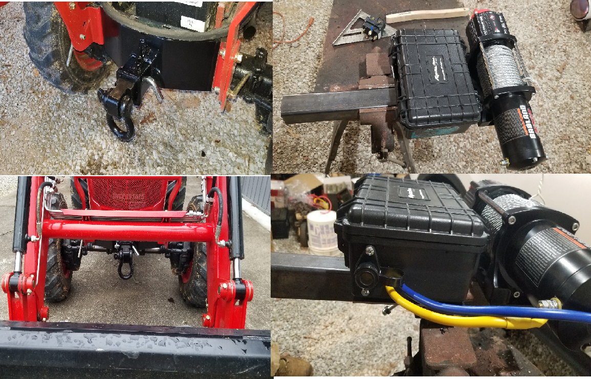

My CUT rear weight incorporates a hitch receiver tube.
I bolted a fair sized winch on a plate that I welded onto a 2" tube.
Also installed an Anderson plug for power.
I haven't needed it often but sure does the job whenever I wish to retrieve something and or pull myself out of a jam.
I've also retrieved a fair number of trees for firewood.
Only downside is current draw vs battery and alternator capacity so that needs monitoring.
OK for occasional usage but for sure not serious logging operations.
