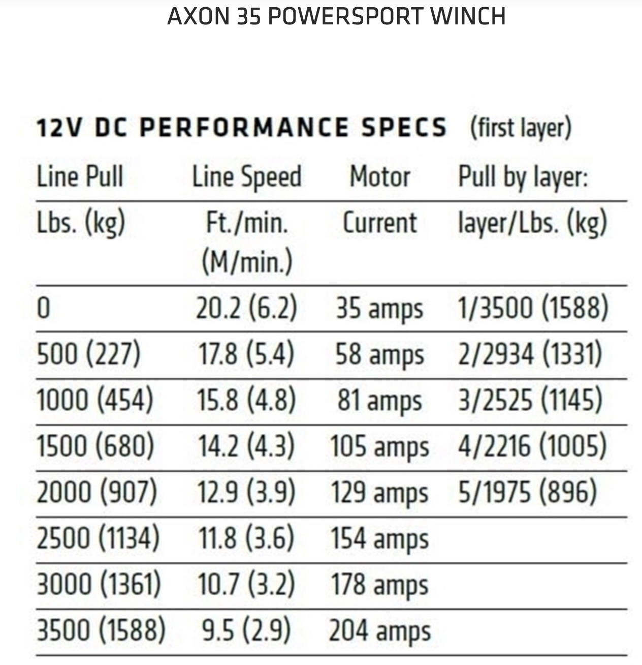

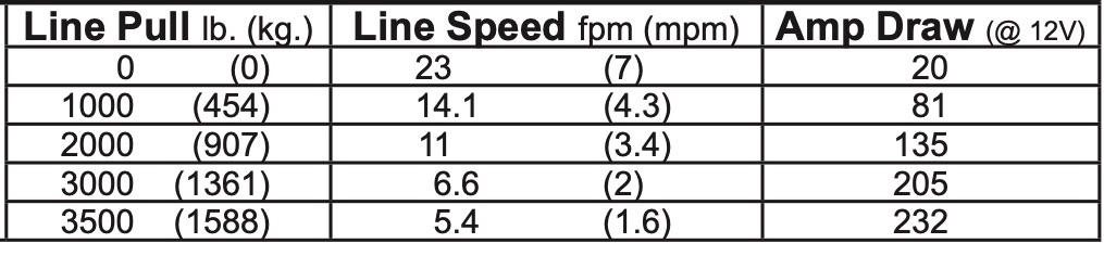

There is a difference, but even a quality winch FAR outstrips the capacity of a typical ATV alternator. Here are two tables pulled from the manuals of a cheap Harbor Freight Winch and a Warn Winch. Same pull rating, but different speeds under load.
HF Badlands 3500# Winch first layer line pull
Warn Axon 3.5 Winch
Yes, the Warn winch draw fewer amps and does so while pulling at a higher speed, but they still draw a LOT of amps, even for a small winch like this. In some cases, it's enough to permanently damage a small ATV battery. Keep your engine revs up, and pull in short bursts, allowing time for both the winch and the battery to cool.

Oh yeah, make no mistake, I am not saying an ATV will survive with hard use of any winch, regardless of brand. Maybe someone with an ATV can tell us what their charging amps are?
