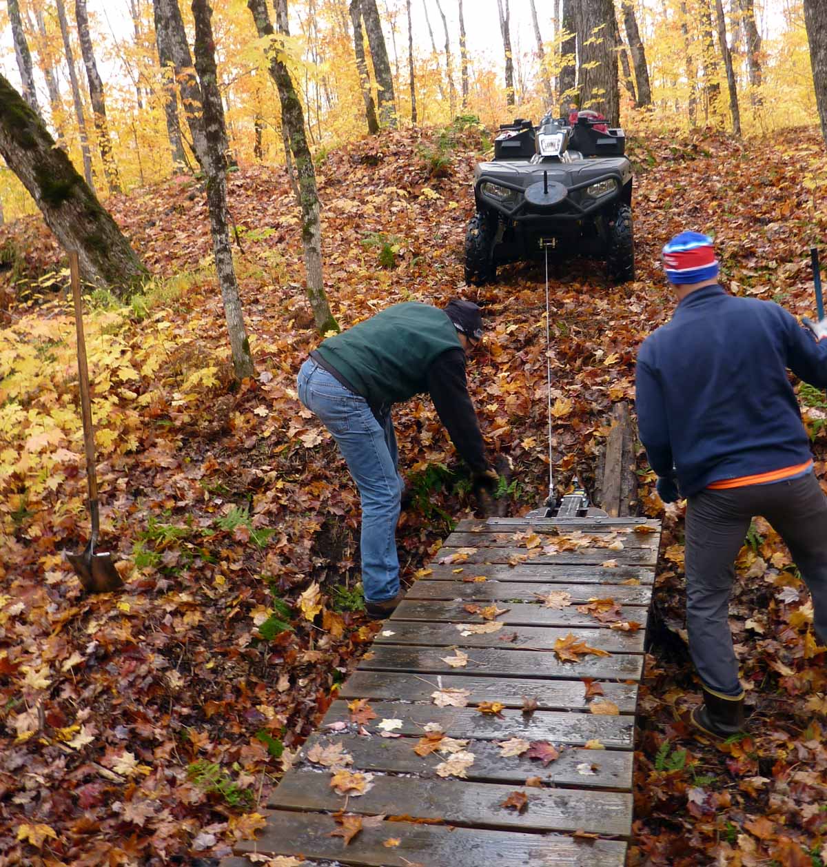

I'll have to differ with that assessment. If you keep your engine running and know they are your batteries nemeses, they are still great asset to have along. .
