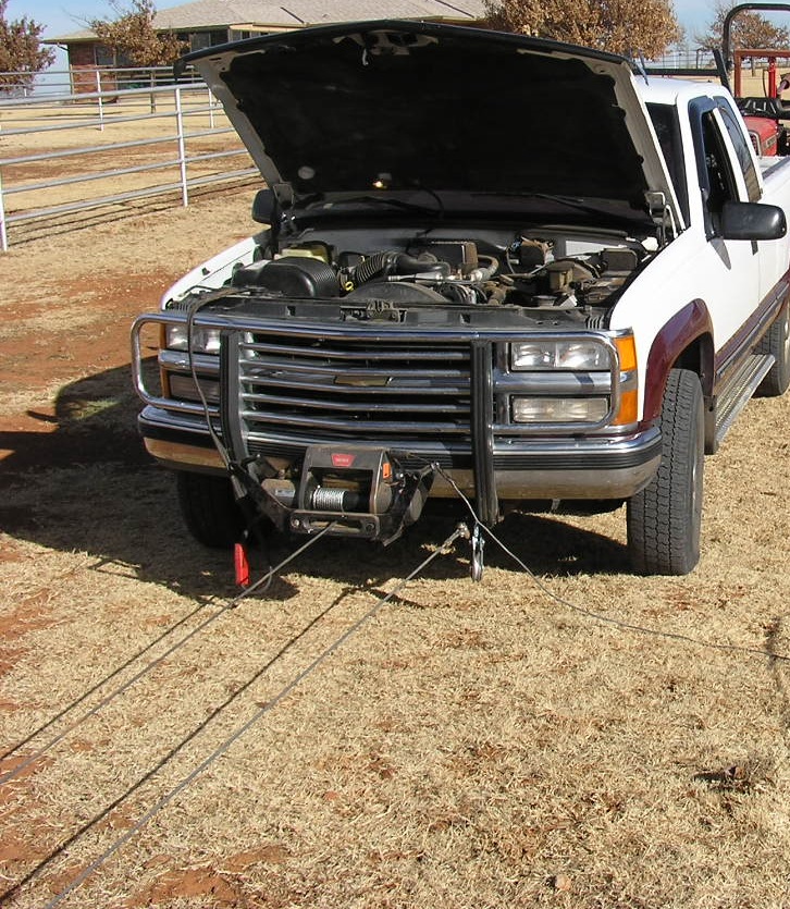

I have a 9k# winch on front of my Jeep GC in a custom bumper and seldom use it. But when I need it- I need it. It has been used for things like supporting an old shed upright so it could be repaired to recently winching a friend's Ford tractor out of the mud at the bottom of a long hillside where it had been stuck for a couple weeks and it took all of the single line pull the winch could muster. Also have a 12k# winch that used to be on the back of my tractor and used to pull trees leaning in the wrong direction that I was cutting down to clear the property for my new home, now residing on the front bumper of my 2015 Dodge 2500 Diesel (barely adequate size winch).
Years ago I started out using a 2" receiver mounted, portable unit on the front or rear, but there are major limitations to that setup, especially if needed often and the mounted vehicle is mired.
+1 on the Anderson type connectors as I have them on all of my vehicle batteries, 1 gauge and 2 gauge battery jumper cables, winches, inverters, etc.
If another vehicle is available to tug one out of the mess, a snatch rope can be a quicker and easier method. A snatch strap is a less expensive, less effective option.
Here is what I also carry in each vehicle (unused so far), along with 30' snatch strap, 26.4k# bridle, synthetic or wire rope winch cable extensions, 6.5T and 8.5T steel bow shackles, etc., etc.:
- Truck: 1 1/4 Inch High Strength Synthetic Kinetic Recovery Rope | ASR Offroad
- Jeep: 7/8 Inch Synthetic Recovery Vehicle Recovery Rope | ASR Offroad
