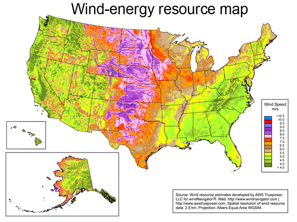

<img src="http://www.tractorbynet.com/forums/attachment.php?attachmentid=387368"/>
Actually it is a decent area, I am right next to lake Erie and we get a lot of wind here. The payback rate is based off our current and expected average utility price. Current price we pay is 12.65 cents/kWh with 20 year projected average of 20.24 cents/kWh. But this is the type discussion I am looking for.

remember salesmen are professional at telling only the positive and forgetting the negative. Now about the map, the colors is purple the best or the worst?
