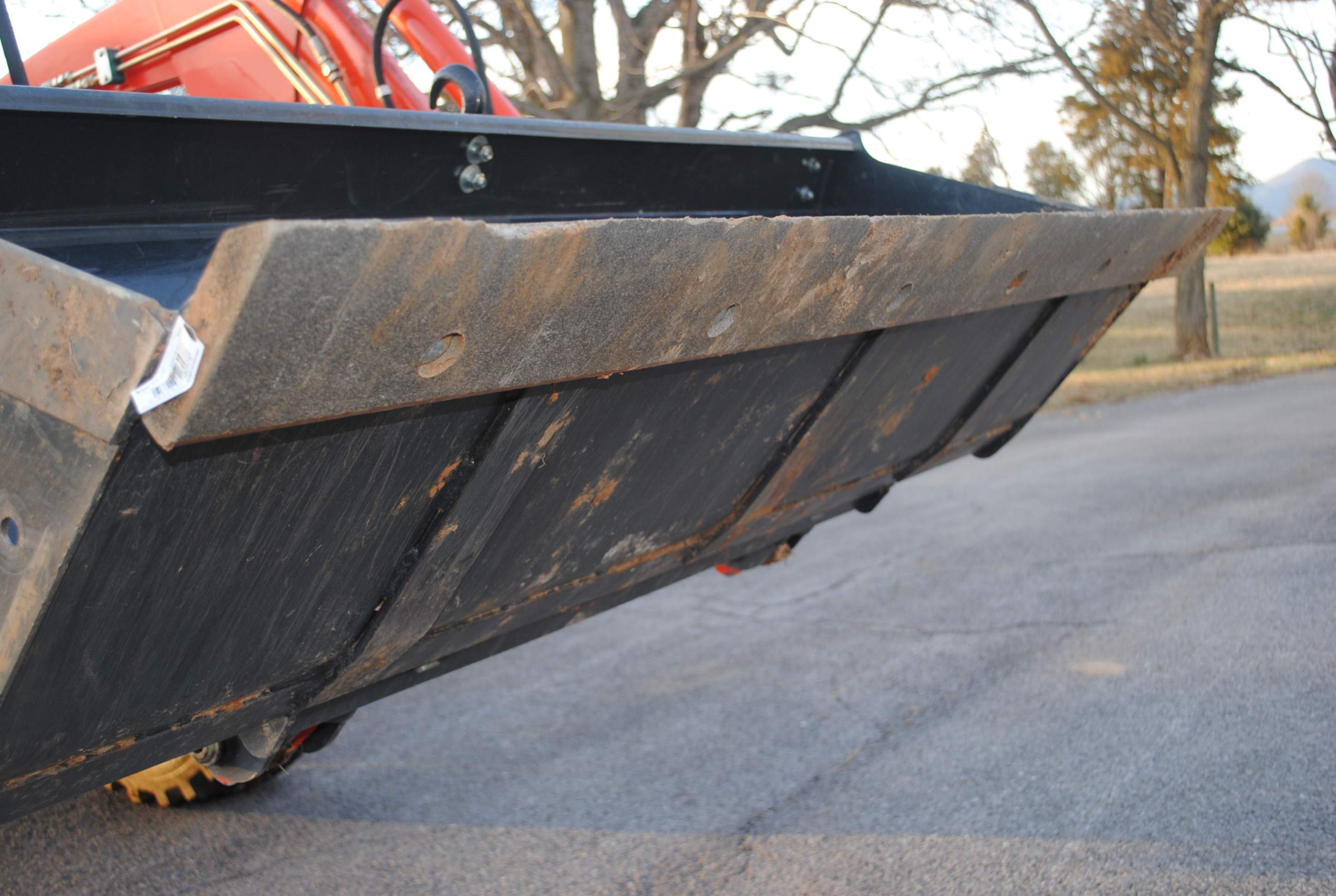

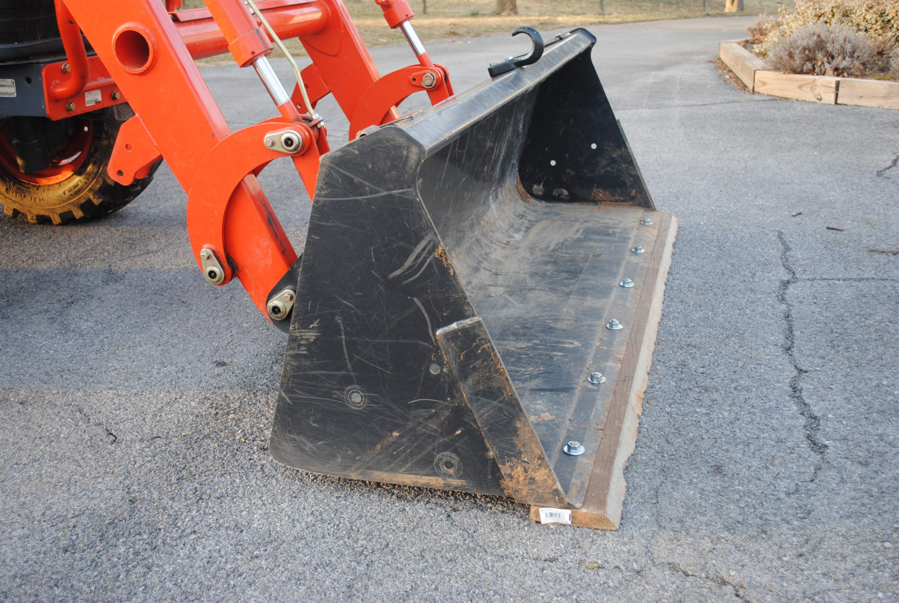

I use a length of 2X6 trex or composite flooring. Do an angle cut across the length of the board and drill holes to match the holes in the bucket. Then countersink the holes on the bottom side and attach to bucket with deck bolts. The composite lumber does not damage my asphalt driveway. Easy and cheap to make another one when chewed up.
